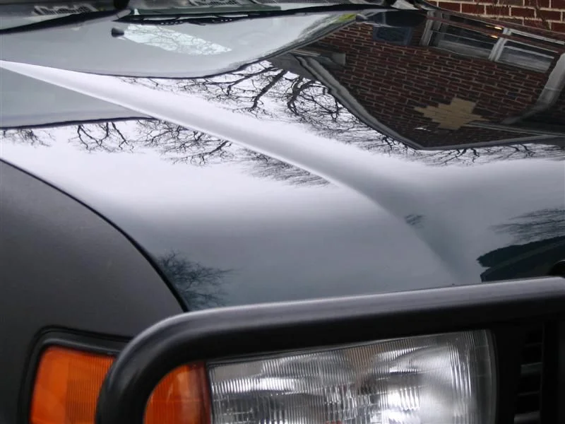

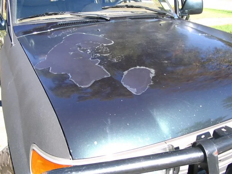

i know for sure the green likes to fail. Here's a before and after pic.

You are asking a tough question. I would bet money that the hood in post 15 is not the factory paint job. I had a dark green one for a couple months that was very rough and had been outside for years but didn't show any paint failure. I also owned a dark green nissan pathfinder and dark green nissan truck. Both had never been inside a garage for over 10 years. The only place the paint failed on either of these two rigs was where the truck was repainted after a fender bender. Looked just like the hood pictured in #15 after 5 years.
I think most clear coat issues are re-paints other than some american rigs i have seen.
