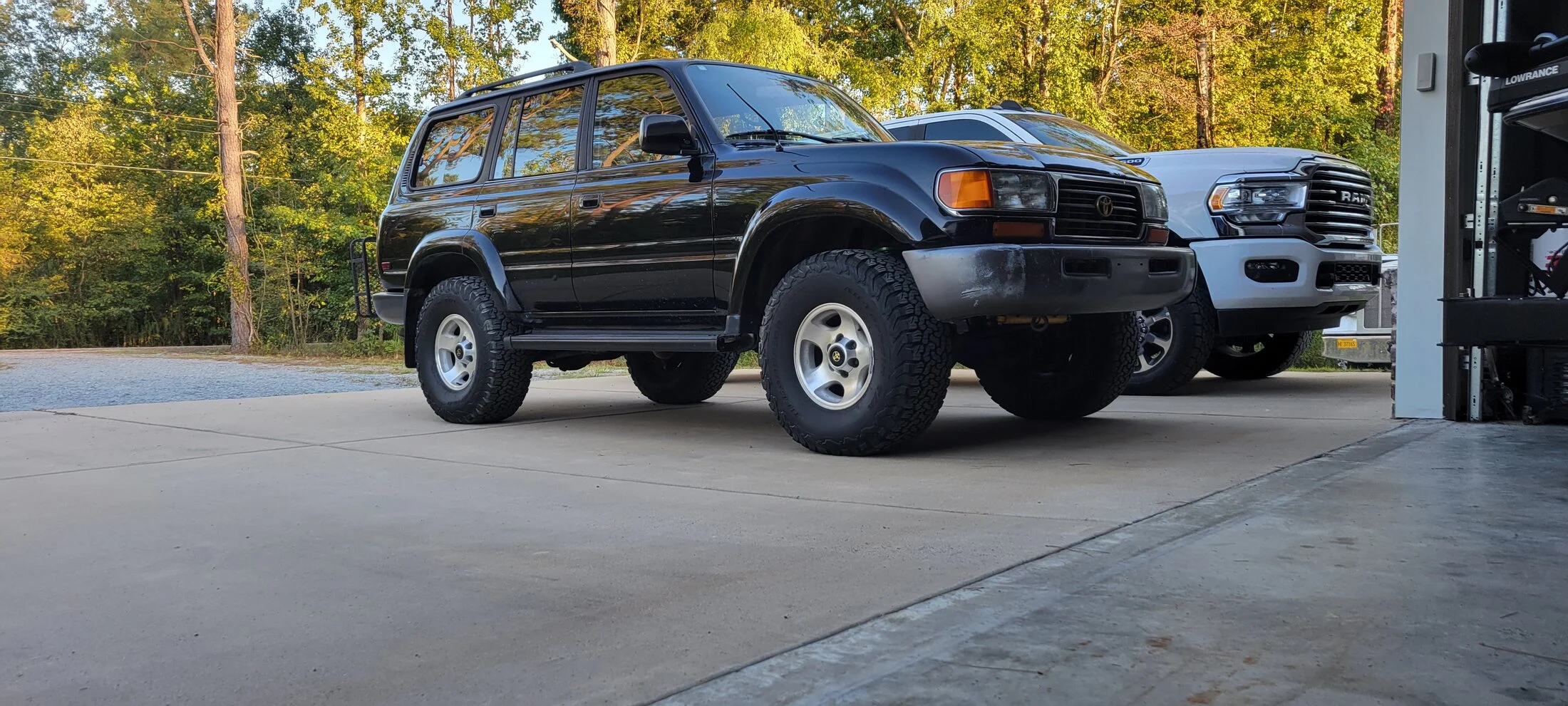

New member and 1st post so go easy on me. I recently sold my 100 series and got this 80 in its place. It's a 3x locked 97 model. From research on others posts I've concluded it has a 2" OME medium suspension. It has 1" spacers on the front and still "sags" down in the front. It also rides comparable to a log wagon. I don't think the poor ride is the fault of the springs as much as the shocks so my thoughts (before yalls input) is to change the front springs (in order to lose the spacers) and replace all 4 shocks. My question is what springs and shocks are going to yield me a good ride on the road and still be capable offload.
Primarily it's driven on the road but I do the occasional off-road. The offroading it sees is primarily gravel trail (national forest type). Not exactly good enough to be called a gravel road but not bad enough to be considered challenging terrain. I won't be doing any overlanding so other than a full spare in rear there won't be any added weight.
Years ago I built several Jeep TJ's with long arms and a huge amount of suspension travel so I am pretty decent with spring rates and understanding geometrics. The confusion I have is from all the different types and uses of these rigs determine different companies and products. What are yalls suggestions? In a nut shell, I want my cake and eat it too. Smooth on-road and capable offroad.

Suspension is very subjective but it's my opinion (and many others here) that the OME shocks can be harsh. Personally I'd swap those first (plenty of good options depending on what you want to spend) and then move on to the springs if you're so inclined. FWIW, I'm experiencing the same thing and will likely start with Dobinson, Icon or Bilstein shocks, then go from there.
If you want the whole enchilada, lots of peeps like the Dobinson kits these days or you could spend more and get an Icon kit or even step up to Slee with their super nice remote res shocks. The world is your oyster.

I've ran bilstien on lighter trucks and heavier trucks but never the midweight area the 80 is in. They rode really nice on my 3/4 diesel but not so good on my light 2wd street truck. The main reason I'd like to do front springs is to eliminate the need for the spacer and to reduce the rake (front end sag) to at least 1 inch preferably less. But you're right, the options are plenty, which is why I made the post. Trying to get a general consensus on the best riding shocks for normal use. I appreciate your input, thank you!

It was determined years ago that OME Nitro Charger shocks produce a firm, if not harsh, ride. Why not swap out all 4 shocks for now and go from from there?
