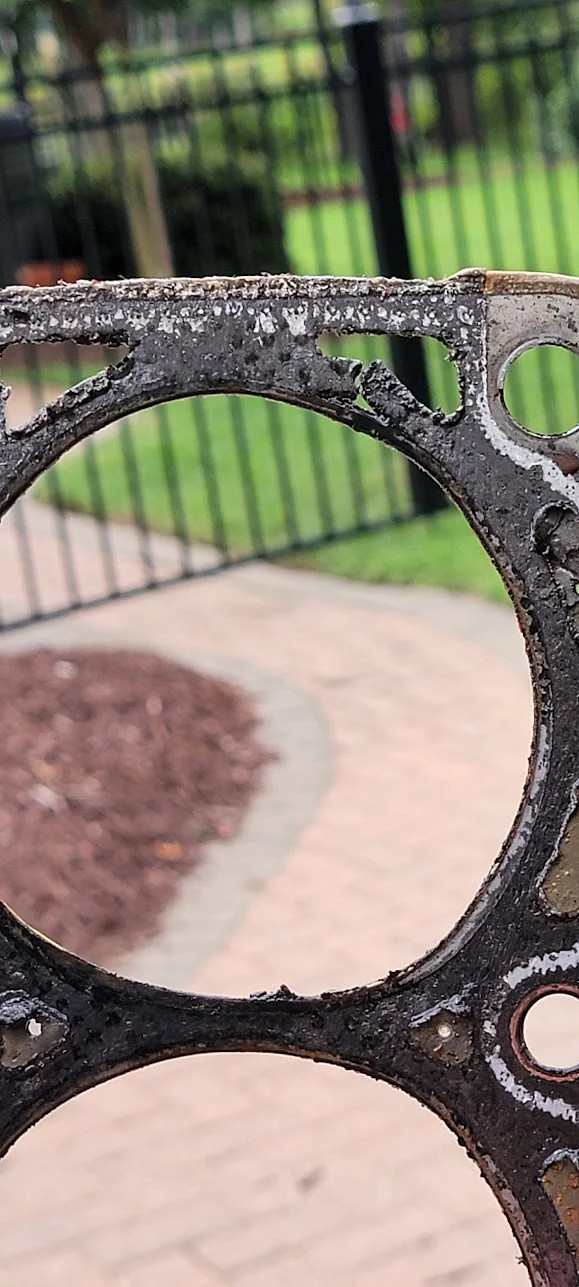

I had a P0306 as well and the truck was running rough. Mine was due to this:
