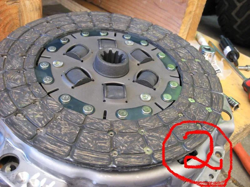

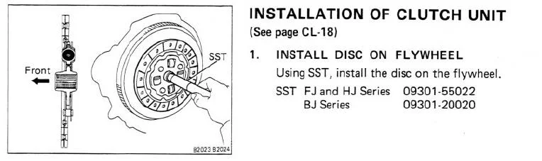

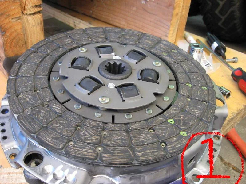

I have used my clutch for 100k kilometers and waiting to replace but no sign it is going , anyway I have read that the clutch orientation in the manual can be wrong so remove and check/picture it?, the nipple! always
But seems different model in pictures below? Just check.
wrong
correct
That pic above is not correct for the 2F (it may be for H engine, dunno).
For the 2F the 'SNOUT' (#2) on the clutch disc must face the engine. Ask me how I know!
Otherwise, when you depress the clutch, the disc will not release against the flywheel.
