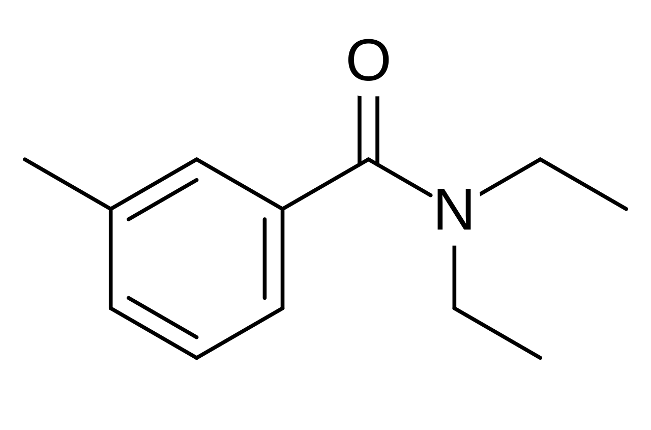

I went below and used a ratcheting wrench in the two bolts holding the release cylinder to the transmission. The first broke quickly, the second was weirdly, eerily slow. I panicked. I soaked it in more oil and checked that I was not rounding the threads. I turned slowly, then the bolt broke free, but only 20% of the bolt came out. The other 80% is still in there. 💩
My two first challenges are finding a replacement clutch hose and secondly extracting that broken bolt. I was thinking of drilling it out. Space is tight. Maybe heat it? Soak it in oil? Use extractor bolts? I’ve never extracted a bolt before so I am in the dark on that.

Best bet is drill the center. Use a tiny bit. It's easier to get the hole centered and walks less than a larger one. Then start enlarging the hole incrementally. If you see aluminum shaving coming out, you are angled in there.
Use as little force as possible with a high quality EZ out. Don't use a cheap one, you might live to regret it. That's another story entirely if you break a piece of tool steel off in that hole. I have lived that nightmare in a closed bottom hole. That get's into trying to freeze the broken tap and get it to shatter.

I use a “center drill” bit when trying to extract broken bolts.
Start with a center punch or prick punch to make a dent close to the bolts center.
Center drill won’t bend or flex.
From the picture it looks like you have a little bit of the bolt shank proud of the tapped hole, if thats the case i would find a nut that closely fits over the exposed shank and either mig or tig weld the two together and try unscrewing it. Generally the heat from welding loosens the stubborn bolt and they come out relatively easy.
I agree.....
This would be the quickest and easiest procedure for removing the broken bolt.
