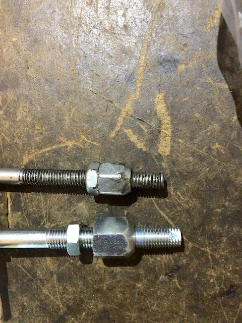

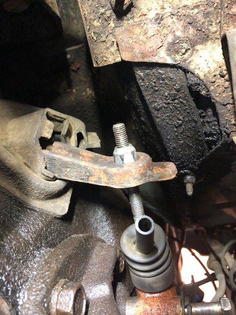

Well, problem solved. I was looking up from under the truck, unbolting the slave cylinder, and I said to myself, "That doesn't look right." The conical nut that serves to adjust the rod length had passed through the hole in the clutch fork. At first I thought that the hole had rusted and given way, but it turns out that the conical nut on the NAPA slave cylinder is considerably smaller than factory and had just pushed through.
That'll do it. Jack was spot on with his foot feel. It popped through and that's when he lost clutch throw
