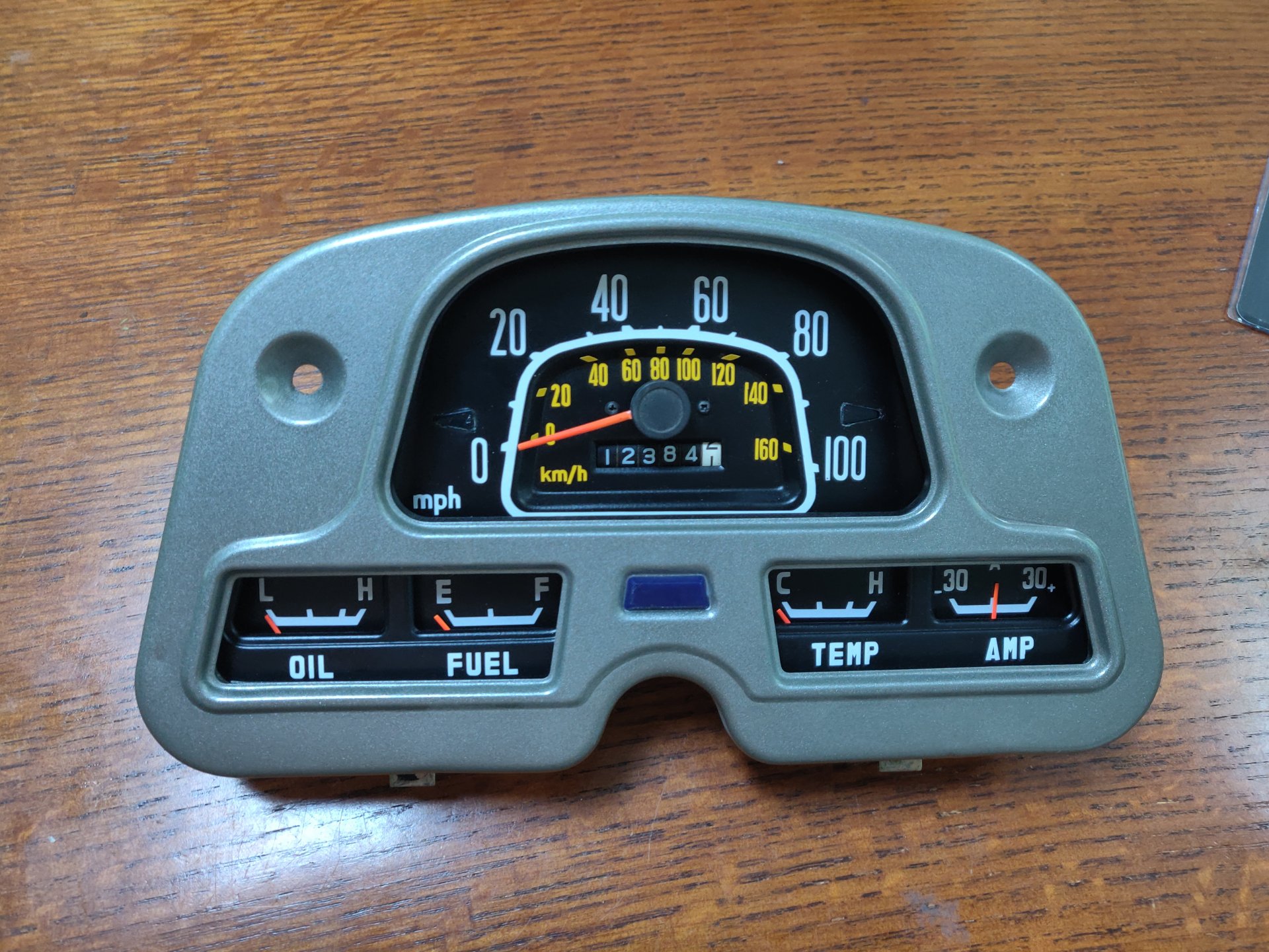

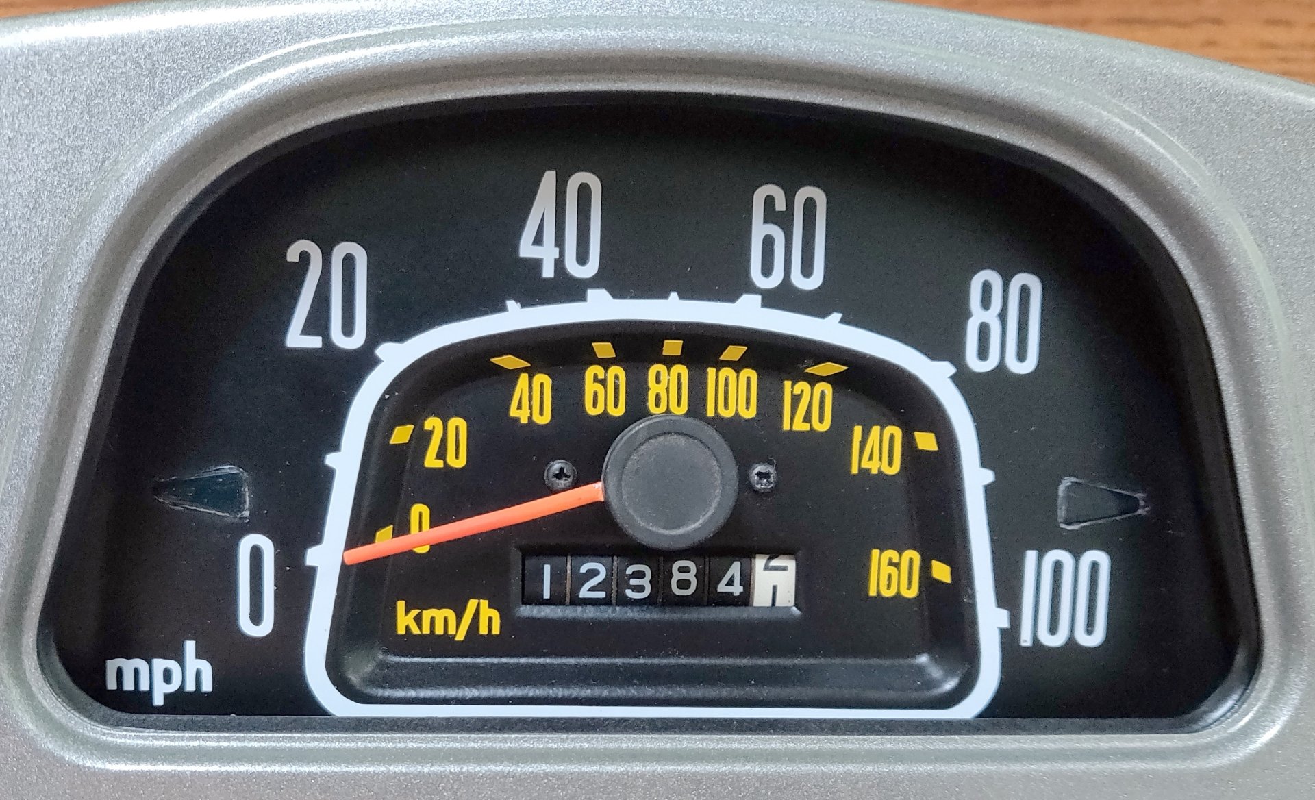

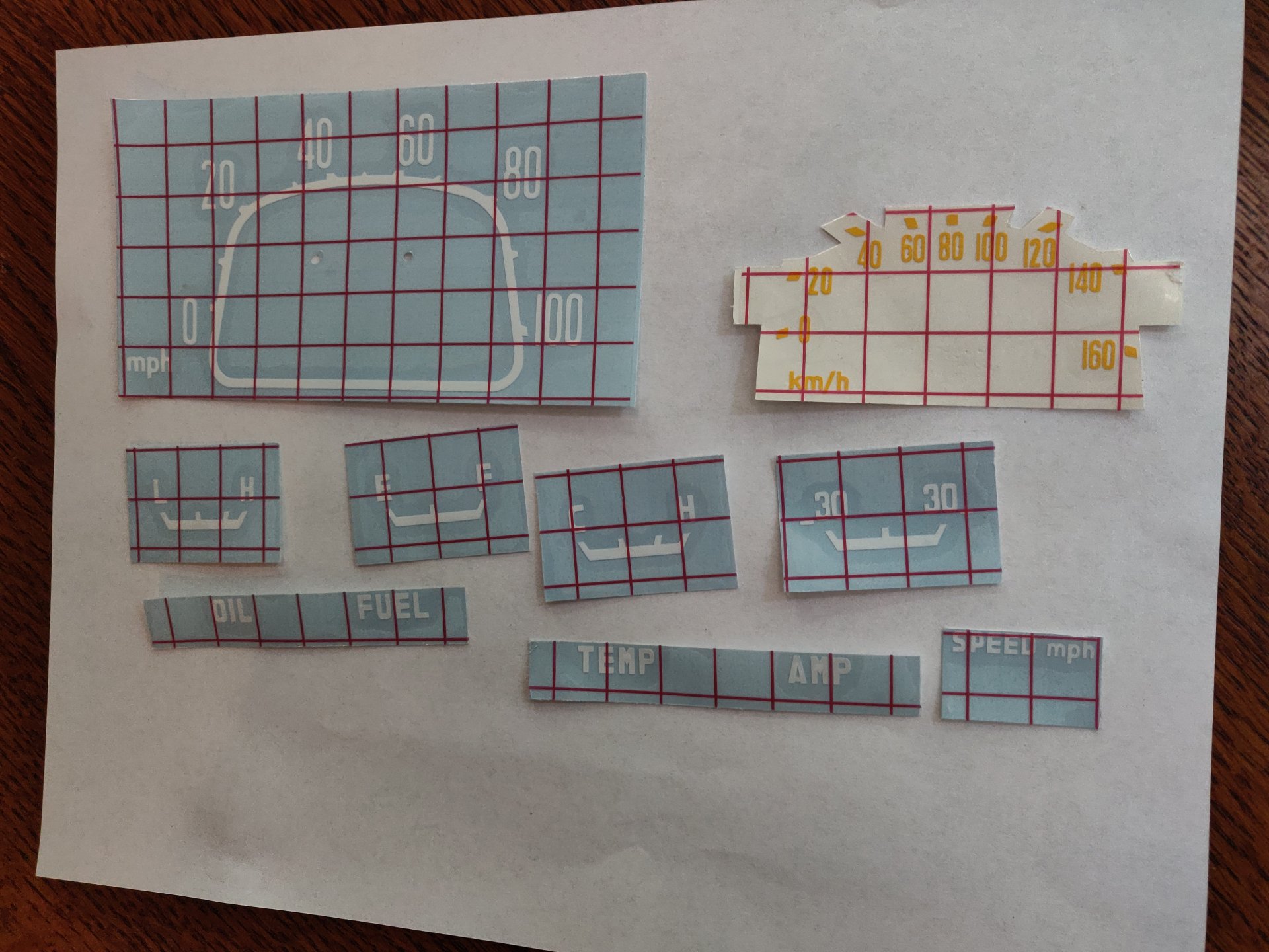

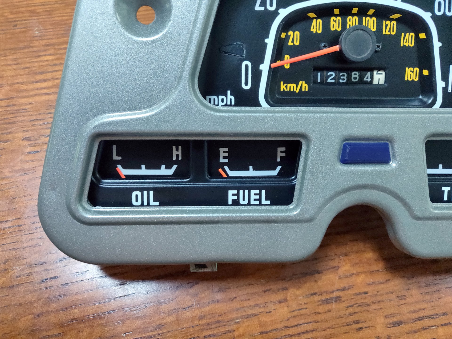

Funny you ask this I created these for some clusters that I am restoring. These use the same vinyl that the old gaugemarks company use. I have listed them on Ebay to see if anyone is interested in using them.

Funny you ask this I created these for some clusters that I am restoring. These use the same vinyl that the old gaugemarks company use. I have listed them on Ebay to see if anyone is interested in using them.View attachment 3039584View attachment 3039585View attachment 3039586View attachment 3039587

There was very little interest on ebay and each version is a huge investment of time. And it is not worth the effort to only sell 7 or 8 kits.
