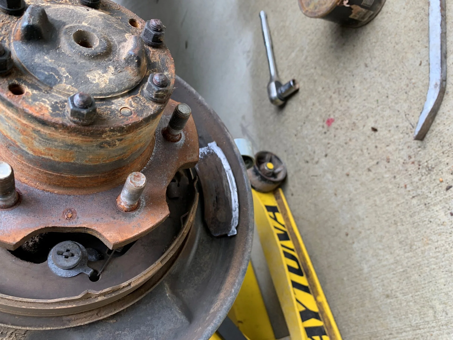

MYSTERY SOLVED, but this is an odd one, so I'm not sure if it will be something that will help out other Mudders. I started going through the list compiled by you fine folks and was checking everything, but still not finding the source of the noise. Then I started to expand my search and started banging on everything (mostly out of frustration). I always felt like the noise was coming from the right rear so I started banging on the right rear caliper, rotor, and dust shield - and bingo I found it. My initial thought before I tore into it was that one of the springs for the emergency brake shoes must have broken and allowed the shoes to flop around inside the rotor, however, it was even dumber than that. The previous owner had allowed an old brake pad to slip between the back of the rear right rotor and the dust shield, and never bothered to get it out. How lazy is that? The caliper had both brakes pads, so this must have happened in a previous brake change. Maybe they didn't see that it fell out of the caliper, maybe they saw it and assumed that it would fall out on it's own (stupid and dangerous), maybe they didn't want to take the caliper bracket and rotor off, or maybe they just didn't care? In all fairness, maybe I should have called this a "clank" rather than a "clunk", but can anybody honestly say that they would have said "check to see if the PO left a brake pad between the rotor and the dust shield" hahaha. All the advice was still good advice though: I still plan to replace the rear bushings to the front radius arms (at the frame) since I already replaced the front 2 at the axle with castor correction bushings, and I still plan to replace the rear panhard bar bushings once I get the Delta panhard lift bracket. THANK YOU ALL
