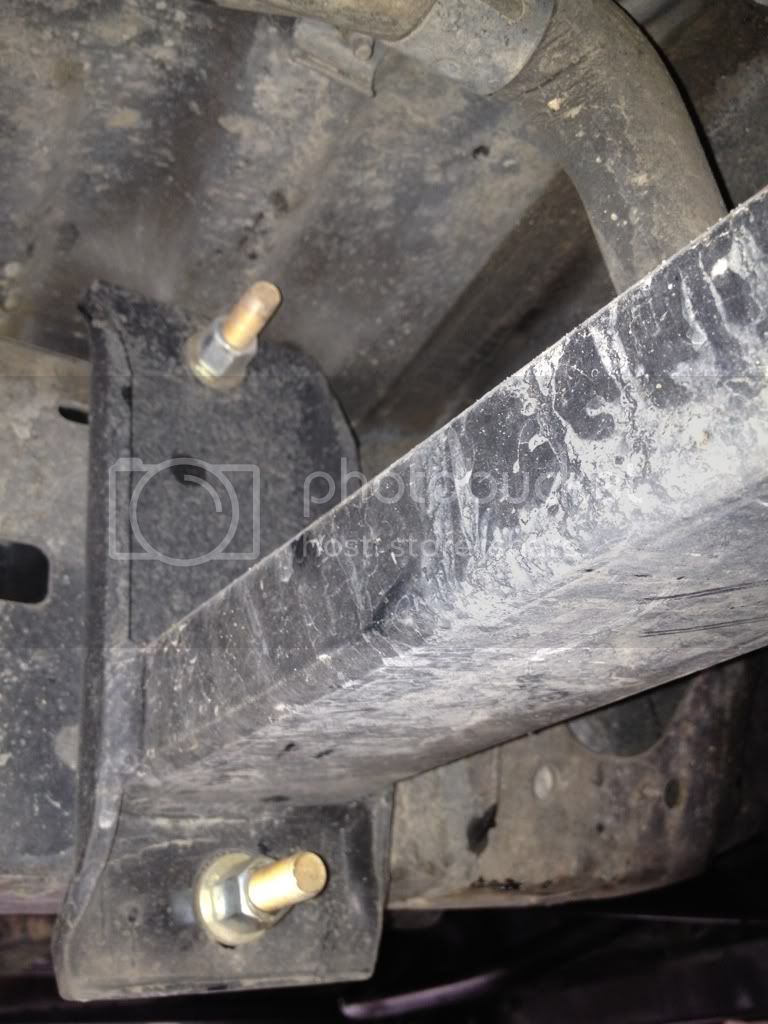

Here is a pic of the mount, its the front bracket right under the PS floorboard. The drivers side looks the same.

Looking at the picture, I may have to revise my thought re the slider. If there was any significant contact, there would be some wear marks on the slider mount / body pan. Any chance the winch hook is making this clunk?

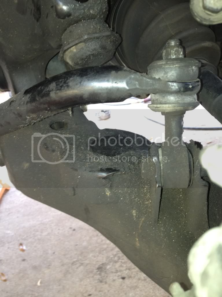

This weekend I installed four new Ironman shocks and 4 of the 6 bushings on the front sway bar. While installing the front passenger side I noticed, from the old cv grease being wiped clean, that the sway bar had been hitting the lower control arm, I think this is where the muffled clunk was coming from. My guess is that the shocks were so shot that there was just nothing left to absorb the bumps. Here is a pic with the new bushings installed just before I wiped all the old grease away.
No more muffled clunk! I still need to install the two inner sway bar bushings but that will require the removal of the torsion bars and a bit of work because the bolts that hold the bracket on are way rusted from the A/C condenser dripping on them for 12 years.

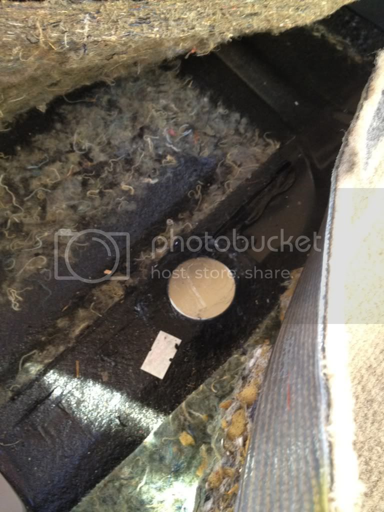

While I was in there I replaced my rear brakes and shocks, the brakes were easy, the shocks not so much. I busted my keister trying to remove the rear shocks without drilling a hole....that didnt happen.
I drilled out 2, 1 1/4" holes, one over each top bolt and that made the job doable. I so didnt want to do it but afterwards I realized that it was really to only way the job was going to get done. To cover the holes I picked up some 1 1/4" metal covers and siliconed them into place making sure to cover the underside of the holes to avoid rust.
Finished Product:
