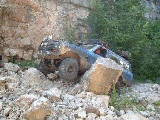

I run 2.5" lift springs and 2" over regular shackles and 35" MTR on 8x15 rims. I will rub a little on the front left if going downhill and I bounce into a hole. Never rubs on the right side. I attribute this to my fat ass. The back end tucks up in there just fine. I will rub a bit on the inside of the wheel wells when twisted up. A 1" body lift will fix most of this. I did trim the front of my fenders on the bottom under the headlights. Took off about 2" or so.
Oh yeah '88 FJ 62
You can see the trim in this PIC
