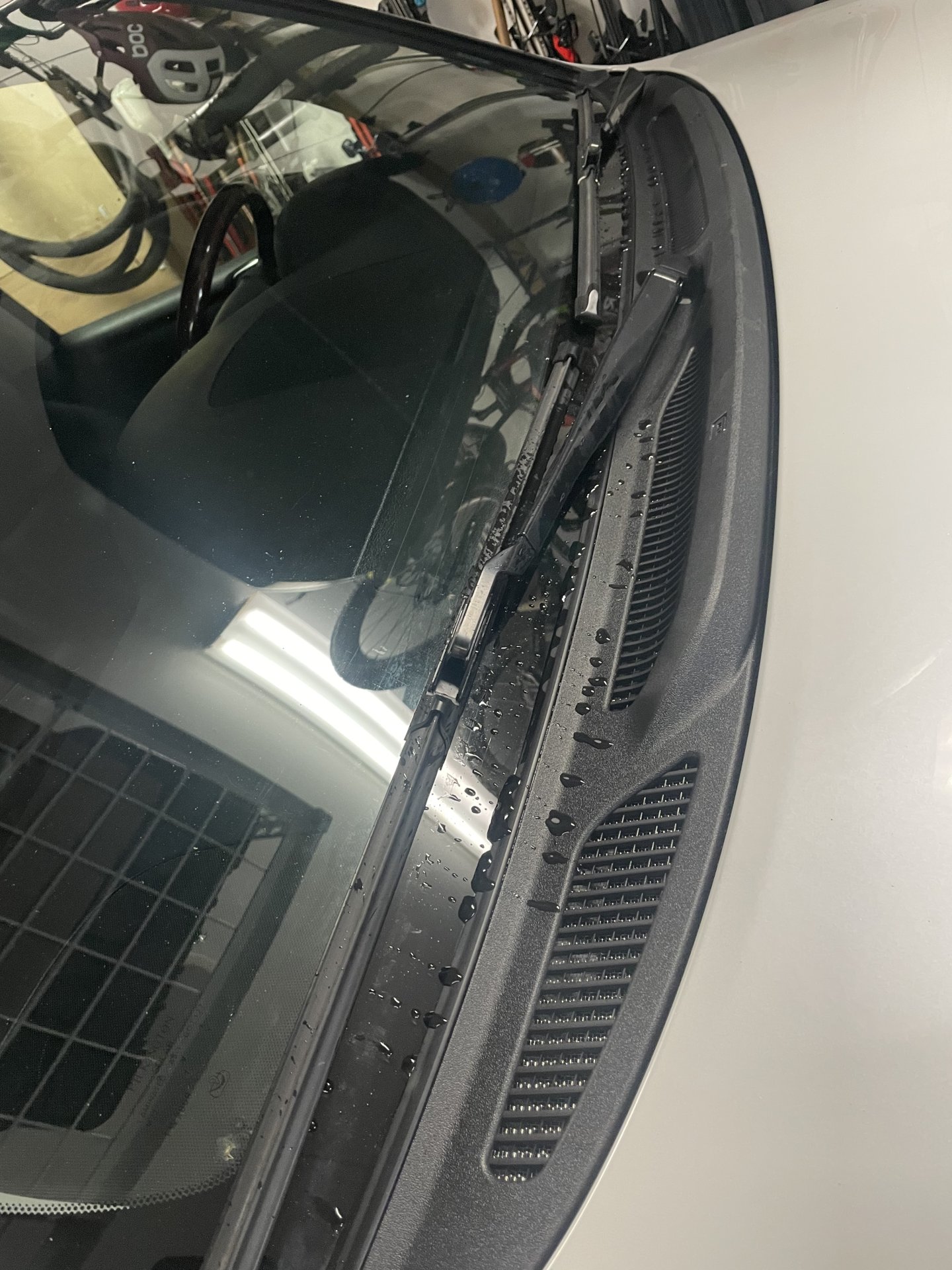

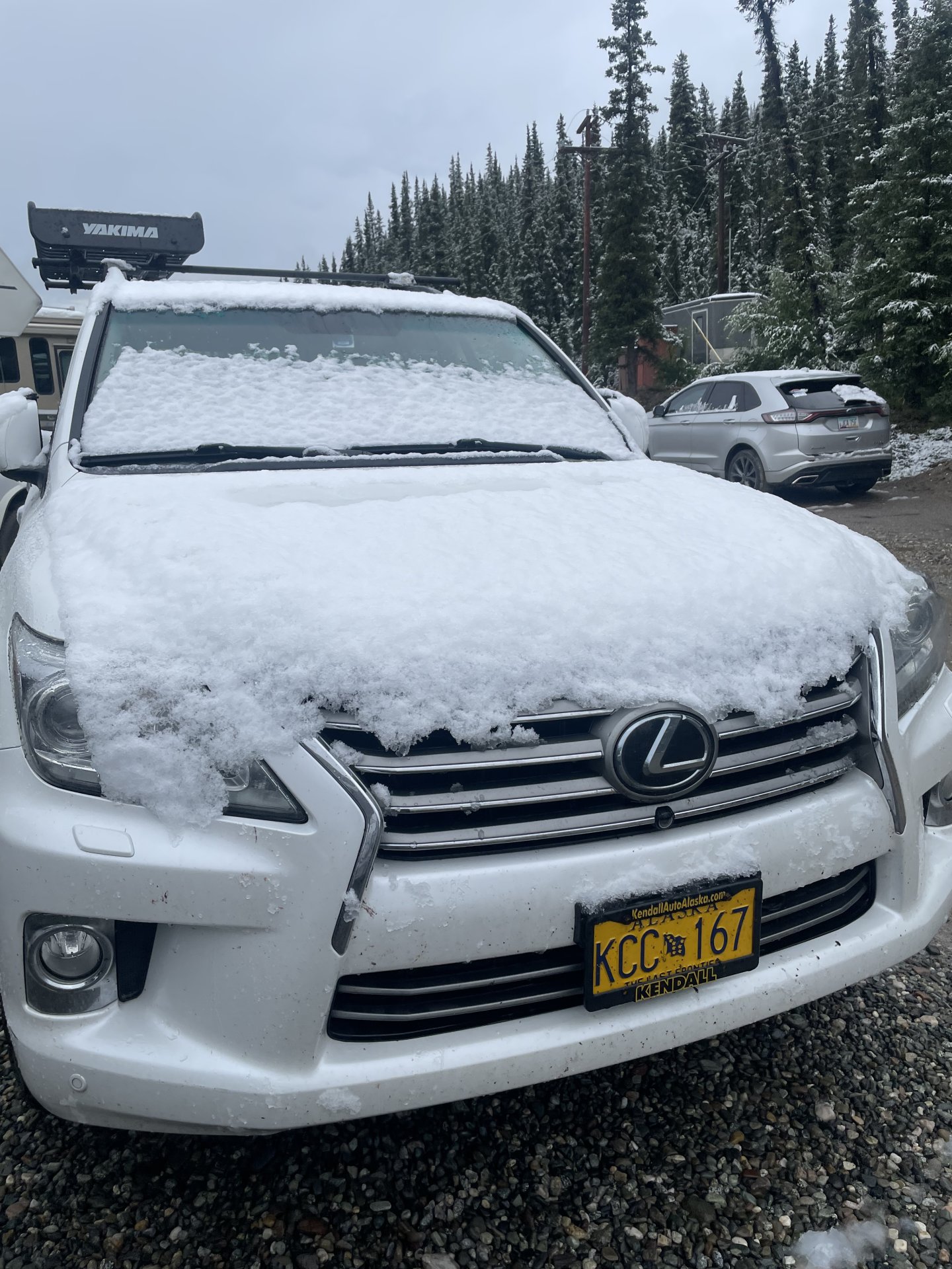

So we had 3-4” of wet heavy snow last night and I’m having climate control gremlins now…. I can hear the fan running but no air is coming out of any of the vents. Figured out that I’m having the front cowl leak again…. Took out the glove box filter and it is soaked and there is water on the passenger floor.
Any ideas?

The snow was unexpected. Prior to 2 weeks ago we were having an pretty good summer, highs in the 60’s and no rain. Last 2-3 weeks been more like 40’s and 50’s and rain most days. Snow line was predicted to be at 2000’ and I’m at ~1500’.

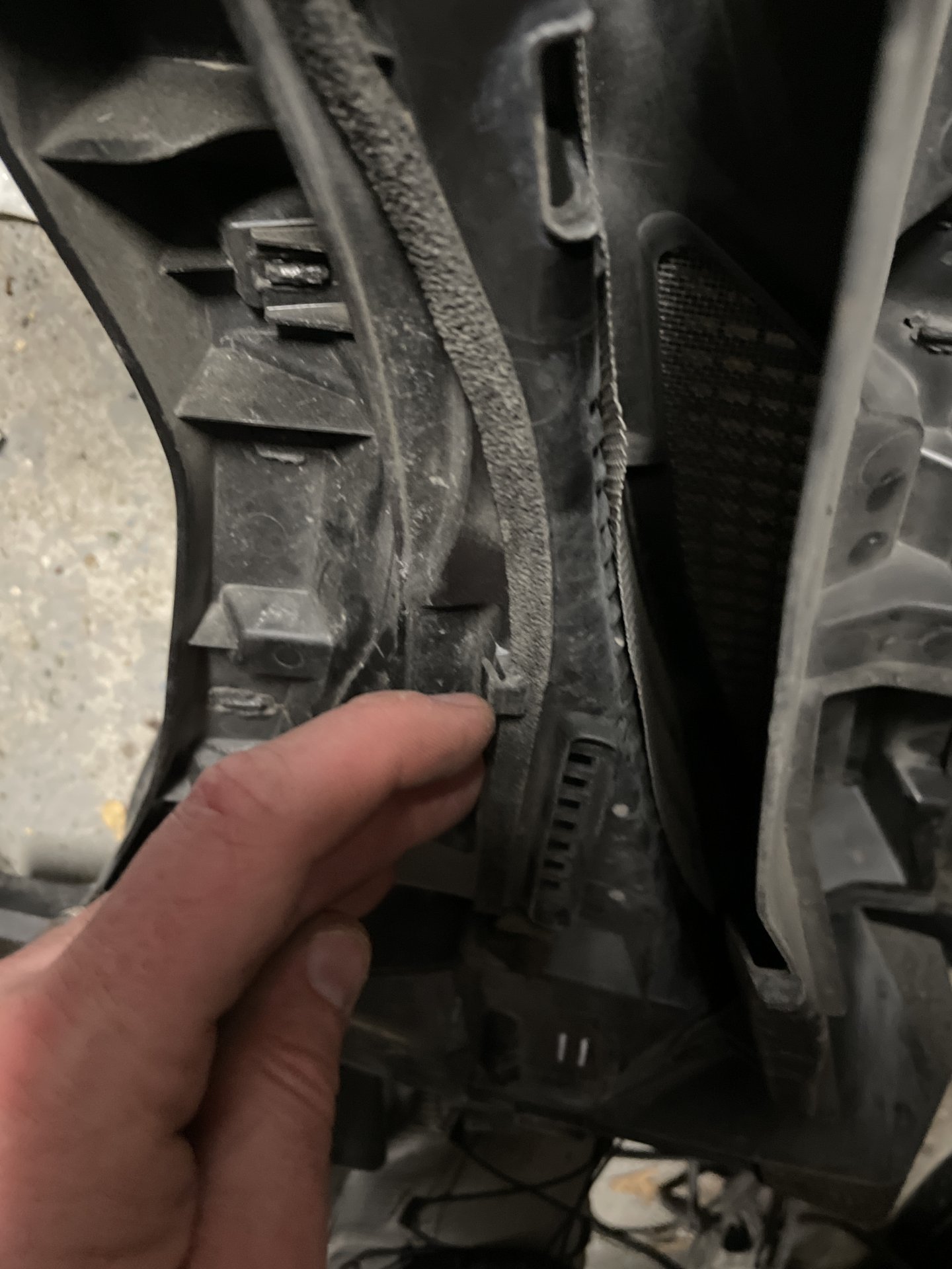

update for the good of the group. Cowl leak again…. Replaced with a new one… again. For those of you that ever remove it the small tabs that hold it in place are almost impossible to not brake when you remove it. Once they are broken you have to replace the entire cowl. Next time I need a windshield (on my 3rd) I’m going to remove and reinstall the cowl myself.
These tabs I’m referring to and the new cowl.

What do those catch on?
The cowl slides on the bottom of the windshield those tabs then click downward in these metal slots to hold it in place. There is one in each of these 3 windows and 5 in all.
