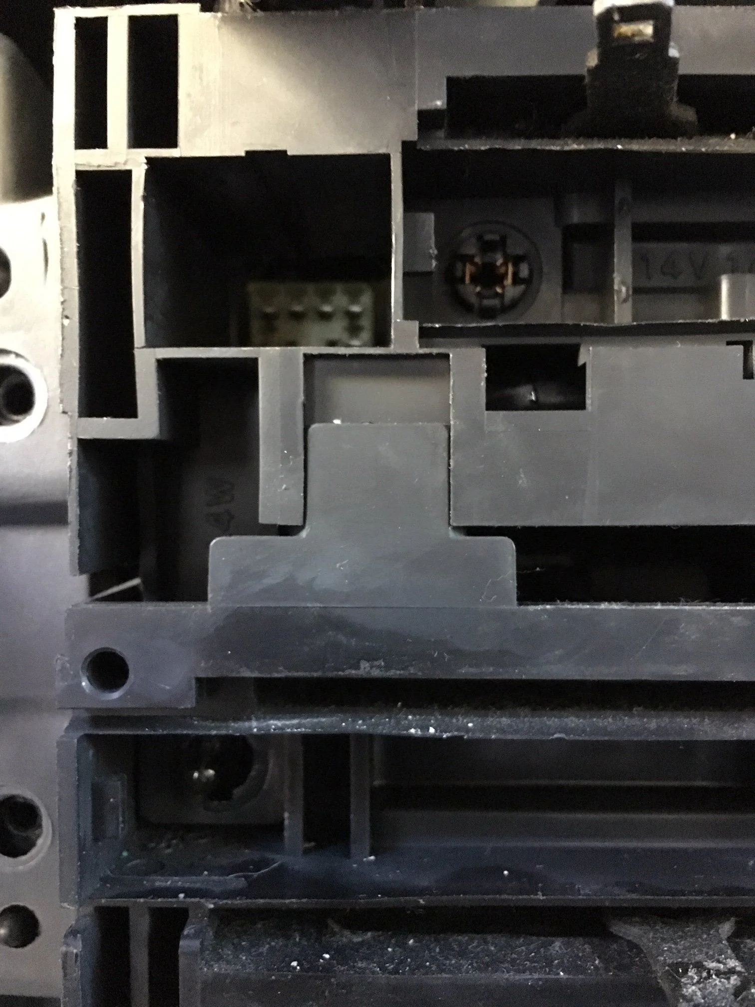

Having issues replacing the climate control bulbs in my early fj80. Two different bulbs that illuminate the lever controls. The top one pulls out, the bottom one is a twist type. Two questions (and have searched here with limited success):
  • Anybody know what type bulbs these are, and whether or not an autozone (or the like) carries them? Seems like the pull-type is a bit smaller than a type 74.
  • I have twisted the twist type, but it seems to have partially gone behind the panel where i cannot access (located on the bottom left). Should I have just pulled on it? Now that it is almost fully behind the panel, is my only option to pull the whole unit to access it? That would seem to involve pulling the entire dash, by the look of it!
Thanks for any help! Trying to post a pic, but having difficulty
Photo now attached - bulb in question is on lower left.

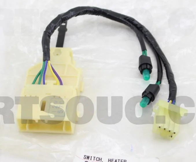

Just did my 1993 and here is what I used. Much cheaper than the dealer. You will also need three green bulb condoms if you want to keep the factory type illumination.
Local parts stores won’t have them usually.
Hi, how did you manage to replace the bulbs. Didn´t you have to take out the whole cluster or are they just plugged in from front. ??
Thanks, I thought they were soldered in the plug. I bought the fan switch and the bulbs are there on pigtails. I didn´t try to unplugg because I was going to replace the whole unit incl the fan switch. But I guess if I don´t find out how to replace the fan switch I just replace the bulbs the way you say, from front. But otherwise, would you know how to bring the whole unit to front so one could replace the fan switch ?
It´s reallyt hard to find info on it. But I suspect it´s shelled together in 2-3 parts. :) But as the fan switch is ok I will do the same as you, just replace the bulbs. :)
