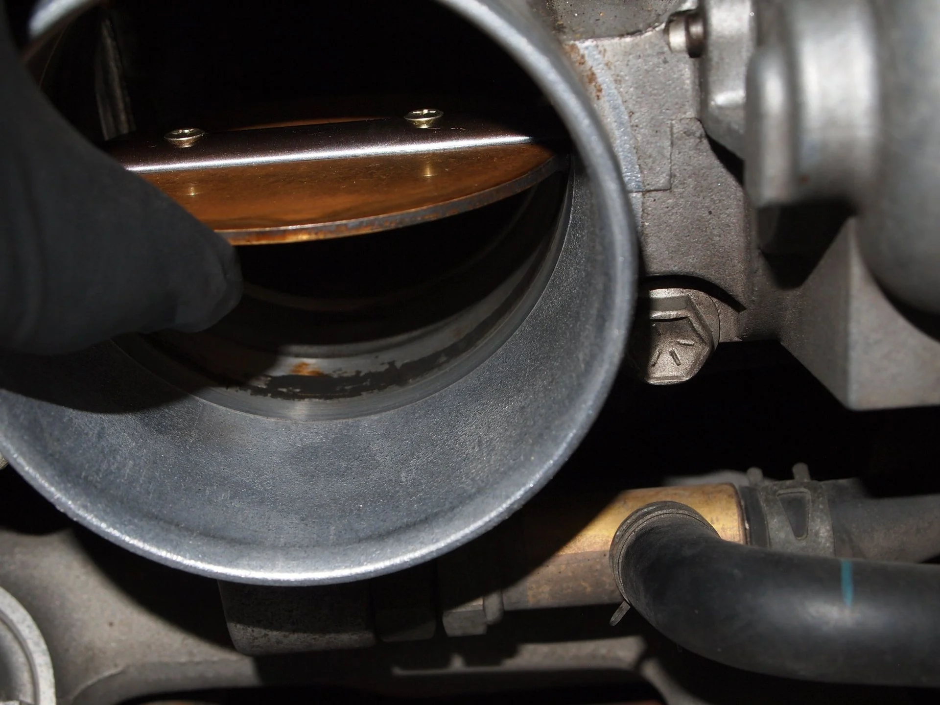

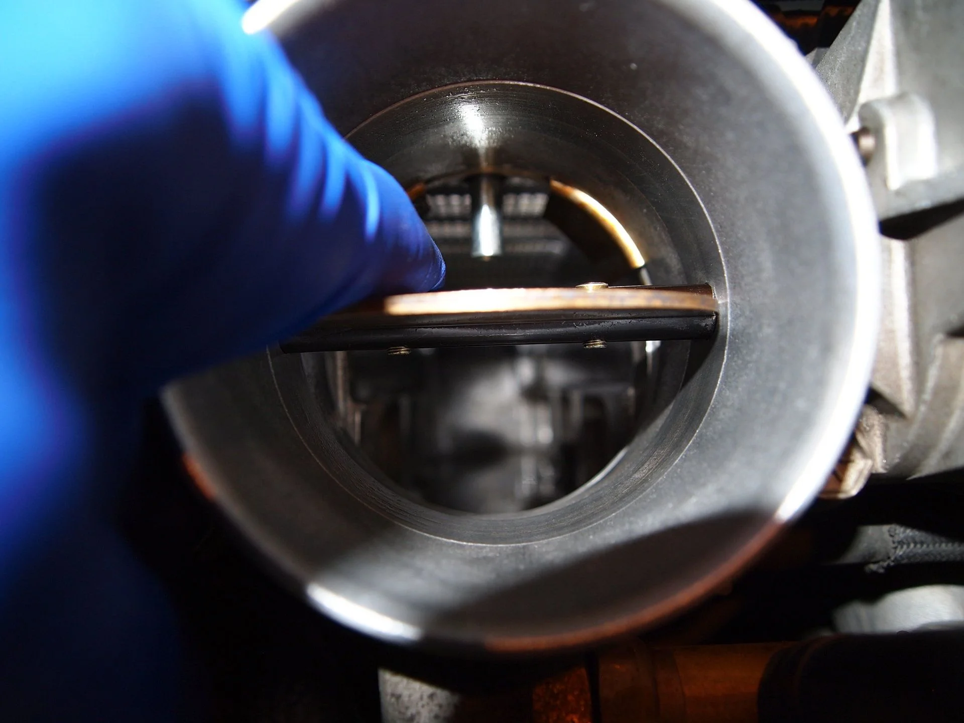

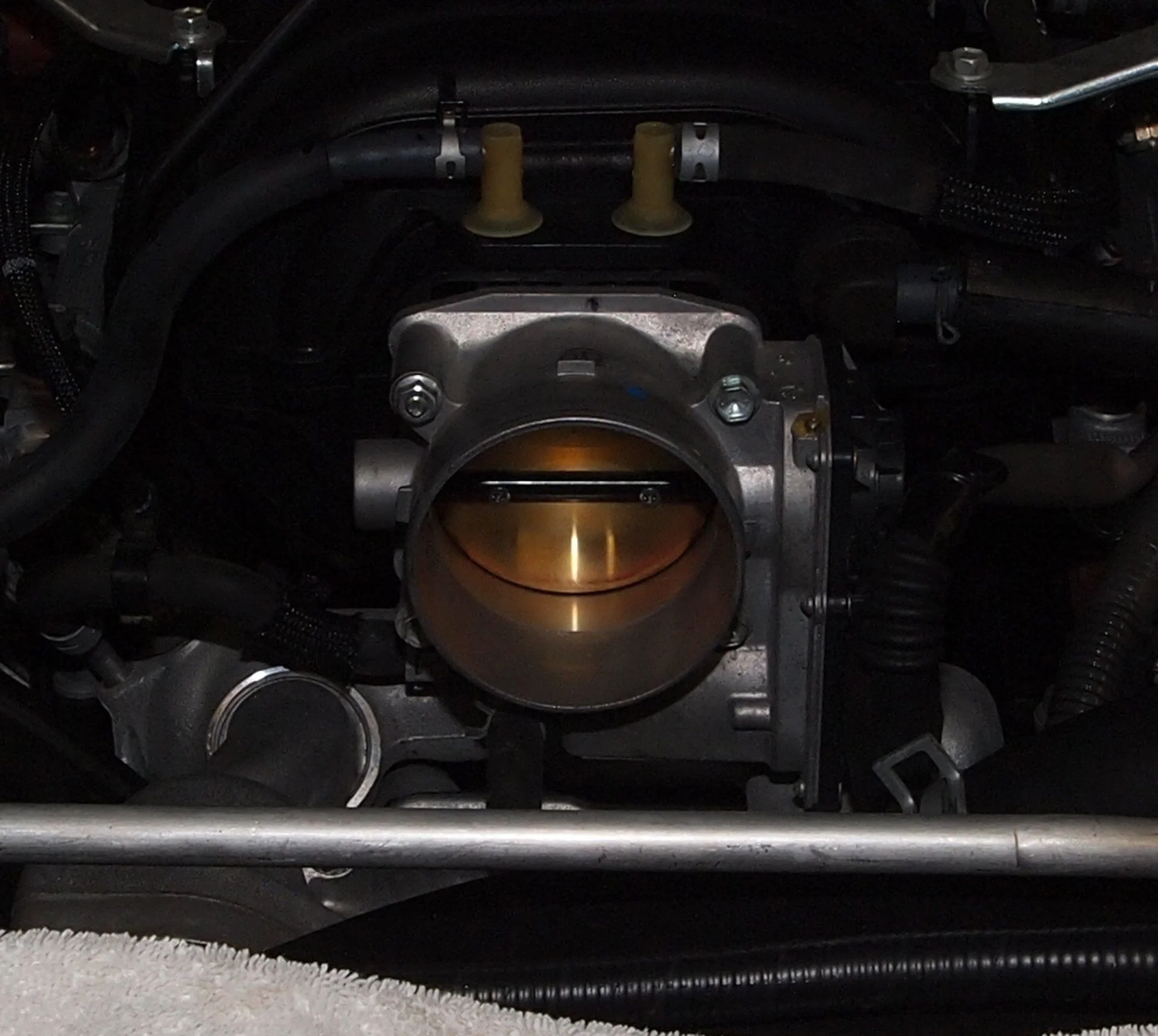

2007 Electronic

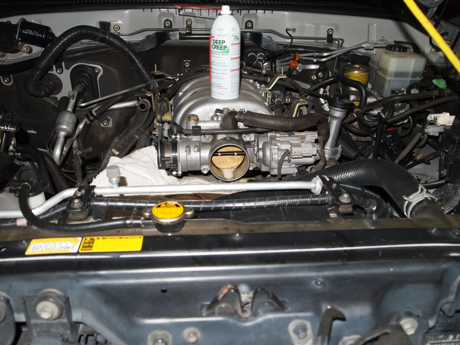

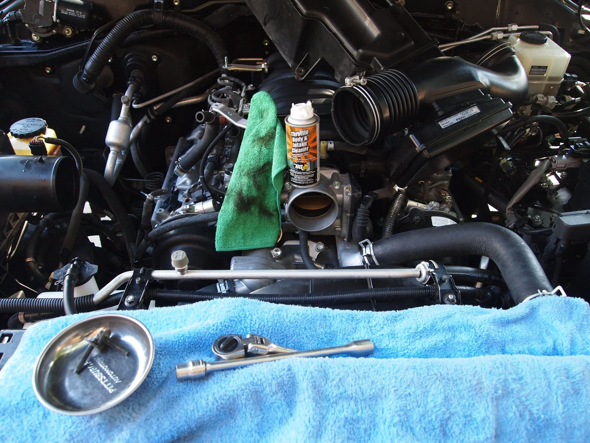

2001 cable driven throttle body

2007 Electronic
View attachment 1851758 View attachment 1851759
View attachment 1851760 View attachment 1851761 View attachment 1851762

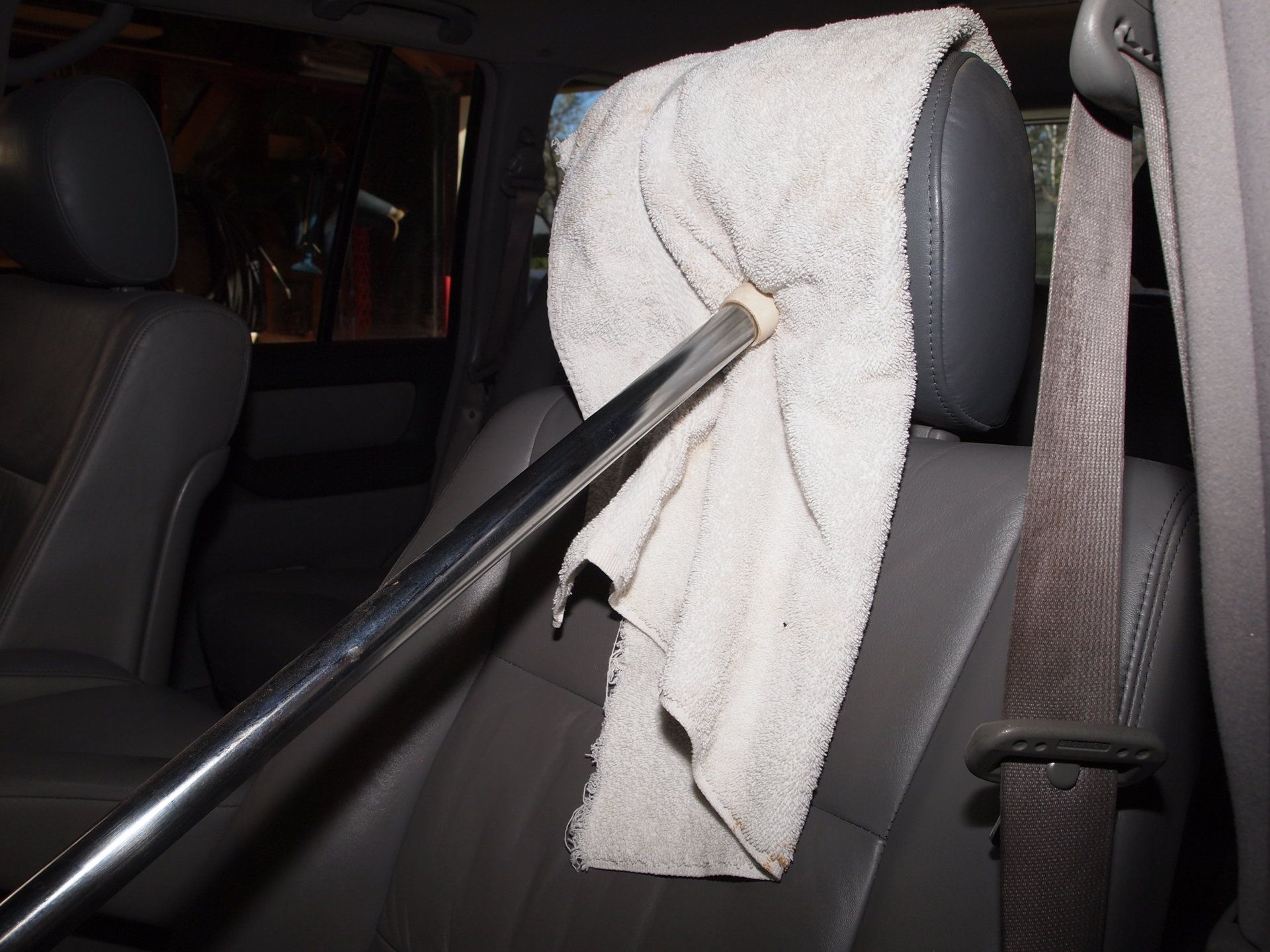

I've not "seen" stated, in the FSM or TIS training materiel, that opening the electronic throttle by hand is damaging. That said, it widely (all vehicles) believe it can damage the electronic. So out of abundance of caution, I have "My Little Friend" hold open. By holding down throttle pedal. I just need turn IG switch to on, and this opens butterfly in throttle body. Removing and opening by hand, may have the same risk as disconnecting battery and opening by hand, if there is any.
Meet my little friend, he's spring loaded. Formerly a shower curtain rod!
