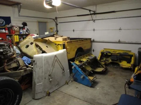

Got this 45 from my buddy 'The Commander' who got it from another club member who got it from some guy in Canada many years back.
The project came with two rear beds, one tub and two firewalls.
The tub and firewall was bastardized with the wrong firewall, so I'm mating the correct years firewall/tub. Both need a lot of metal work to say the least.
The bed that is on now is a piece of work. It's got double skins on the outside just like the tub. The second bed is much better and I'll be putting it on instead of the current one.
The general look is going to be a matte tan or desert tan finish with black rims sitting on an SOA and 35's. Love that look!!

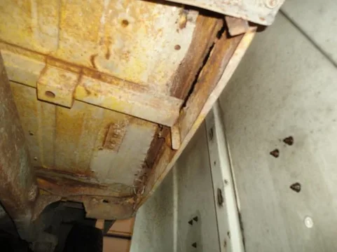

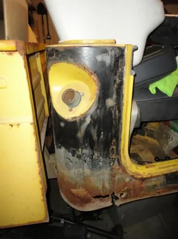

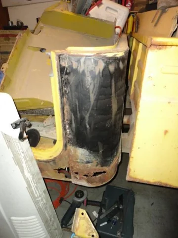

In lieu of taking the rusted piece out and replacing, it the mates in Canada added a second skin to the outside back corners of the tub. From the rocker back around to the back wall of the tub.
The drivers side of the tub has some pretty bad rust so that's going to need a lot of TLC.

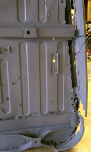

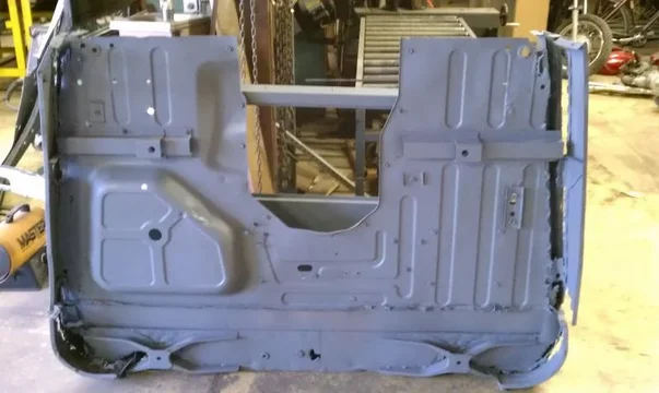

Got the 45 back from the blaster on Monday afternoon. The morning was drizzly so I relied on a friend with an enclosed trailer and kept covered until priming. Primed yesterday with it still raining so I got the parts acclimated to the garage with heat. Luckily the parts did not get rained on.
I could not believe the transition from old parts > blasted part > primed. After the parts were all primed you could really see what the elements have done to the metal over the years.
Since I have limited sheet metal working skills I'm relying Buckroseau's LV and 45 threads to see the tips and tricks as well as visuals on what the 45 tub should look like.
I'm going to start on some scrap pieces of sheet metal to dial in the Miller 172 that I have and practice. Then I'm start small with one little cut and weld on the firewall. Eventually moving to the bigger pieces. This will be a learning experience for me to say the least.
Any ideas, tricks or epiphanies that you'd like to share, please do.
Here are some shots so far.

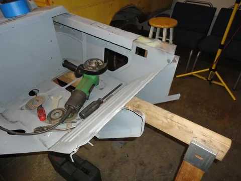

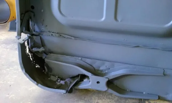

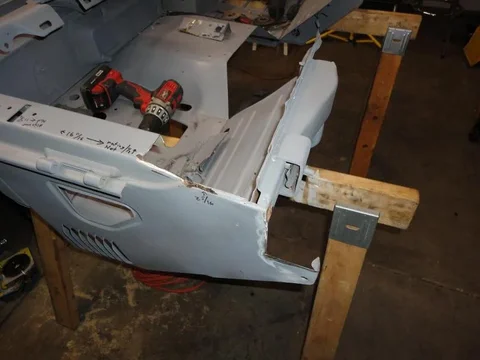

12/29/11: Spent 2.5 hours cutting out firewall cancer.
Sorry for the delay. The bathroom remodel I am underway with still needed to be finished up and I'm about 99% finished.
Got the tub up on horses and started to cut out the cancer around the lower bolts where the tub and firewall mate up. The seem were the rocker mates up to the firewall was continuously welded and heated up to the point where it deformed the steel. So my friend said just cut that out and reform it. Honestly this area is the only place on the firewall that is bad.
The right floorpan directly under the body mount support had pitted cancer. That is now out and I'll start to reconstruct it.
Heading to the the metal supplier today for some 'drops'.
