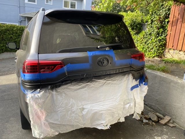

I’ve been wondering about this for months. Finally bit the bullet over the weekend and plastidipped all the chrome on the boom. I had zero experience with it so I watched a ton of YouTube videos and did a dry run on the tailgate cover first. Still pretty nerve wracking to spray directly on to the car.
Time will tell how long it holds up but so far it’s exactly what I was hoping for in a dechrome. Total cost: about $7 for the can and a new roll of painters tape. And it reallyis super easy to peel off, so if it starts to look cheap, I’ll just take it off and go for a more permanent paint.

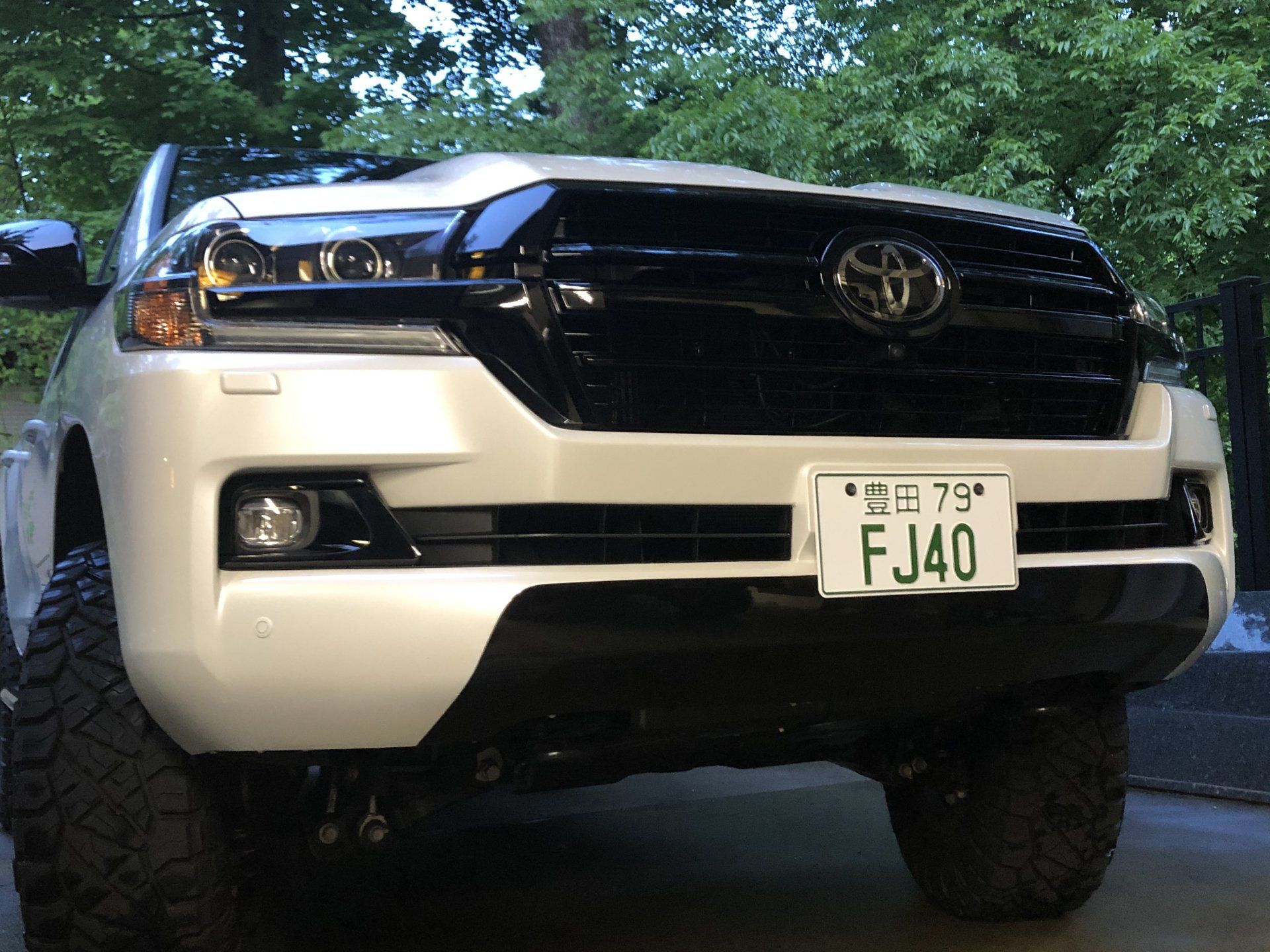

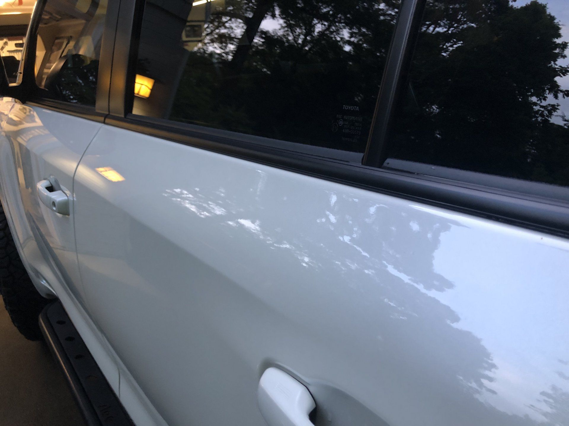

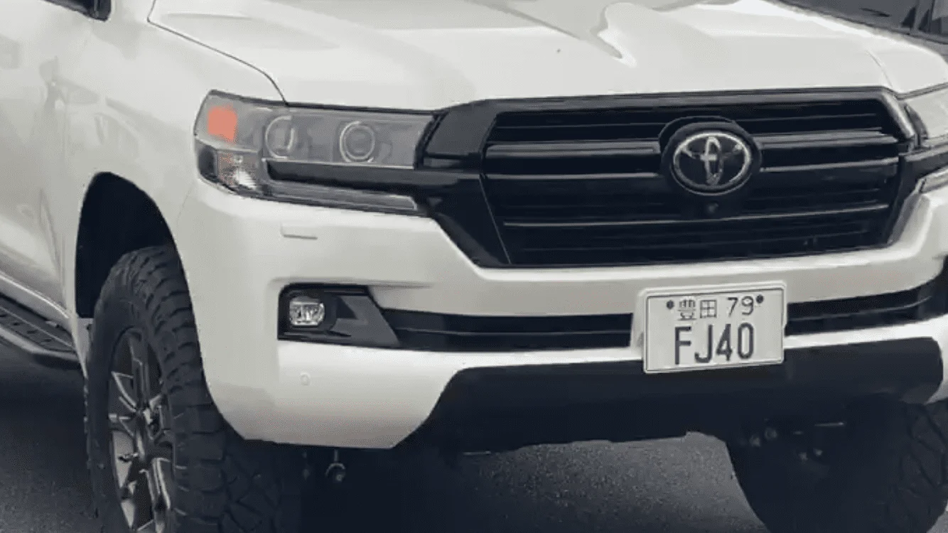

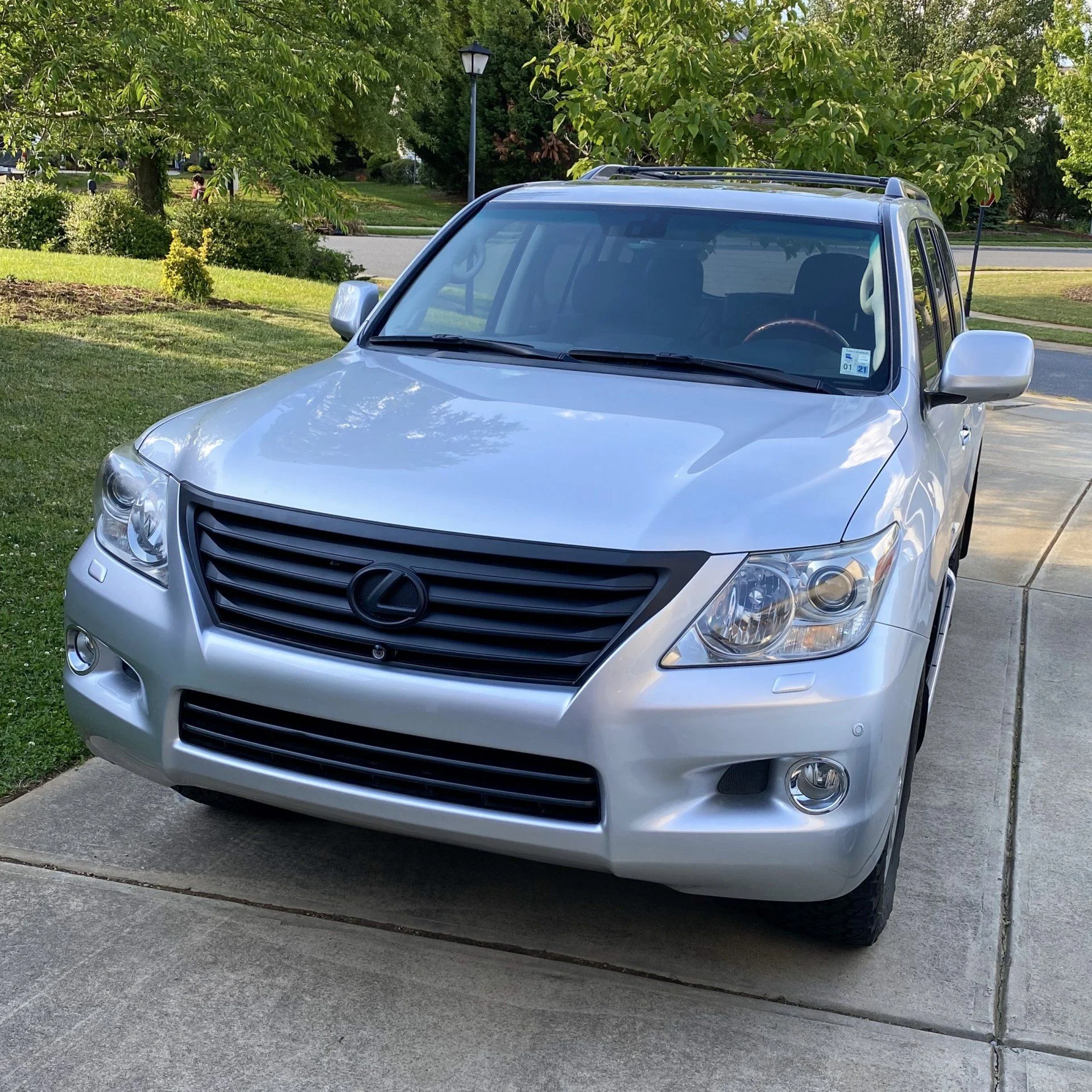

I just used plastidip on my front LX grill. First time using plastidip in my life. Used a whole can and I think it turned out pretty good. Now will try the fogs and the rear tailgate trim. Good thing it’s removable if it does not work out.
This is plastidip or proper paint?
- looks great
All painted individual pieces as listed above, like most paintwork, it is the prep that determines the paint outcome!
Curious if you took the grill off first or just put some cardboard or something behind it.

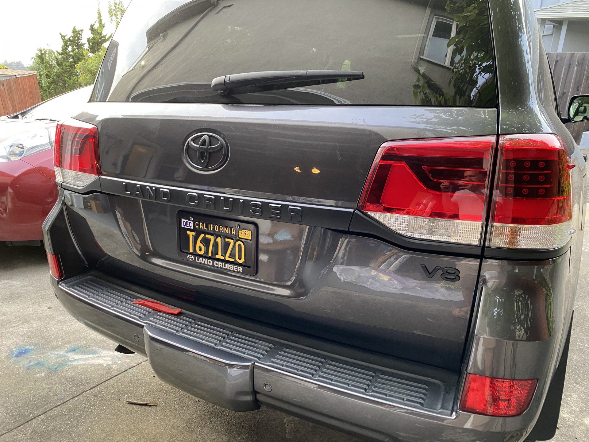

On my 2020 i decided to wrap and chrome delete:
The back hatch is dipped as the shop said they couldn’t wrap the lettering. I think it worked well as it’s hard to tell where the satin wrap ends and the dip begins.
The grill is a problem. Nothing appears to stick to the chrome inserts, neither dip nor wrap. Toyota claims they have a new finish but not sure if that’s true. The only solution seems to be sanding and painting...

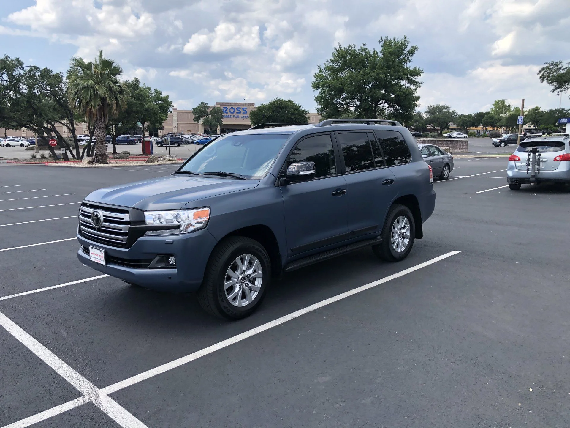

The truck looks silly with the stock rims and tyres (a friend said it looked like “The Rock wearing Birkenstock's”. I have to drive from San Antonio to Vancouver over the next few weeks so thought i would wait for the Methods and Nittos.
