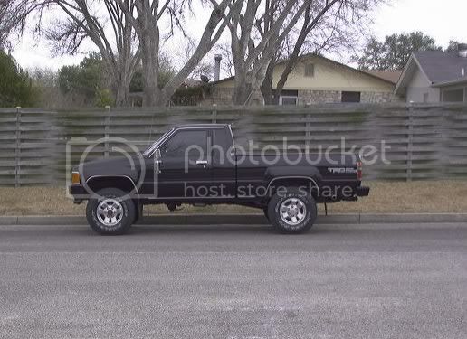

If the stock leafs are not competely bent out of shape from the blocks, I would recommend using an add-a-leaf for a Tacoma. Find a cheap one for a '05-up that is suppose to be used with those 2" lifts. The leaf is longer than one that would be sold for your '89 but they ride oh so nice. I did this for my sister's truck and it rides soo smooth and gave it some lift, not to mention I paid $20 from a member who didn't want to use them on his Tacoma. The way it sets, it would match well with BJ spacers. Then you can always add 1-1/2 or 2-1/2" longer shackels if you feel the need.
Oh, that's a 4runner you got so the top will need to be factored in. I say the Tacoma add-a-leaf with a 1-1/2" longer shackel. If you go with a longer shackle you'll hit the exhuast, that is if it's still in the original routing. I set up my dad's 4runner with an add-a-leaf and 1.5" longer shackels to match his BJ spacers. I didn't use a Tacoma leaf because I didn't know I could at the time. It was later that I did my sister's truck. I'm sure the Tacom leaf would work just as well but probably ride slightly better. The leaf on his 4runner is thick and short. Usally these ride ruff but with the top it's quite nice, without the top it's noticeably stiffer.

If you can also find a set of low mileage '92-'95 4runner or truck v6 t-bars, you might want to give those a shot too. I did this on my sister's truck and dad's 4runner with good results. The newer bars even with 180k miles off a '94 didn't sweat some cranking to level the truck to match the Tacoma AALs. I also put on some lower upper arm bump stops due to the hight, which on her truck turned out to be about 1.5". Remember these bars ARE different than the 4cylinder bars and older v6 bars even though they are the same diameter. This would also be the time to get the later style anchors and bolts, which makes adjusting the bars soo much easier. You'll only need to re-use the cone washers for the head of the bolts. (This is only applicable for '86-'88)
So here is my sister's truck. I'd take a picture of my dad's 4runner but the motor is out of it at the moment.
