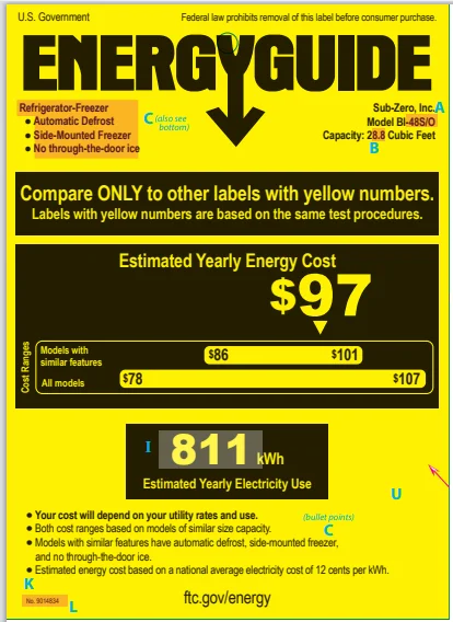

Energy cost? That's like saying I can afford a Ferrari but not the insurance. I can swing $100 a year.
Lucky you, nice to be in a 12c / kWh area. Us, it's more like 45 or 50 now. And my current kitchen fridge (now 8 years old) is using 430kWh / yr (my measurements). My earlier Subzero fridge was costing me in the high 3 figures / yr to run if I remember correctly.

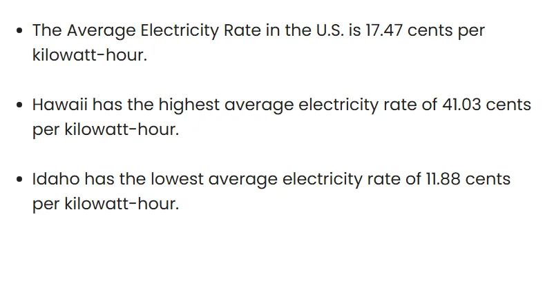

Seems like you would know to the penny your electrical rate if you measure your refrigerator usage on an individual appliance basis. I have no idea what ours is here. That's just the federally mandated sticker that I posted. But, from the internet FWIW:
So do you live in Hawaii?
well, if you are interested in electricity rates, I suggest you read a bit more about generation vs delivery charges, common surcharges and fees, peak rates, time of use rates, summer vs winter rates, etc. Maybe figure out your own local rates. And start a thread on all that if you'd like. That will be interesting to look at.
