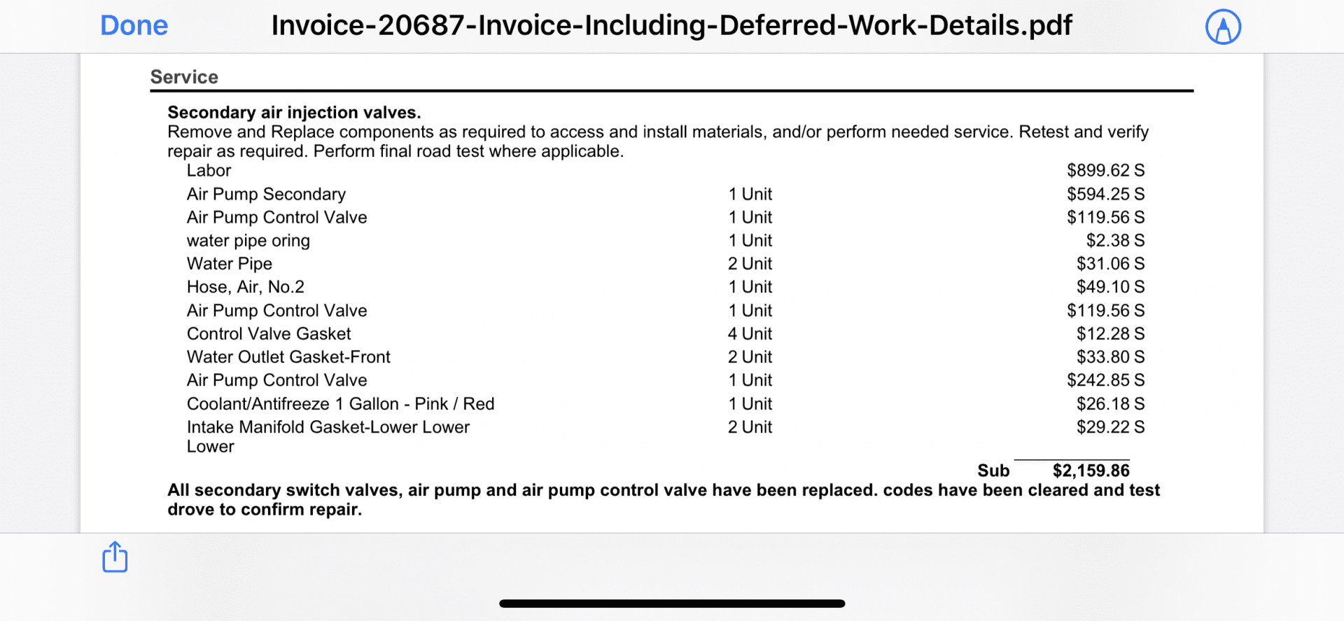

Back in November the Check Engine light and the VSC Trac and VSC Off lights came on. I read as much as I could and took it to my mechanic. He checked the codes and did the work I’m attaching to this post. It has come back on at least 5 or 6 times since. It may go several weeks or even a month (in fairness didn’t drive as much during quarantine). He looks for the problem, resets the code, and then it reappears some time later.
my mechanic has worked on this nearly every time and says he has no idea why it’s coming on now. It is showing a code of 1442 he tells me. Does anyone have any advice. I’ve spent a small fortune and want these lights to go off. I welcome ideas or suggestions. I want to fix it and do it right, but am afraid my mechanic doesn’t know what else to do.
There’s 2 pumps and 2 valves, one for each bank. He has what looks like 3 valves and one pump so I’m confused as to what he actually replaced. He really needs a techstream verify what he replaced it actually working correctly. Sometimes the relay goes bad on these too, rare but it does happen.
I appreciate the help. I’ve never heard of tech stream. Part of this whole adventure between my LX450 and LX470 has taught me a lot. It seems it’s not that expensive to buy. Is this something I could purchase to learn from? I can work with him on what it’s reading out. I want to verify he has done what’s needed, I do trust him, so I don’t think he’s intentionally done something or not tried. Every time I’ve taken it back he hasn’t charged me, so I think he’s honest. Just works on BMW’s more so than Toyota’s.
I worked at a toyota dealership so we already had the software for it but I know you need a laptop, the software and the cable to connect to the OBDII connector. I’m sure If you search on mud, someone has all the info you need to do it. I’m guessing he used OEM parts? Could be something like he got a faulty part or didn’t put something back together correctly, hard to tell without looking at it or knowing exactly what did or didn’t do. I know most people loathe going to a dealership but in this case, it might not hurt to.
