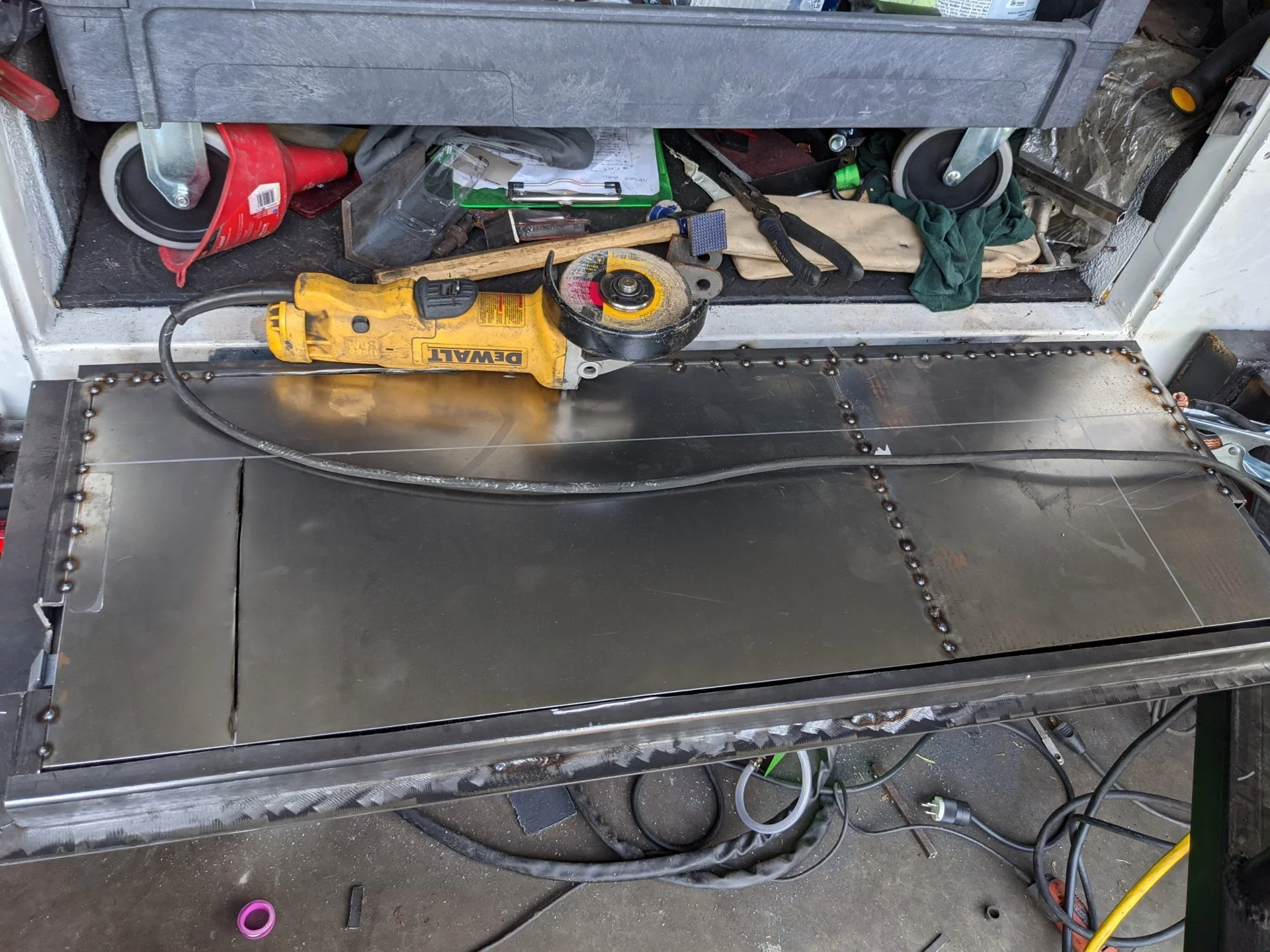

  1. welded the sheet directly to the rig so that it wouldn't move and cut out some holes for the hinges

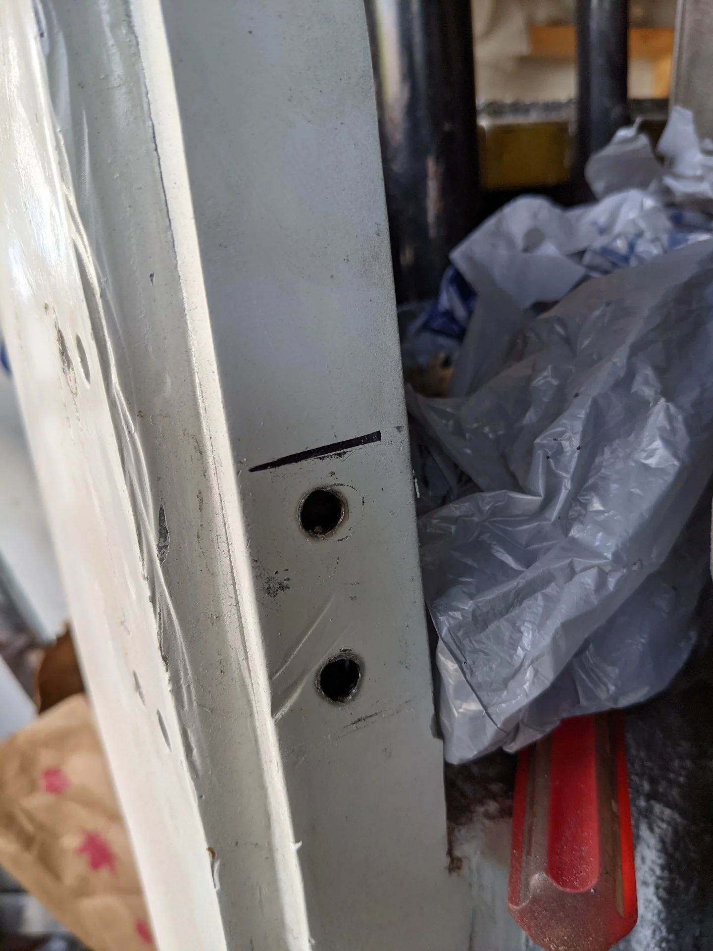

  2. The PO welded a 2x2 square tube to the rear body to account for some rust. I just welded a steel rod to the tube to make it flush with the rest of the body, and drilled and tapped some holes for bolts to hold the hinges in place

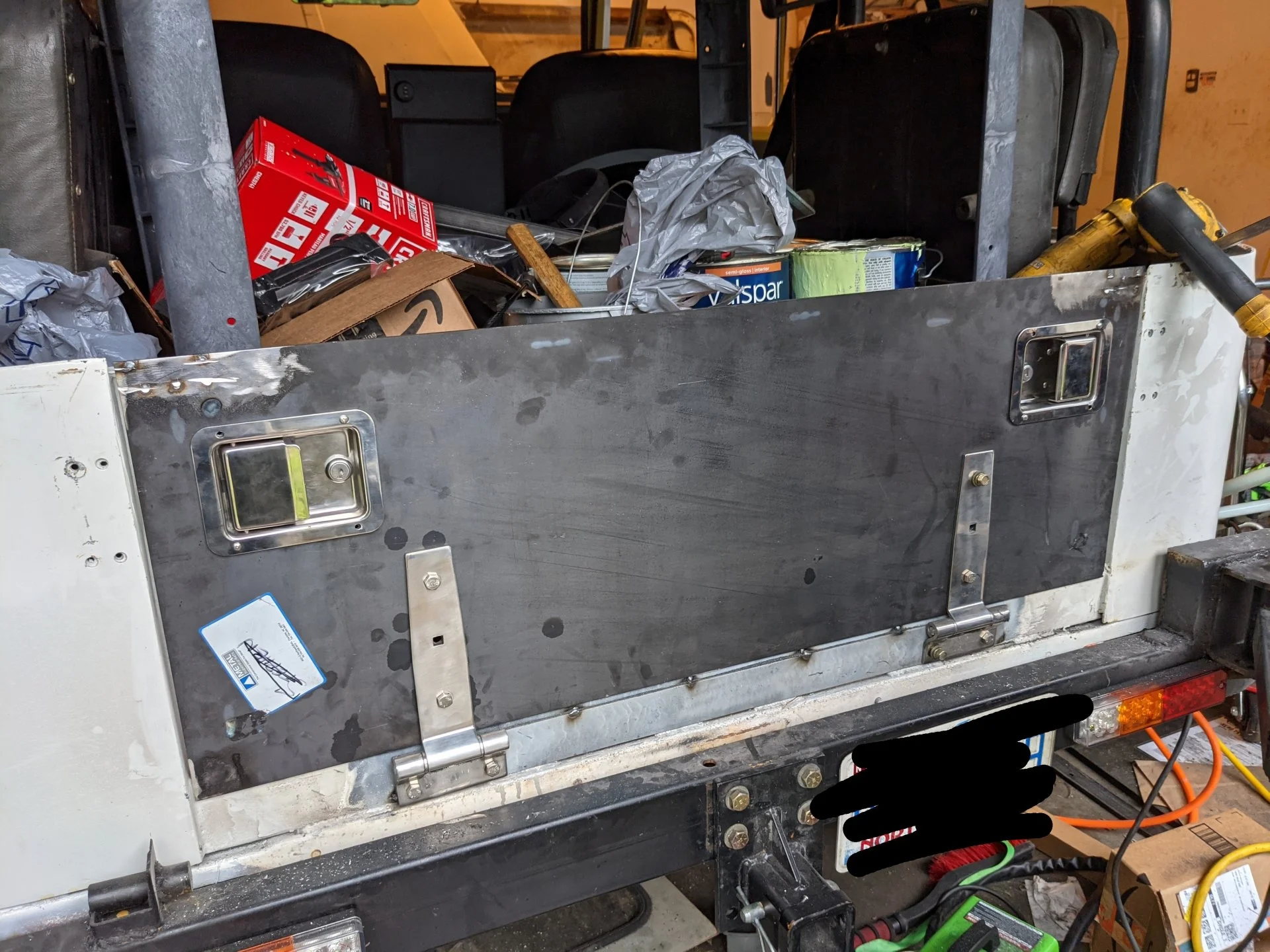

  3. finally got to use my cheap plasma cutter to cut out the holes for the latches. they're not very straight, but it got better as i went. in the photo you'll see that one is much worse than the other. I'll end up cleaning them up with a grinder at some point

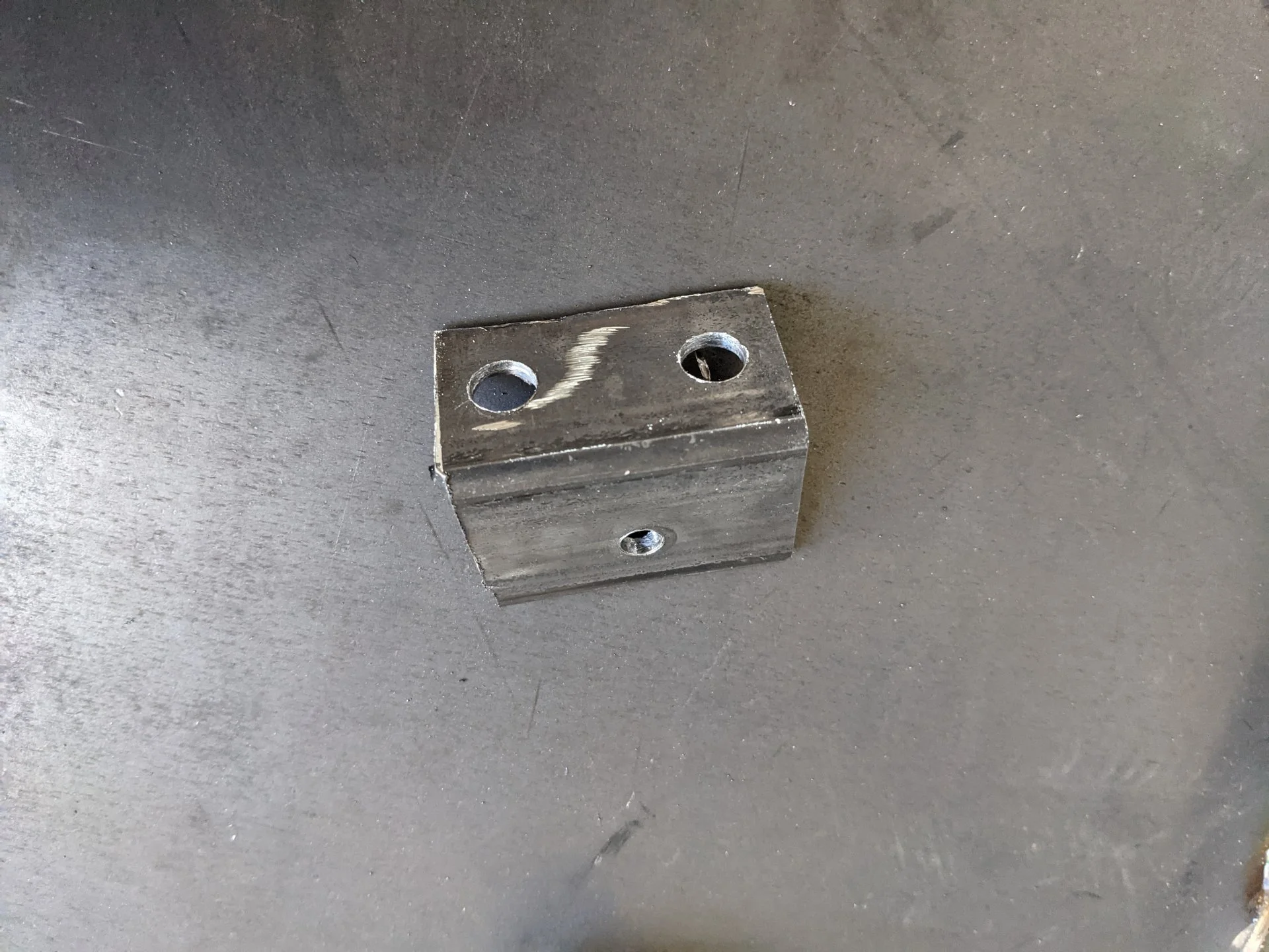

  4. cut the square tube into sections, and split them in half to make the container of the storage section and keep the tailgate rigid
Finished the work on the storage sides, and drilled holes to mount the latches. I mounted the latches and hinges to see what it would look like and it looks awesome! Forgive the messiness of the rig. Its serving as storage at the moment :)

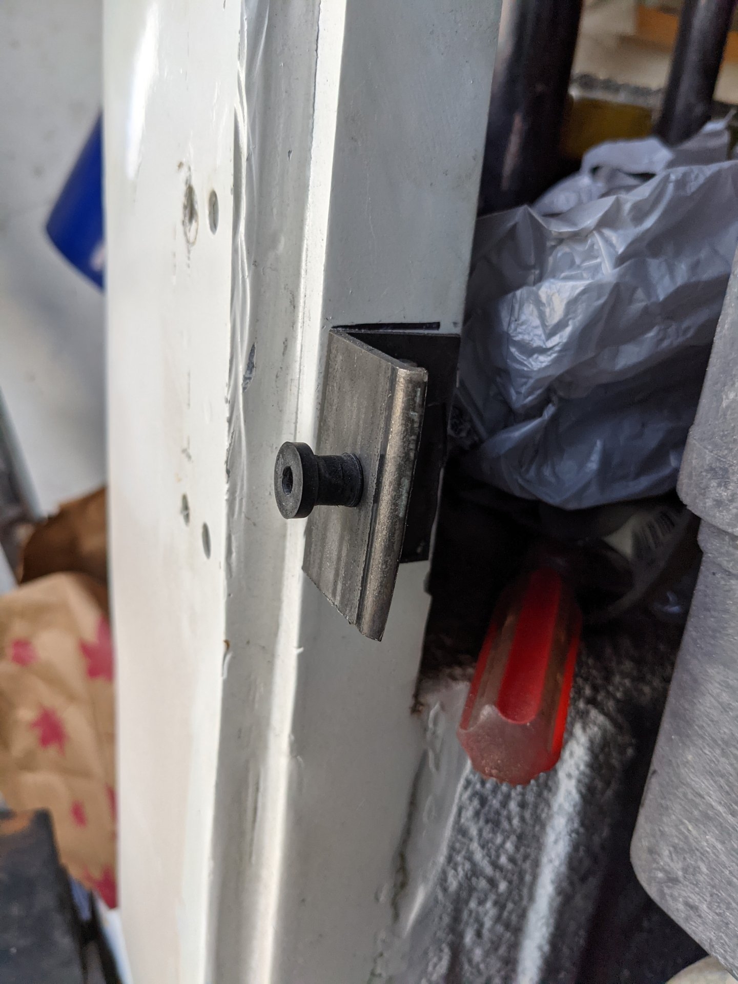

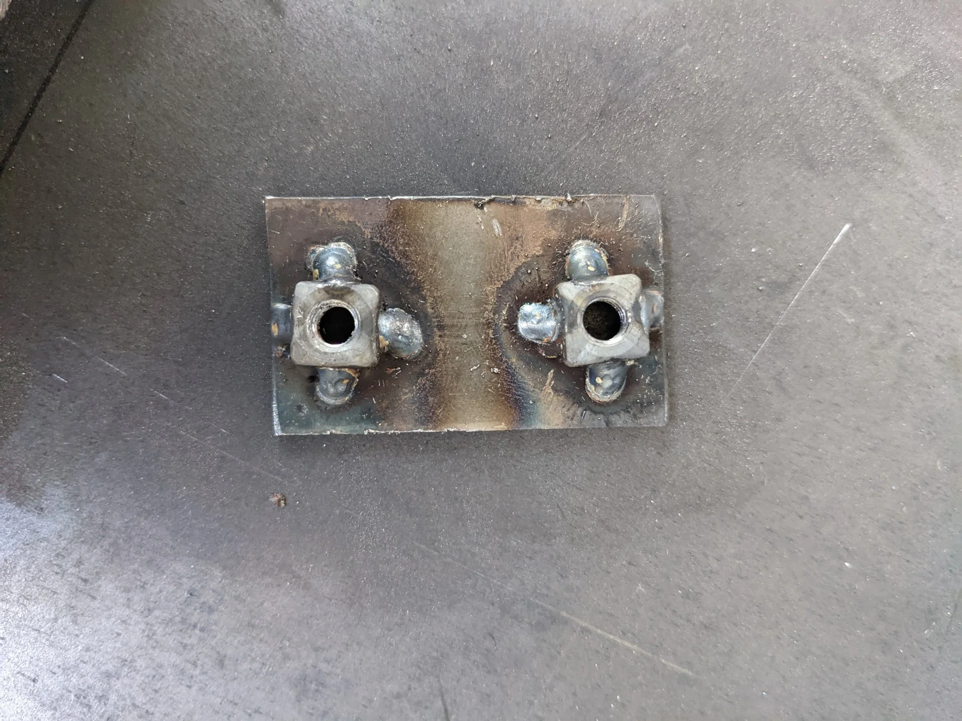

Cut out some backing plates with some steel that I had on hand, and welded some square nuts onto it. then split more of the square tube to make catches for the latches, and attached them to the rig. The holes are oversized, so I'll have some adjustability. I also found some rubber stoppers in the garage, and used those to stop any ratting of the tailgate

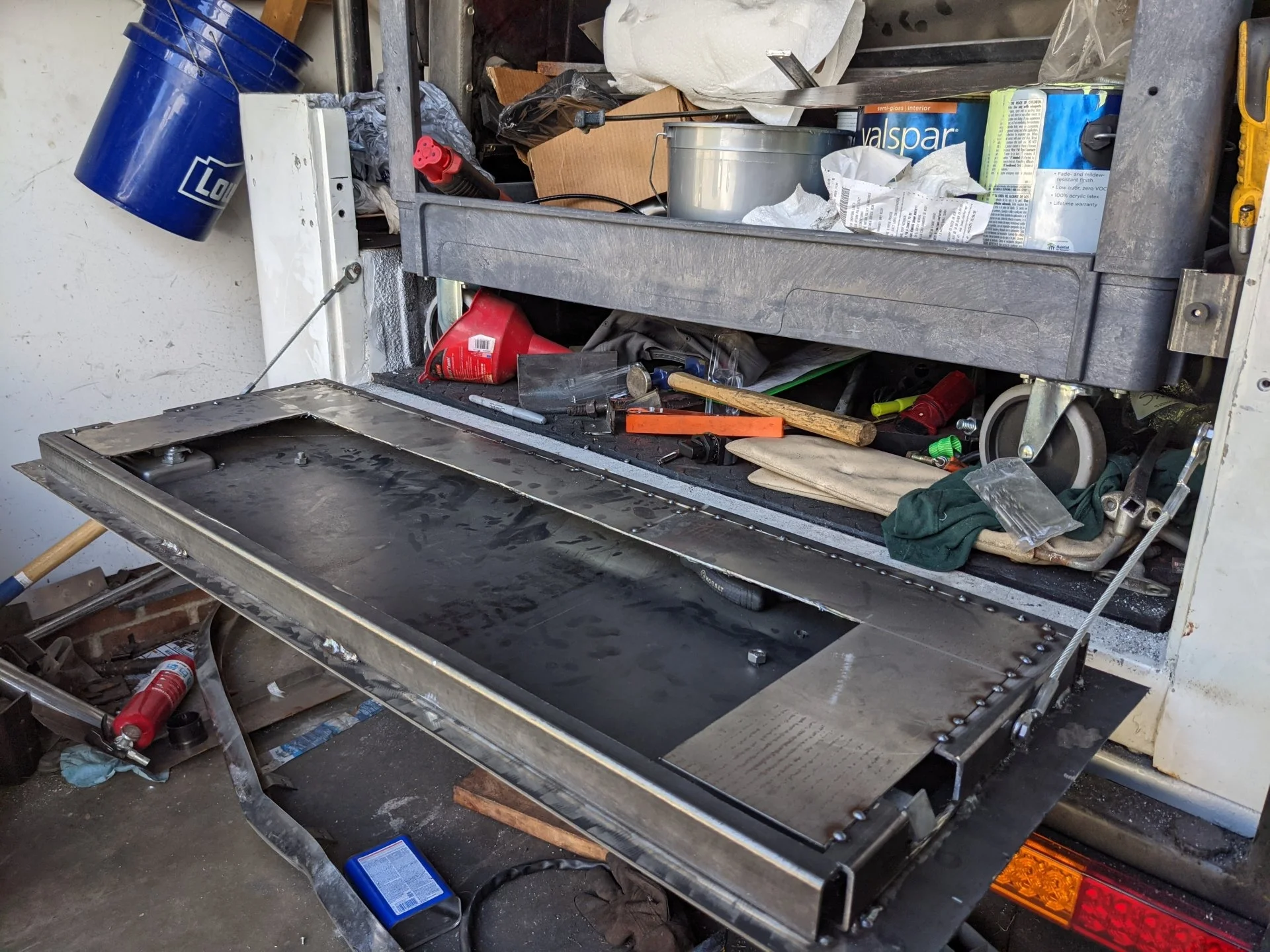

Tailgate cables came in! They're a little short, but I think the way they're mounted will work. I drilled the holes, and will end up making backing plates for them just like the latch brackets. I'm pretty happy with how they look.
Also welded together some 14 gauge steel sheets to make the inside of the tailgate. Welded them on, then cut out a section that will be for the door.

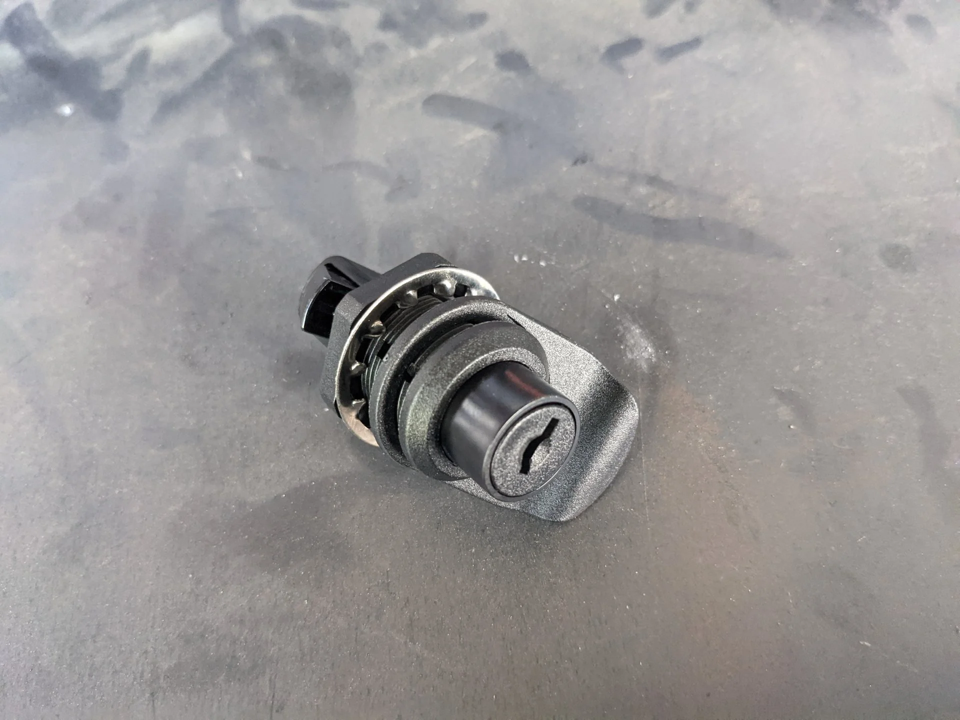

Ordered a hinge for the door and a push button latch, and I'm officially at my budget cap for the tailgate. Everything else that I use will need to be items that I find in the garage. i'm pretty close to having everything that I needed, so I'm going to pre-emptively say this was a success. Latch came in today, hinge should be delivered in a few days. I think i'll be done soon!
