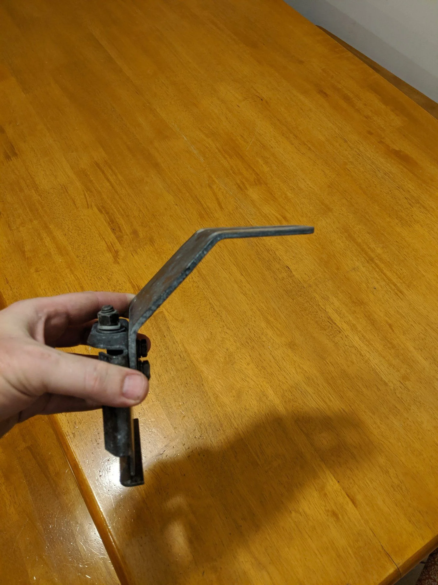

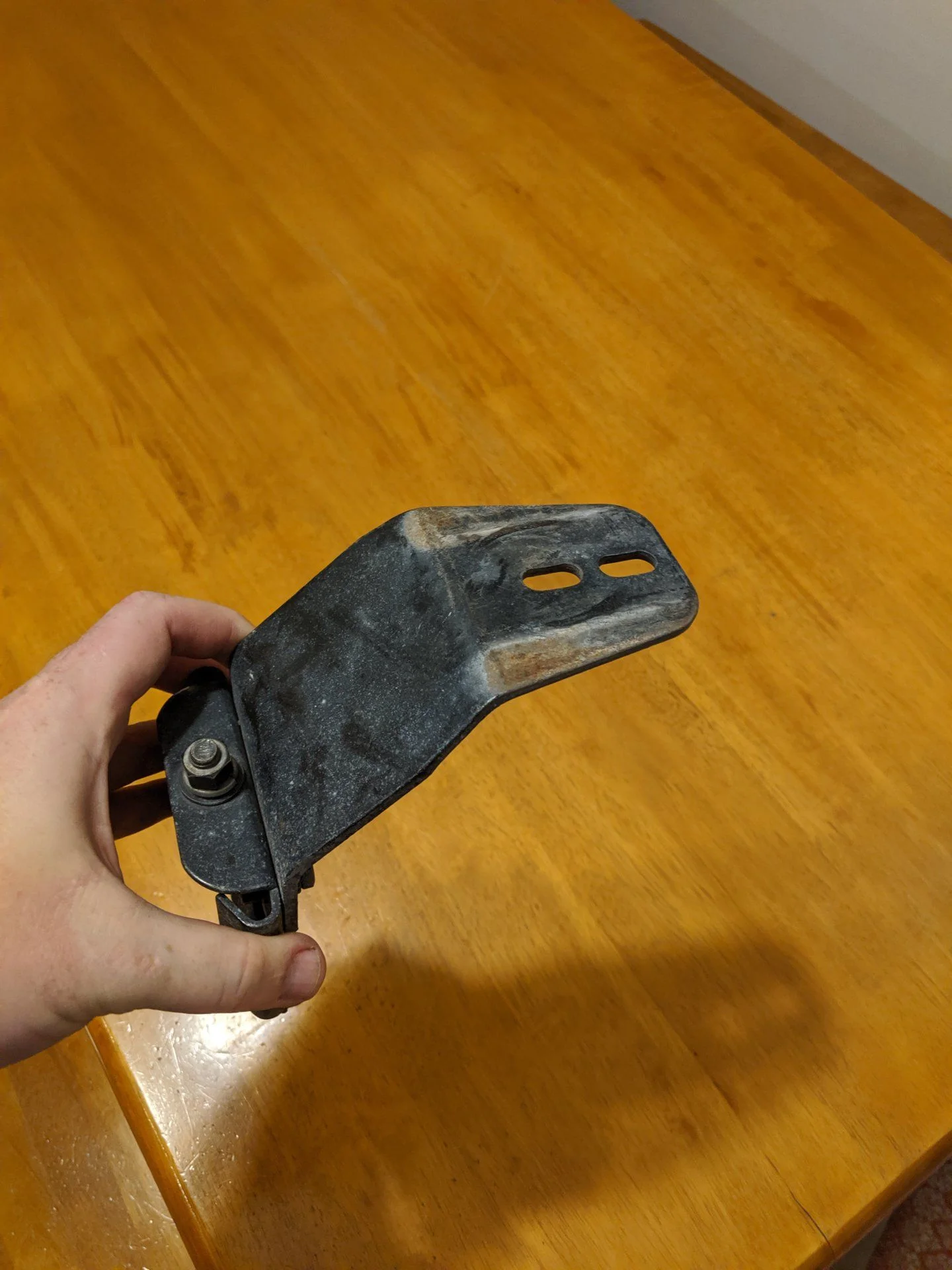

My son has the FJ80 up at college and needs a cheap but sturdy roof rack. I've got 4 brackets, but no cross bars or rack. These are the brackets...
I've made one out of an ATV ramp once... Didn't do a very good job. I've also used sign posts like from a stop sign. He thinks that's too redneck. I say it's not redneck enough. Agree to disagree. ;)
Other options, or advice on making the ATV ramp work more securely? The aluminum seemed pretty weak.

You haven't mentioned what he needs the rack for, or if there's a factory rack up there, so a little hard to help. Also it looks like the part in the picture is only half a clamp - what holds it down in the drip rail? Ski rack to drive up the mountain to ski? Bike rack to go half a state away? Just to carry a fly rod on the roof?

@IdahoDoug , Also, the clamp is on, it's just not obvious in the picture.

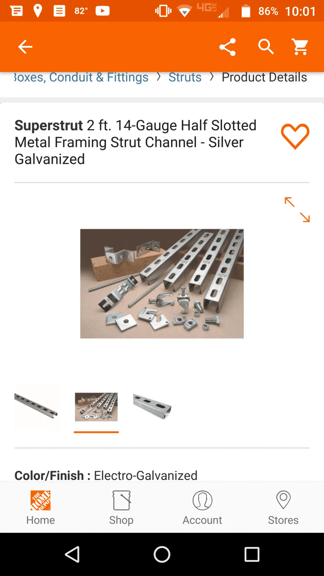

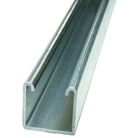

What about the galvanized steel channel they have at home Depot? I knew a guy that used it for exactly what you're doing, but I don't know how much it handles.
