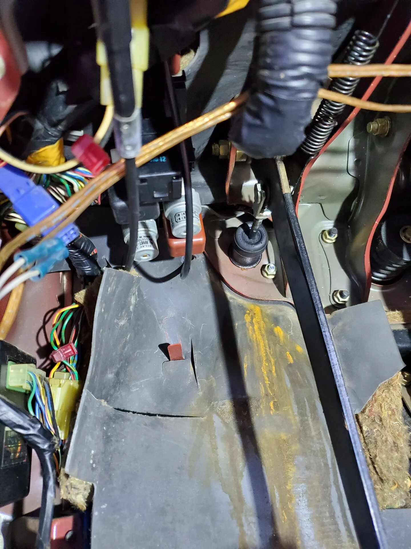

Have had a wet driver side foot well for a while, starting diagnosis. Thought it was leaky roof gutter, but didn't stop with temporarily covering the gutter, and upon further investigation it seems much more involved. It hasn't been driven in several years (that's another activity) but the water entry happens with every rain storm.
The staining on the firewall insulation pad in this photo is right below the clutch pedal, but there is no staining or streaks anywhere above the pad, on any hardware or bracket or underside of the air plenum. No rust seen anywhere up there, including lying on my back, head on and under the pedals, with lots of flashlights.

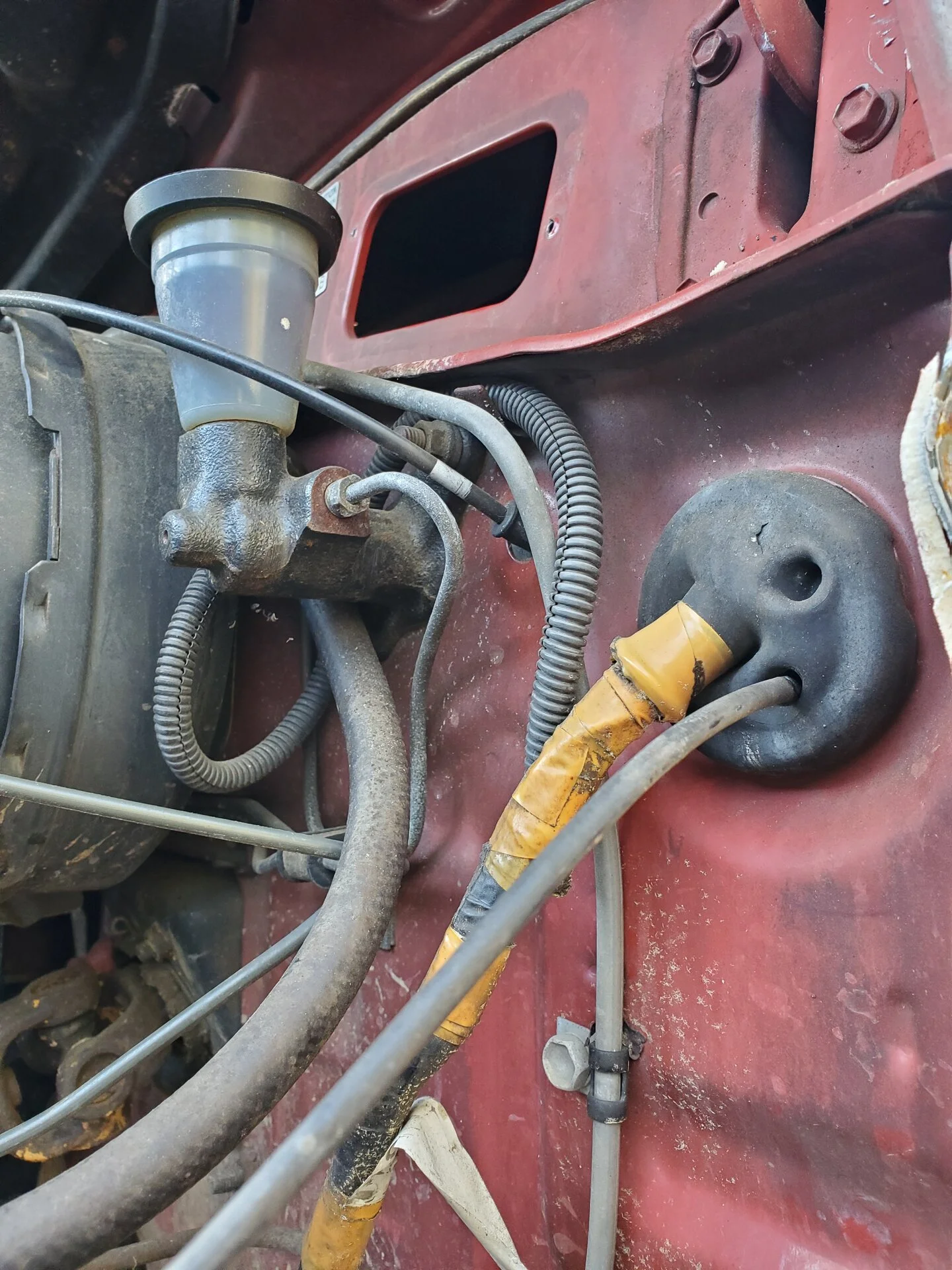

Closeup of clutch master cylinder.

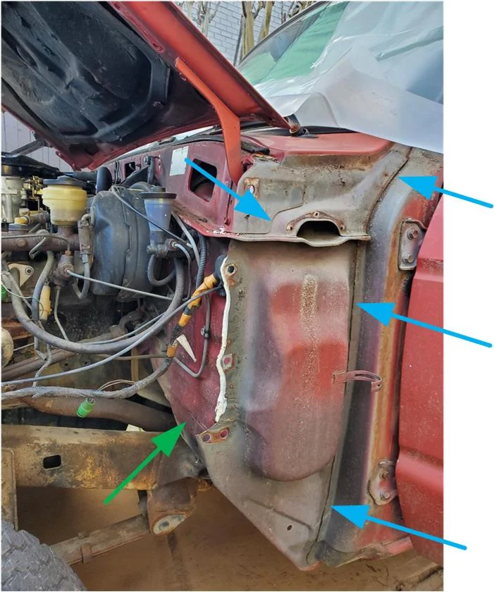

The fender is off, and there's minimal to no seam sealer on the inside seams as is common. I'll rustrproof and seal that up (blue arrows.) The horizontal seam behind the pedals (green arrow) has sealer and it's in good shape, but I'll but another layer of sealer on top of it. But I don't think the inside seams are the source of the below clutch pedal leak. I've blown out the intake air plenum on the driver side, looked and felt around inside and even tried an inspection camera, but everything feels fine, and I don't see a spec of rust. Granted it's hard to really feel under brackets like the hood hinge or wiper arm.

Take a hose to seams and have someone check which one leaks. Slow flow hose. I will seam seal all joints.

UPDATE: after removal of the firewall pad, up to where it's compressed under the clutch pedal bracket, it continued to look like the water is coming in at the clutch master cylinder. FSM and Haynes don't show a gasket where the cylinder bolts to the firewall, not that I could find, but in the manuals I also couldn't find a bolting diagram or torque values for the nuts. Taking off the cylinder, there are some rust stains in the firewall hole (pressed double wall) and on the mating cylinder surface.

I've got the same on-going issue and the places you will need to seal are the cowl seams (use 3M body seam sealer), that are inside the cowl where you have the plates removed for access, and where the wiper linkage hides. You will need to remove the wiper linkage to clean and seal that area (looks like you may already have). And for good measure I sealed all those seams you have blue arrows pointing to.
