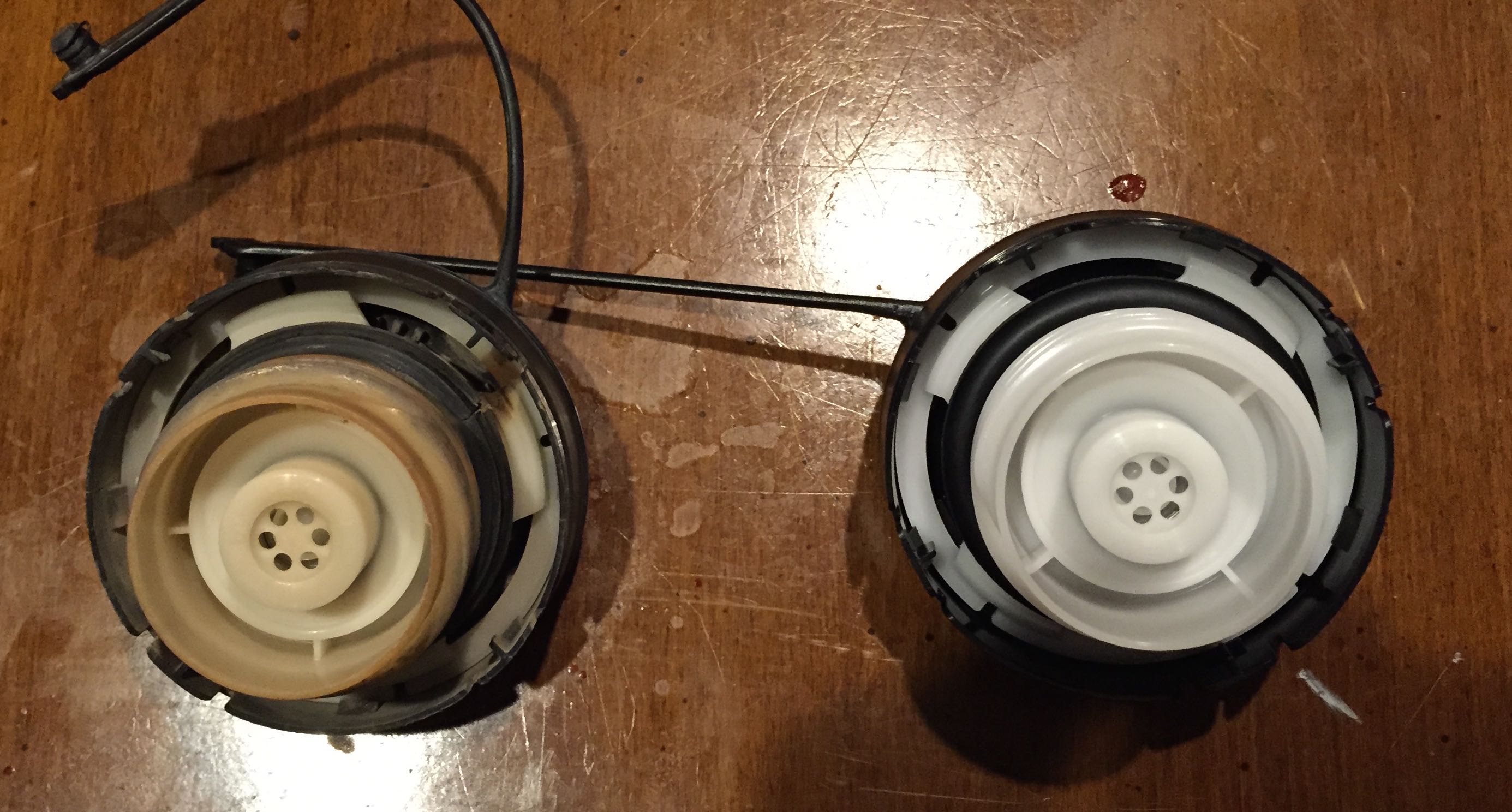

Just received and replaced gas caps on my 100 as well as my '01 LS430.
Old and new pictured below:
Interestingly (to me at least), the cap on the left which seemed to be causing a CEL on my 100 didn't do the same on the LS. There was a small hint of fuel vapor smell on the LS that wasn't there before, but no CEL. Same the other way around. The LS cap which looked better (see pic above) seemed to have solved the CEL on the 100.
Either way, both got replaced with new and for now, problem solved! Knocking on wood.
