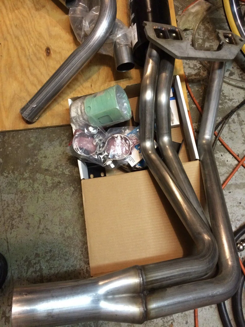

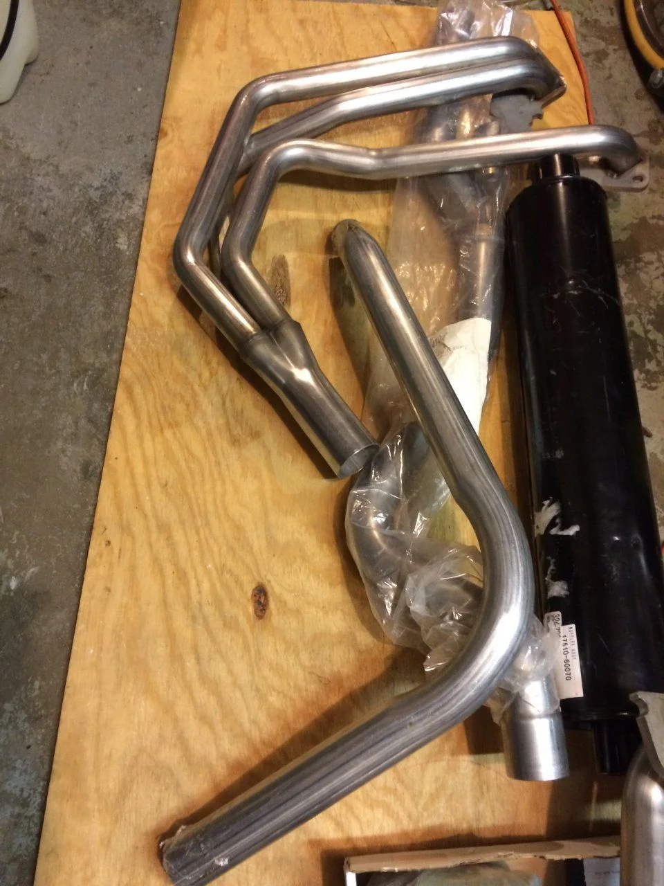

So after many years of trying to find places close to me to ceramic coat I finally found a place 1.5 hrs way :meh:
I will be bringing a header mud pipe and tailpipe to him to get coated
Then I kinda thought about the muffler ... Hmmmm
I had a SS one made several years ago... But... It rusted :meh:
Now I have a stock Toyota muffler ... I am told they are aluminized ... And used to use them they normally last 6 years or so... SS lasted about 6 as well
Thoughts on getting the muffler ceramic coated?

Pics ... Since we all like pics :)

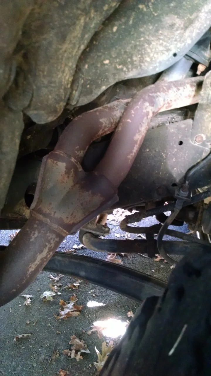

I had my Magnaflow y pipes coated with that Cerakote stuff and within a year they looked like crap. The exhaust manifolds look a lot better but certainly aren't pristine. I don't know, maybe the product doesn't work as well on stainless.
Was it done by a Certified Applicator? I would take it back. I bet they weren't coated right. That shouldn't happen.
This... I am a certified Cerakote applicator and I have stuff that is able too with stand up to 2000 degrees...

Here's what they look like now. I don't know if he media blasted the y pipe because it was brand new. He did blast the manifolds. Its too much of a pain to take them off to take back. Plus who knows if he'd do any better of a job. I may ask Cerakote what to do.
Wow... Most likely didn't prep right. I would call Cerakote and tell them about it... I get irritated when I see that happen.. It give Cerakote a bad name.
Boy ... Hope that doesn't happen to mine ...
That sucks that you went all out on your exhaust to have that happen... Wonder what could cause that?
Sounds like they are doing the same prep as my guy ... Unless they didn't do one step
To be fair, this was my guy's first attempt at this specific product from Cerakote. However he did assure me it was something he could do.
