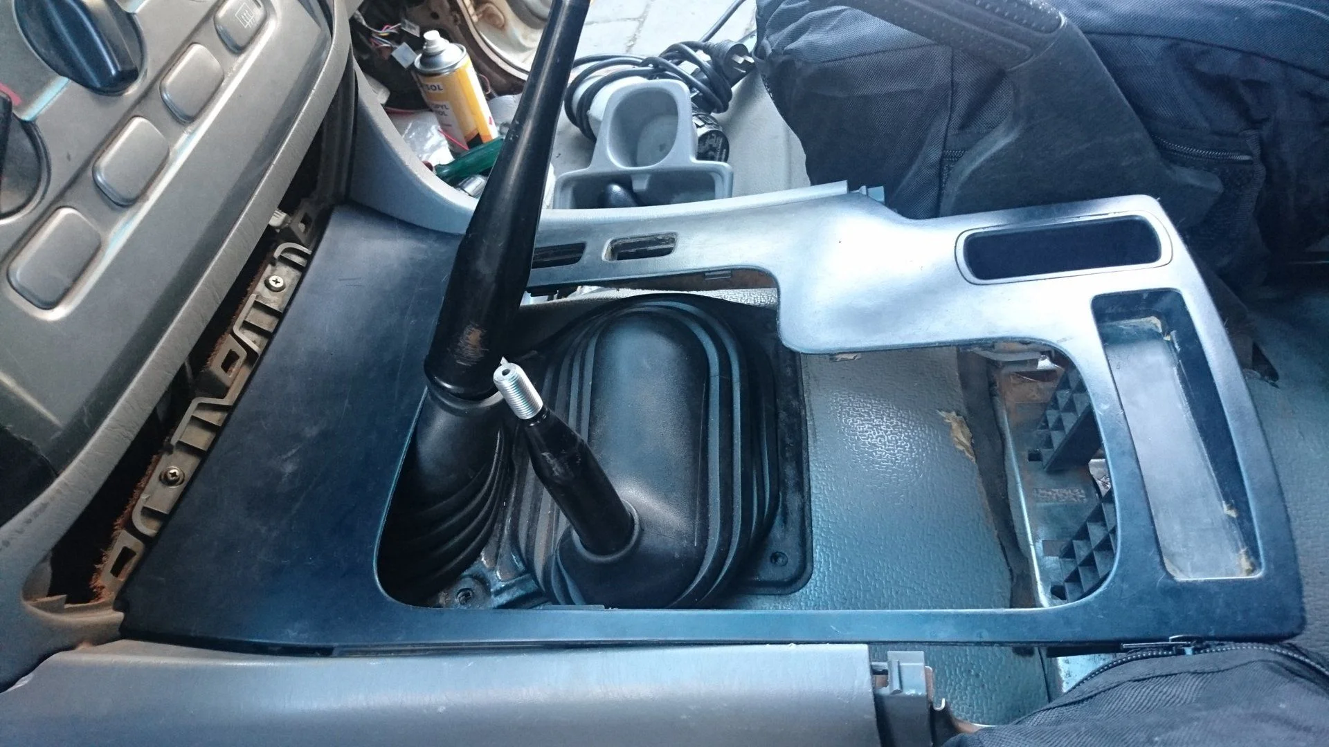

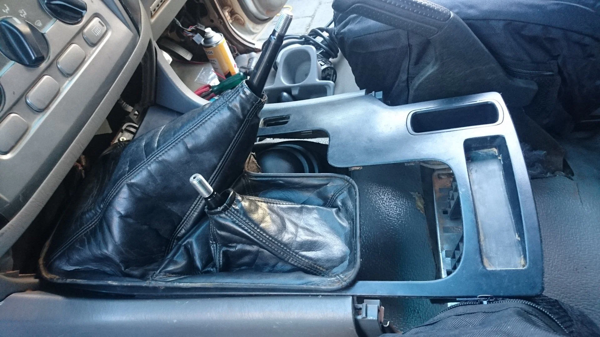

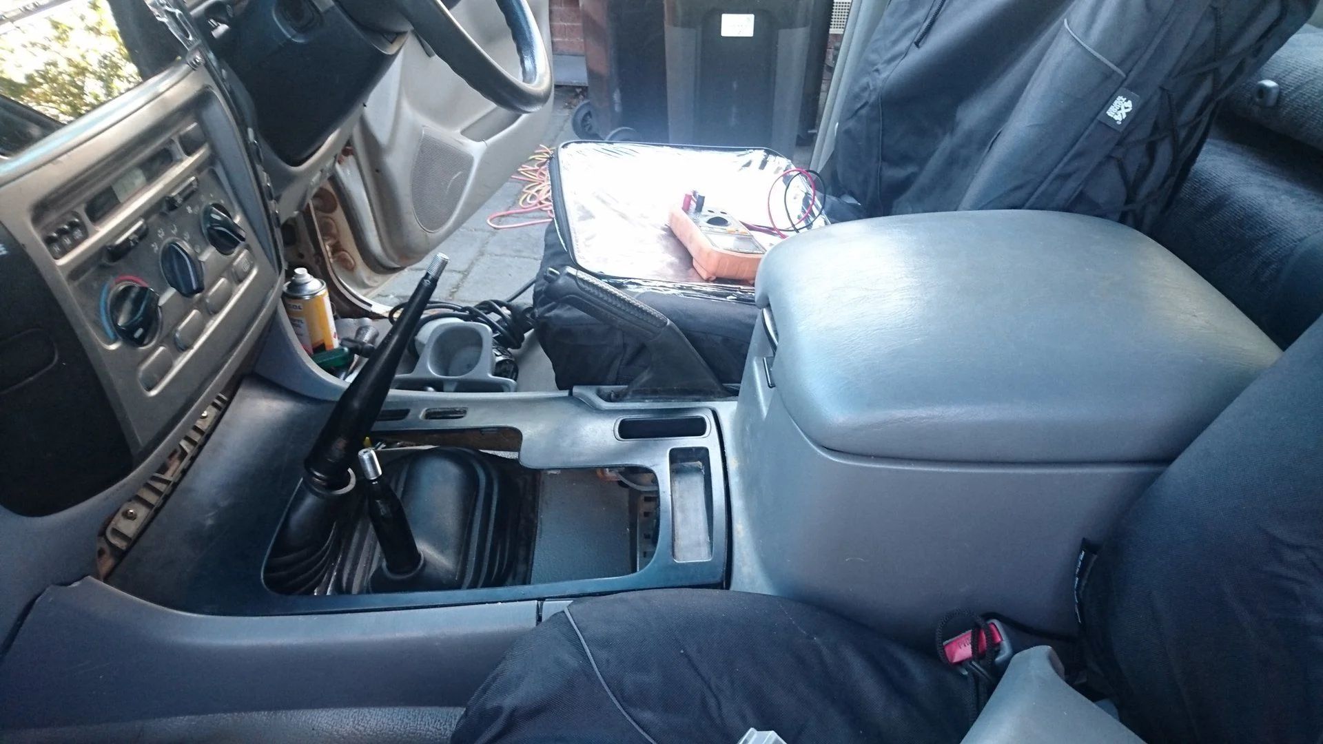

The higher specced ones have the gear closer to the driver, you need to get one that matches your car. 98 to 07 will fit
The ones that had a center console also had a different shift lever and retainer and transfer case level the had a kink that brought them back a little so they fit in their cut outsThanks mate im confused. The one in the picture is from a 1999 Gxl 105 manual console it's sitting in
My car is a 2004 105 manual

ahhh, so I get a gear stick from the same vehicle and it should suit the surroundThe ones that had a center console also had a different shift lever and retainer and transfer case level the had a kink that brought them back a little so they fit in their cut outs
You may also need a retainer and make sure that every thing else is the same if I were you I would go to a scrap yard and look at the parts in a vehicle that came with a console just to make sure that it will fitD

Good advice.You may also need a retainer and make sure that every thing else is the same if I were you I would go to a scrap yard and look at the parts in a vehicle that came with a console just to make sure that it will fit

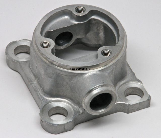

It is yeah if you take the shifter out it is the base that it sits in you should have the h151f gear box so it should look like thisGood advice.
I am unclear as to what you call a retainer? Is that the part that holds the gearshift into the gearbox? Cheers mark![]()
Yep. That's what I thought it was thank you for clarification.It is yeah if you take the shifter out it is the base that it sits in you should have the h151f gear box so it should look like this
The ones with the center console had a different style retainer im just not sure if it fits in the same gearbox without any modifications they are both h151 gear boxes just different variants
Hi, just re read your post both my 105 and donor 105 have R151 boxesIt is yeah if you take the shifter out it is the base that it sits in you should have the h151f gear box so it should look like this
Not sure what the one you pulled the center console had your best bet would be to look at one with a center console in a scrap yard see what is different between them so far all the 105's I've seen had no center consols at least the ones exported to where I live we only got the Fzj100's which had the H151 with two variants one for the bench seat type and one for higher trims with a center consoleHi, just re read your post both my 105 and donor 105 have R151 boxes![]()
InterestingNot sure what the one you pulled the center console had your best bet would be to look at one with a center console in a scrap yard see what is different between them so far all the 105's I've seen had no center consols at least the ones exported to where I live we only got the Fzj100's which had the H151 with two variants one for the bench seat type and one for higher trims with a center console
