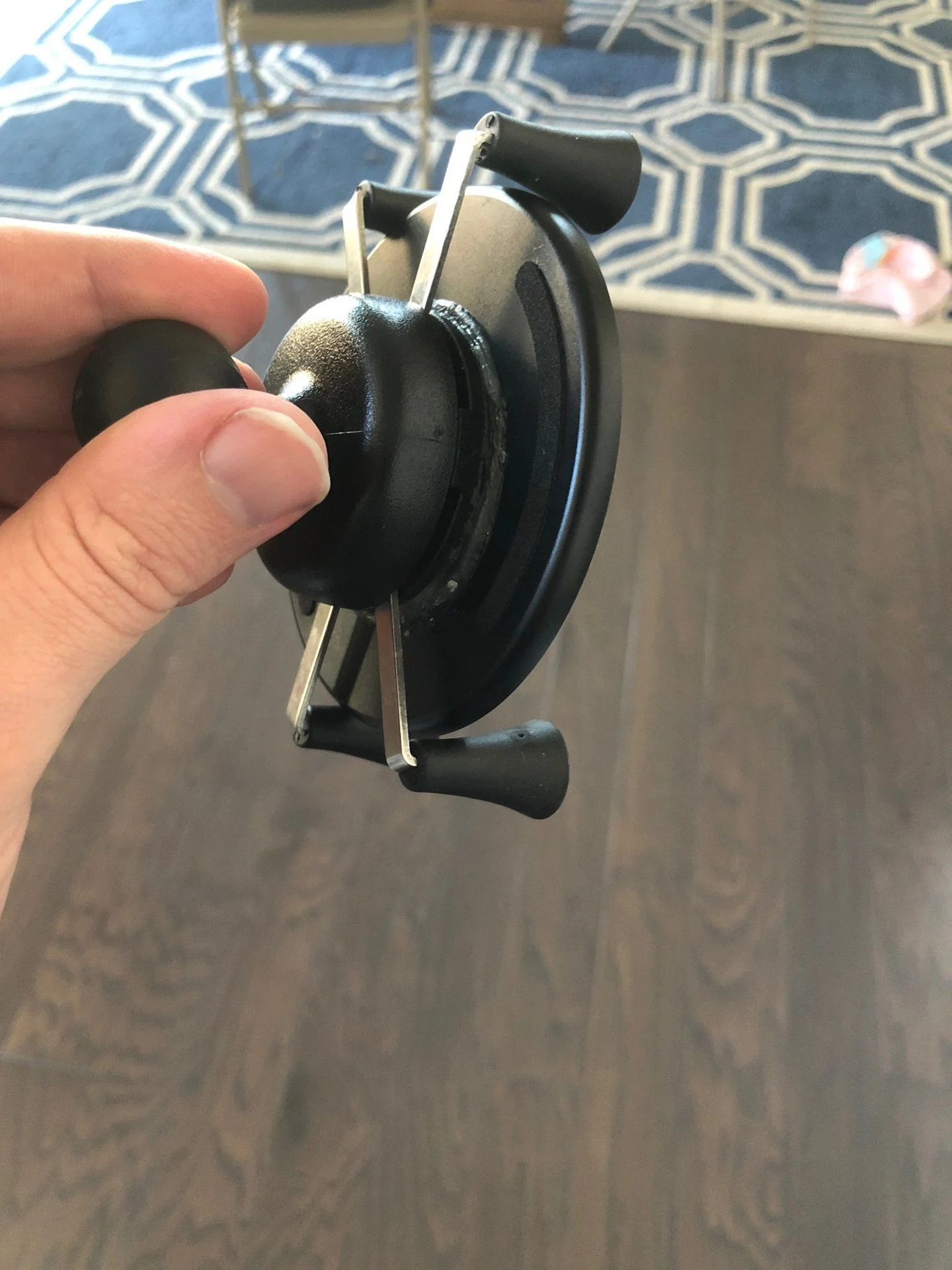

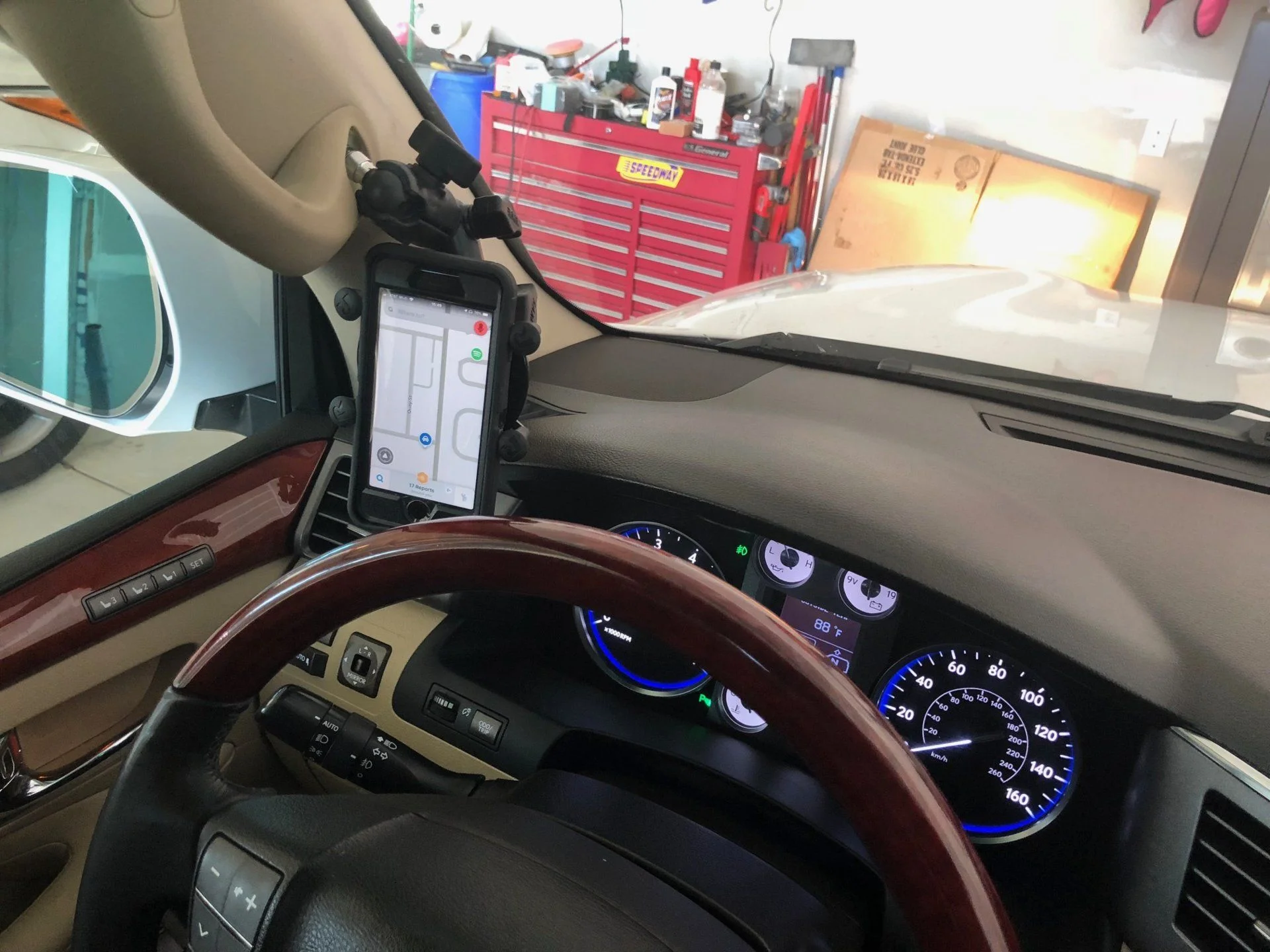

Not quite what you are asking for but I attached a thin Qi Wireless charger to a Ram Mount X grip and attached it to the A pillar. I know some people have concerns about the air bags but I looked at several pictures of LX/LC on Copart and I don't think the airbag will inter fear with this. With my seating position and hand position I never touch it and it doesn't block any vents.
That’s cool. Do you have a comments list you used to assemble this?
Wireless-Charger-Station
http://a.co/d/3TfyIcU
Ram Mount Motorcycle Handlebar Clamp Base with M8 Screws
http://a.co/d/bwBKyZT
Ram Mount Double Socket Swivel Arm for 1-Inch Ball Bases
http://a.co/d/ffFXylx
RAM® X-Grip® Large Phone Holder with Ball
RAM® X-Grip® Large Phone Holder with Ball Unpackaged
I got this from ebay.
Sourced Locally
1 M6x50mm Socket Head Bolt - Stainless
2 M6 Nut - Stainless
2 M6 Flat Washers - Stainless
Loctite Plastic Epoxy (I already had this)
Loctite 0.85 fl. oz. Plastic Epoxy-1360788 - The Home Depot
This isn't a new Idea, several people on the Tacoma Forums have done it and I also believe a few here have as well. My addition to the idea is the Wireless charger
I've been thinking about adding a wireless charger to the xmount. Don't know why I didn't thinking of loctite and just sticking it on the xmount. Thank you for the inspiration! Where is the wire going to the charger?
Its wireless!
No really I haven't ran the wire in the car yet. This particular charger has a small slot for a lighting cable. It wasn't attached in that photo and for testing I just have it running over to the outlet in the center console. It does need a pretty high amp adapter to work through my otterbox. I used this charger at my desk for a few weeks testing it before proceeding. It would not work on one of those small ac/dc cubes but it would work with the larger ones for iPads. It also worked best using the high output usb port on my laptop. Again this is due to my case thickness.
Its wireless!
Solar powered! Haha.
Ah, okay. I think I'm going to have to run it to the center for now. I'm thinking of using a add a fuse to the fuse panel inside the car.
