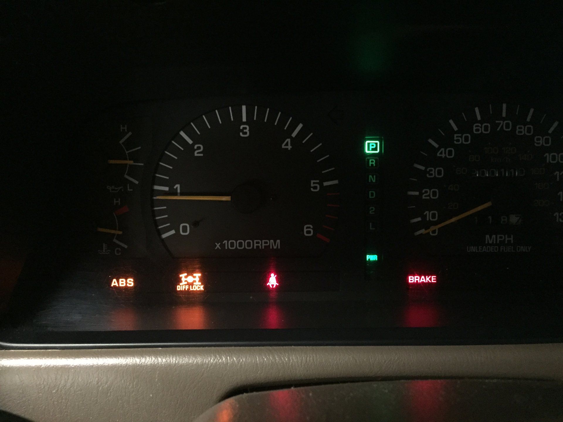

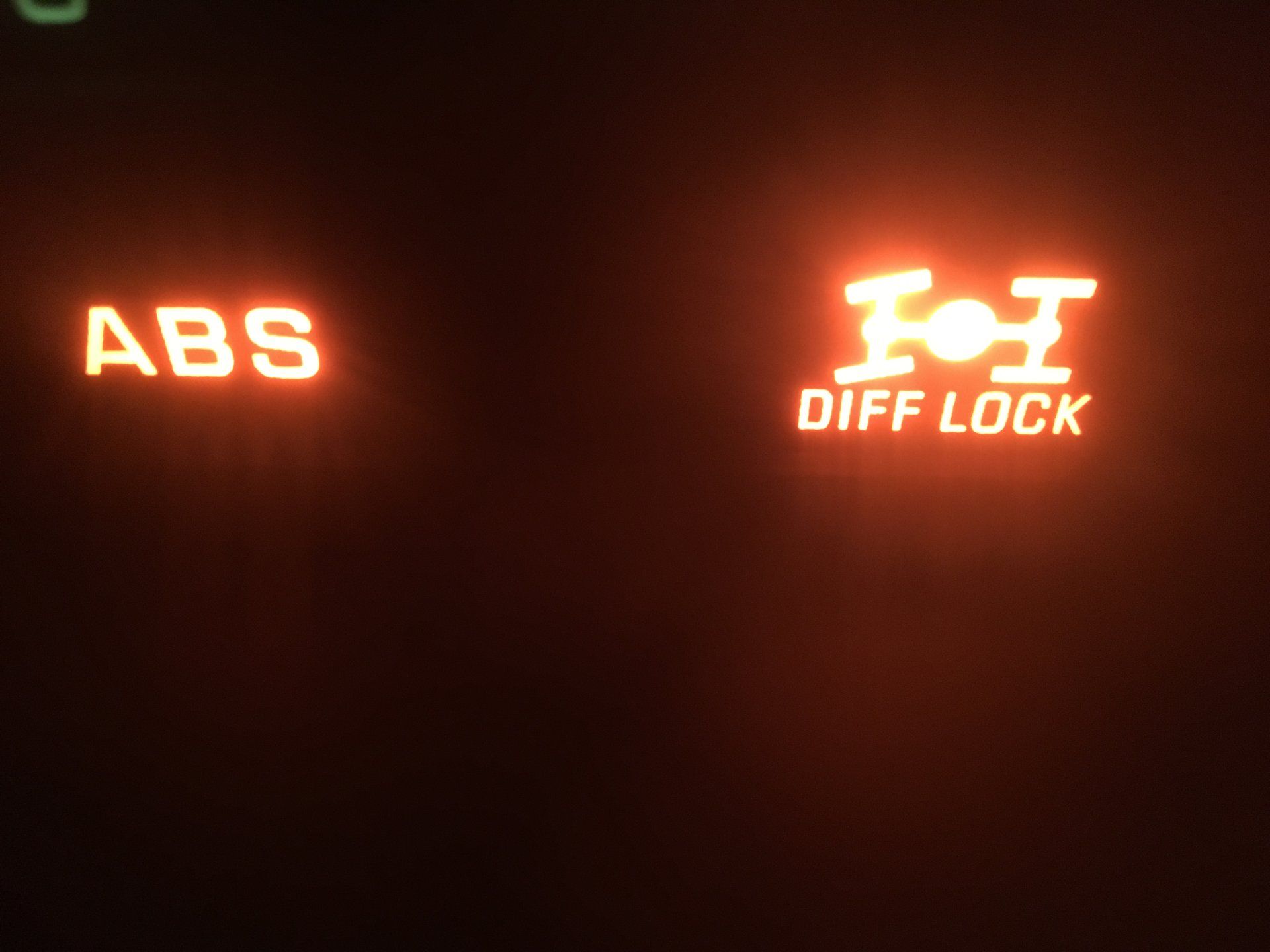

FYI in 4 low the CDL and ABS light will come on if everything is working correctly. There is no separate light for 4 low.
@Proven - above is the default setup, so when you had no CDL switch (or pin-7 mod) - you should have seen the CDL & ABS lights in the lower row on the cluster light up to confirm you were locked in the TC, and ABS was defeated while in 4L.

When then center diff is engaged properly...
...on an fzj80
...an FJ80 looks different. no abs light, center diff light more center/right

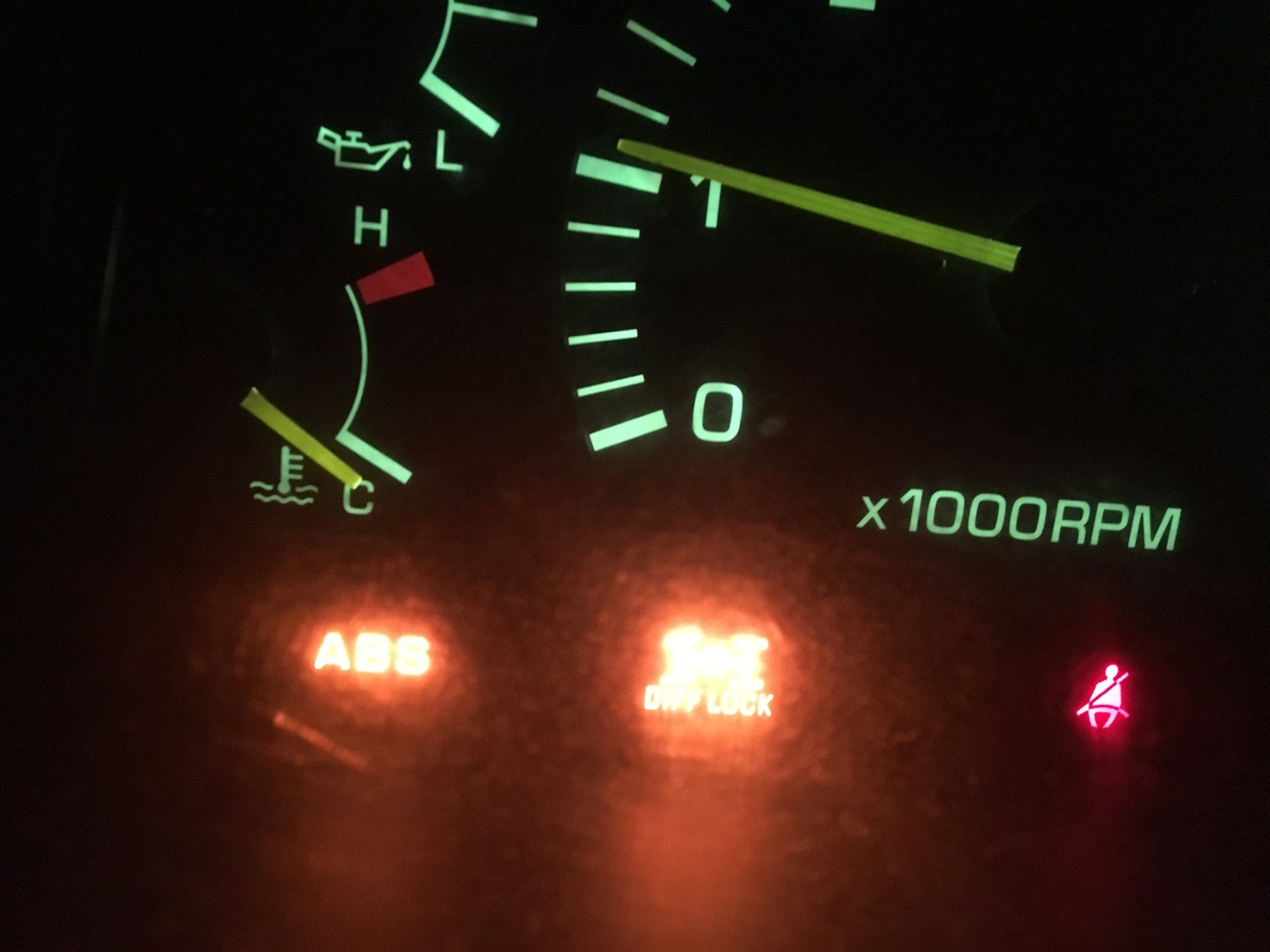

I received my new sensor today, so of course I swapped it out. What a BUGGER to get to that thing!!
4H with CDL switch activated.

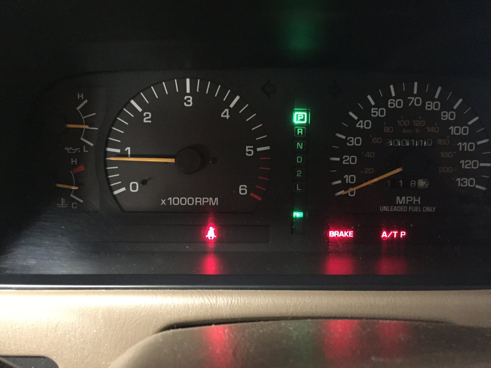

I also saw another light I’ve never seen before. A/T P:
I like that there is a light for when the truck is in "Go nowhere mode."
Also, I did test the old sensor and it read zero open and closed. I cycled it a bunch of times and saw nothing at all.
Is it safe to put contact cleaner on that thing?
I think the A/T P light comes one when you have your T/C shifter in Neutral or you do something crazy like me and have move the auto trans shifter to a location other than park to while starting it. Looking at your picture, I would assume the first scenario. Of course I my memory fails more and more everyday so I could be wrong.

Nice work!!!
Looks like you got it all sorted out...
Now it’s time to enjoy a locking center diff!!
