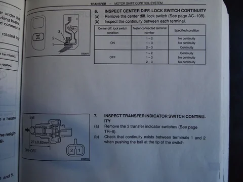

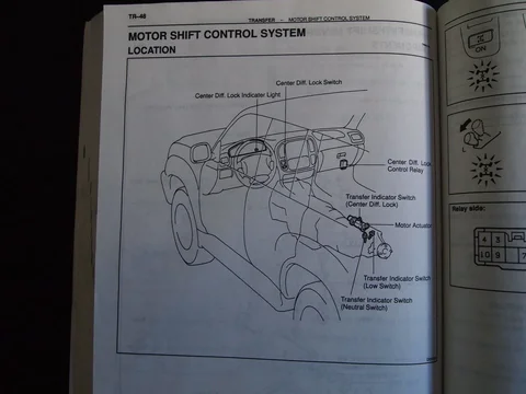

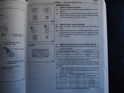

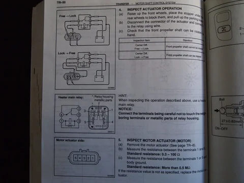

Perhaps this can help. Sorry I can't be of more help.
