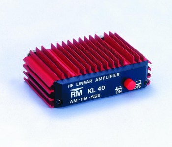

important component of that propagation range are the 100W amps that most of truckers have .. besides really well tuned antennas ..

Just remember that in the US - running an amp for CB is illegal and can net you a pretty big fine from the FCC. If you want to run power - spend a few hours getting your ham radio license and the $15 or so fee to take the test and get registered. You can then run 1500W legally (although I probably would not do that in a mobile installation)
