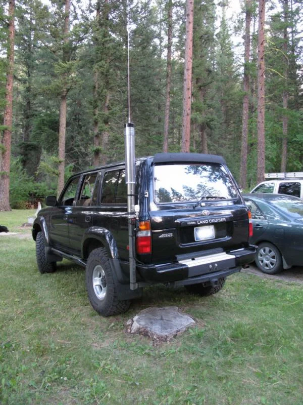

Just my little Scorpion 6-80 Meter. No holes drilled except into the side of the trailer hitch. :D The 2 meter antenna is located on the right rear NMO mount. I didn't have it on when I took the picture. Icom IC7000 Radio. I made contact with the Ukraine a few nights ago. :D
