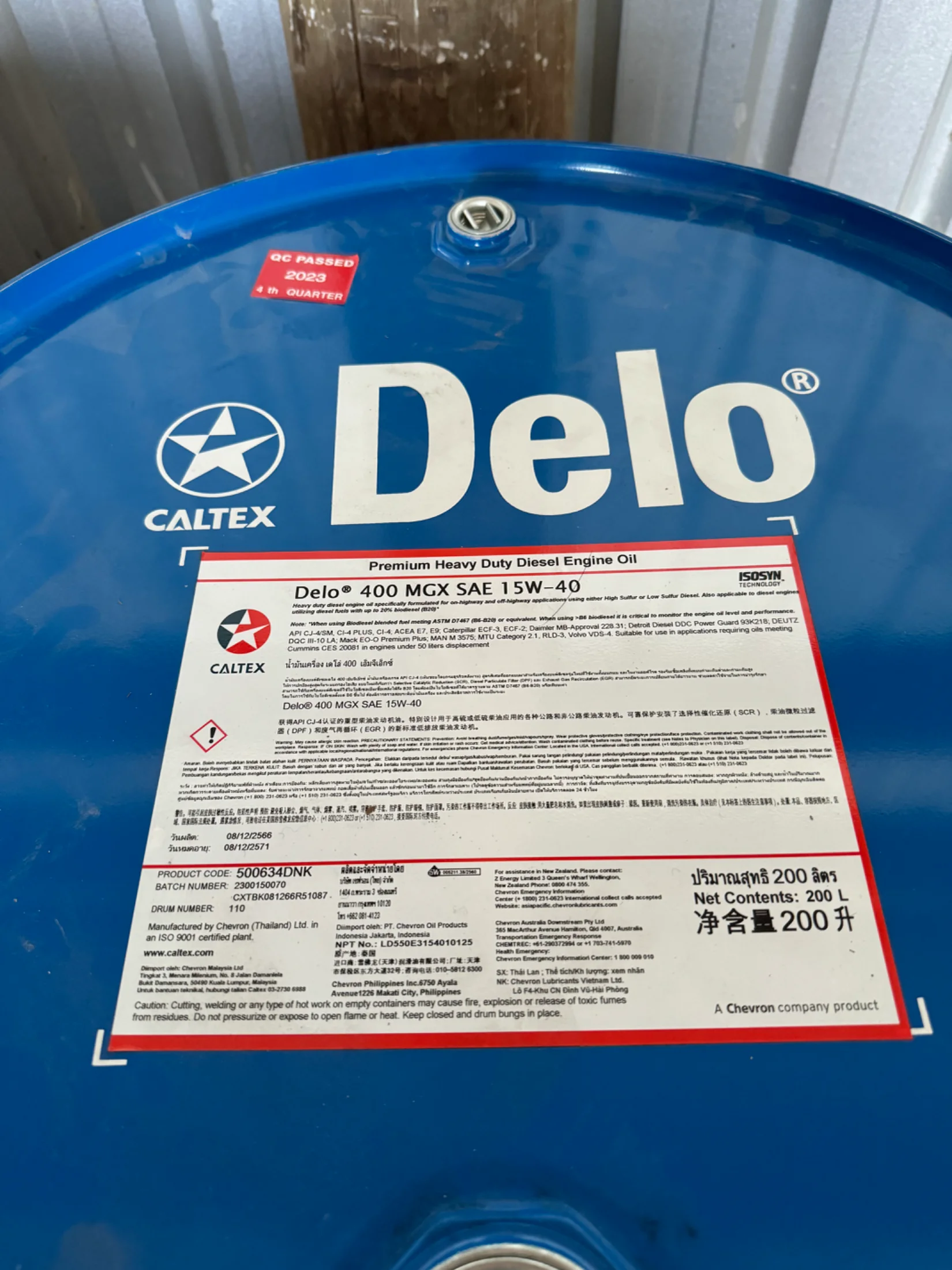

We can still buy delo here in NZ I figured for sure it would still be available in aus
Nice you can still get it there. It's not been available here for a while. A 200 L drum would rust out before I could do 20 oil/filter changes. 8-) My last drum of it purchased a few years back was a 20 L
