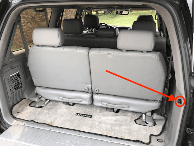

Curious if anyone knows the part number for this part, either right or left side. Or if anyone happens to have one lying around they'd like to sell. I only need one. Mine broke off and I can't seem to find the part number. A search on the forum only came up with this: Help on replacing cargo area trim panel pls
Not my 100 but I've highlighted the part in this pic.

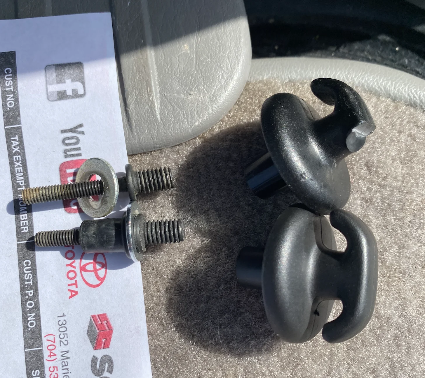

Hey all, just went through this rigamaroll myself for my 2003 Land Cruiser. I believe that for pre 2004 LC's this part simply isn't on the parts list/diagrams they use at the parts department. And like someone else mentioned, mine had the "PN..." part number on the back that is, in fact. a part number for a Ford Mustang Cargo Net (wth?).
However, my man Wayne at Scott Clark Toyota is tenacious and he did hunt down the right (Toyota) part: Part # PT347-60990-HK Photo attached. Along with comparison of old hook and new. The new one has a rubber end to it that just pops into the orifice and holds it there, versus the receptacle that was there for the old hook I had. You just need to make sure you extend the screw/post enough to have room for the threads to grab onto. Hope this helps the next guy/gal.

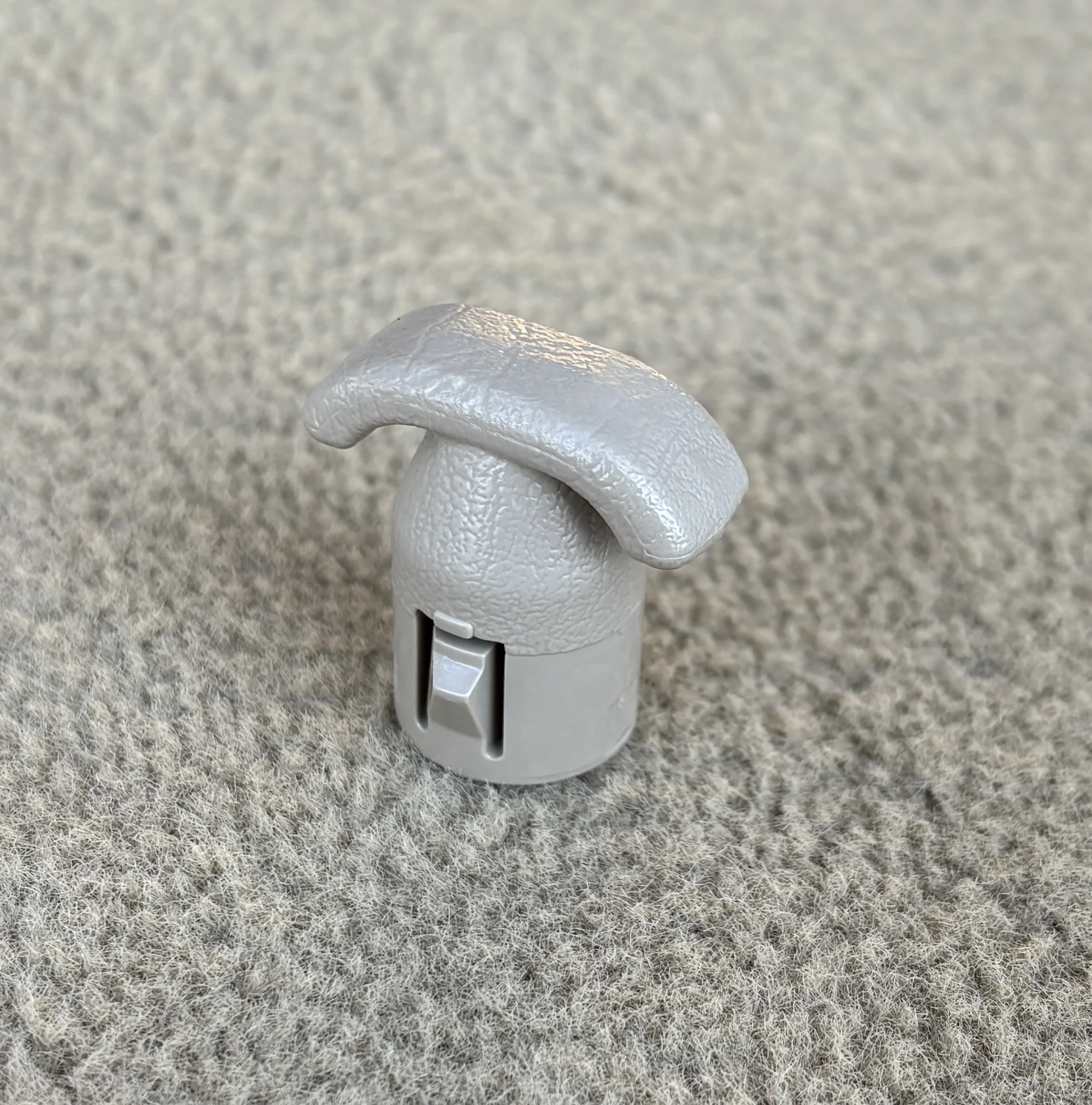

When I ordered these for my 2006 (stone) it was one PN for both sides: 6472560010B0

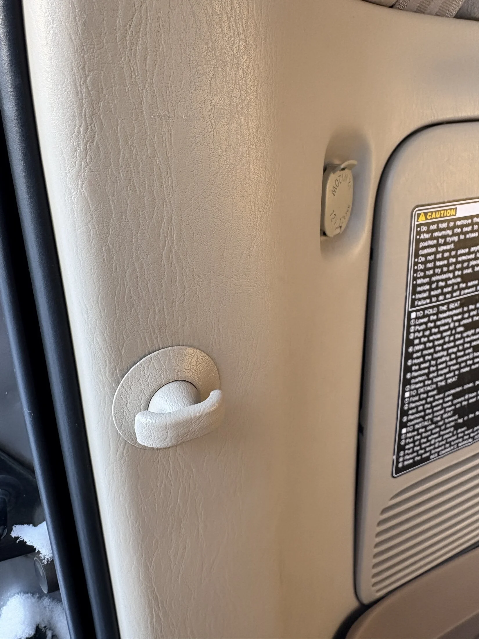

I thought I’d share photos and part number for the cargo net hooks for my 2005 LX470 which this part is the same for a LC. They have Ivory
64725-60010-A0 and Stone which is B0. The photos are of the Ivory. No screws or additional hardware needed if your 100 looks like this.
