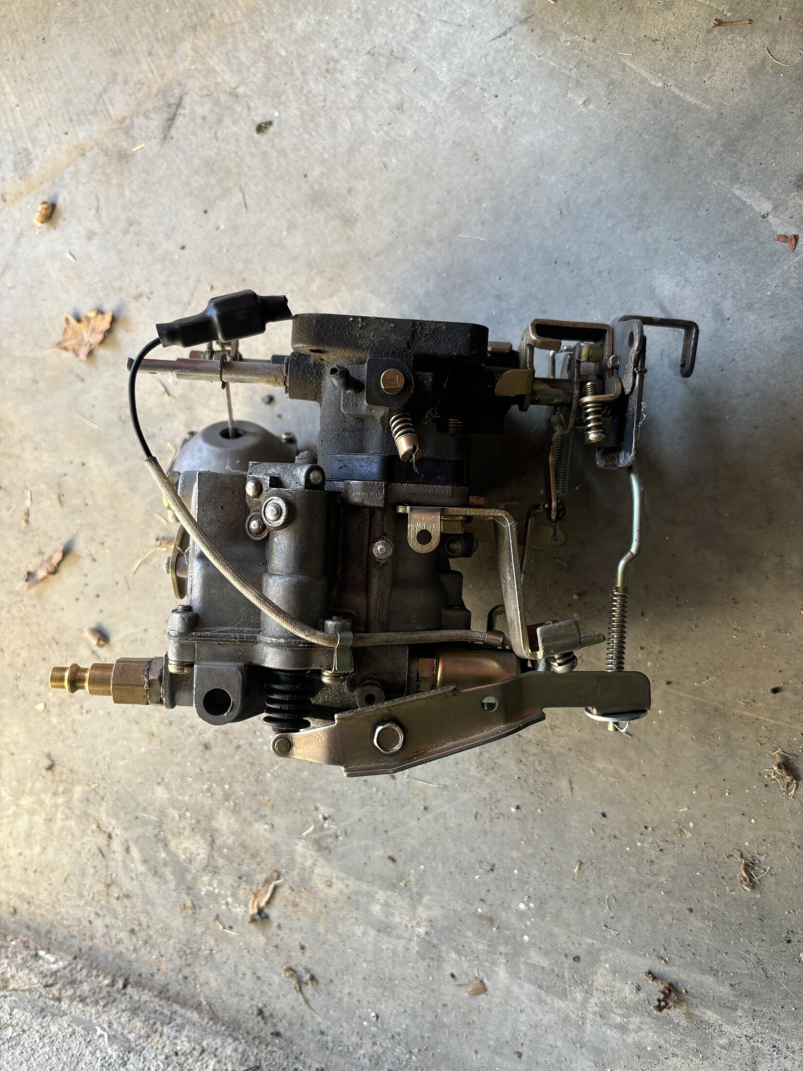

Hi guys/girls. Quick question:
I have 2 carbs that came with my 72 I purchased earlier this summer.
One of them ran great on the truck and the other came with a bunch of other parts.
Not sure if these are cheap ones I see on eBay or some of the more expensive ones I see for sale.
Pics attached;
Thanks!!
Interesting air hose connection on modified fitting - I don't think I have ever seen that before.
H3662 is a Fuji replica of the Non-USA, non-emissions Aisan carb. It works but you may need to work with it.
The hose barb threaded in is a cheap way to slide a rubber hose on for fuel.

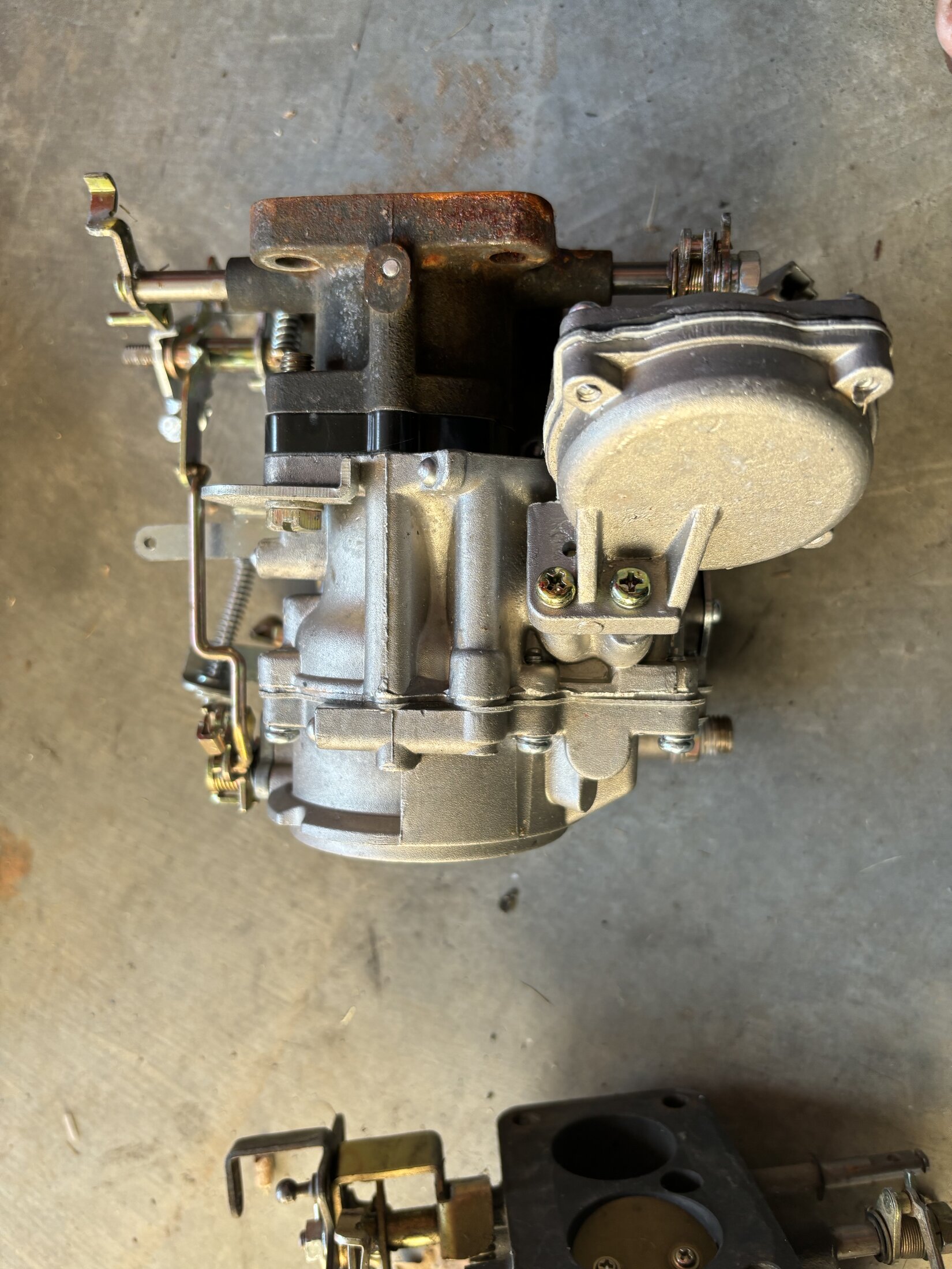

1. Pic 4 - Bent accelerator pump rod arm, just needs bending back.
2. Pic 2 - Tweaked hose barb for ported vacuum (on base).
3. Pic 2 - Linkage brackets look damaged/modified but it is difficult to see in the image. Can you take normal photos of the carb sitting on the base?
4. Pic 1 - Secondary kickup arm looks off in the first image.
5. Pic 1 - missing secondary kick up arm return spring.
Next time photograph them sitting on their base and all 4 sides of each carb....especially since you want assistance to decipher what you have.
They will work and can be saved - but it depends if you are a tinkerer with time on your hands.
