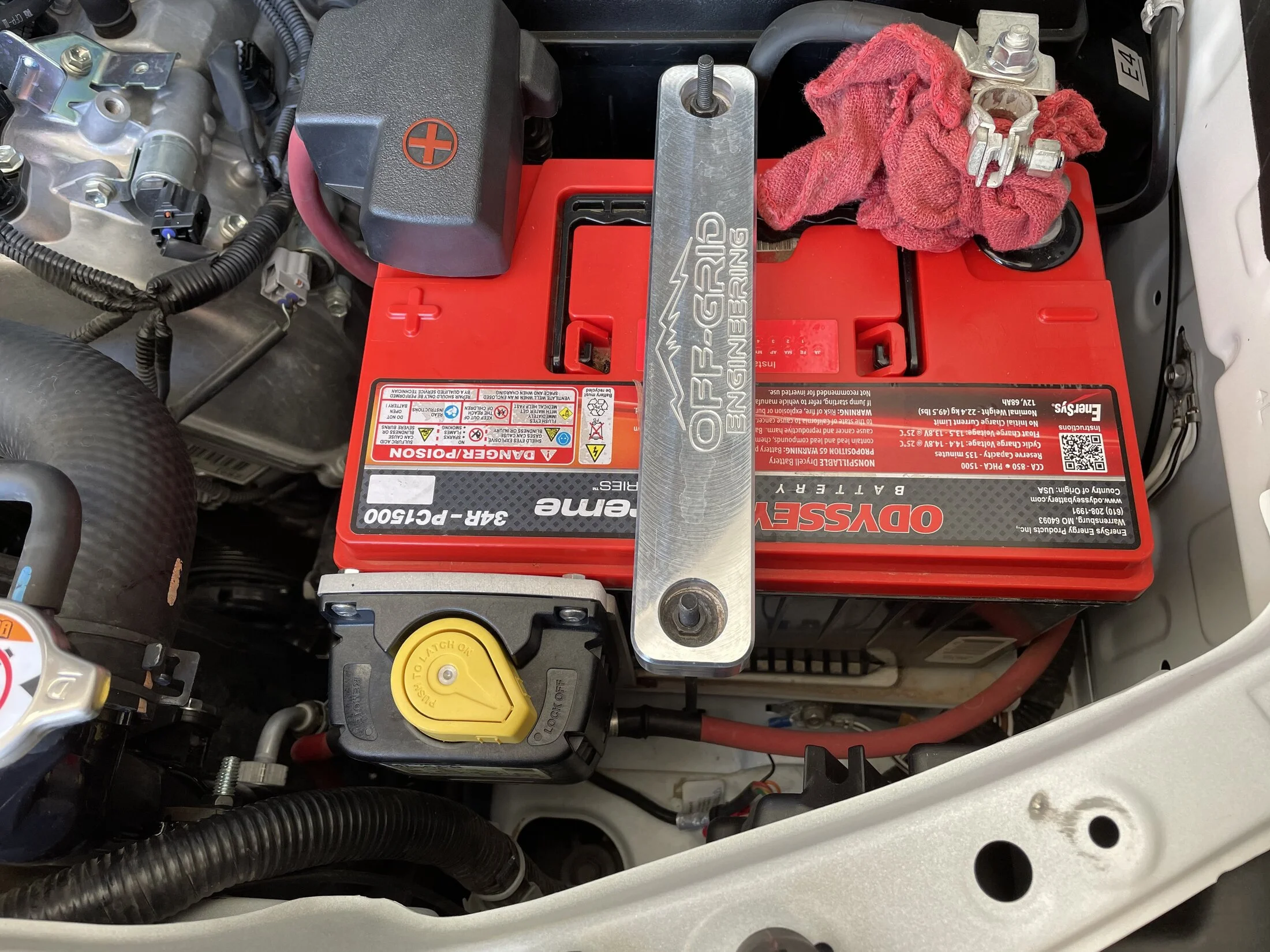

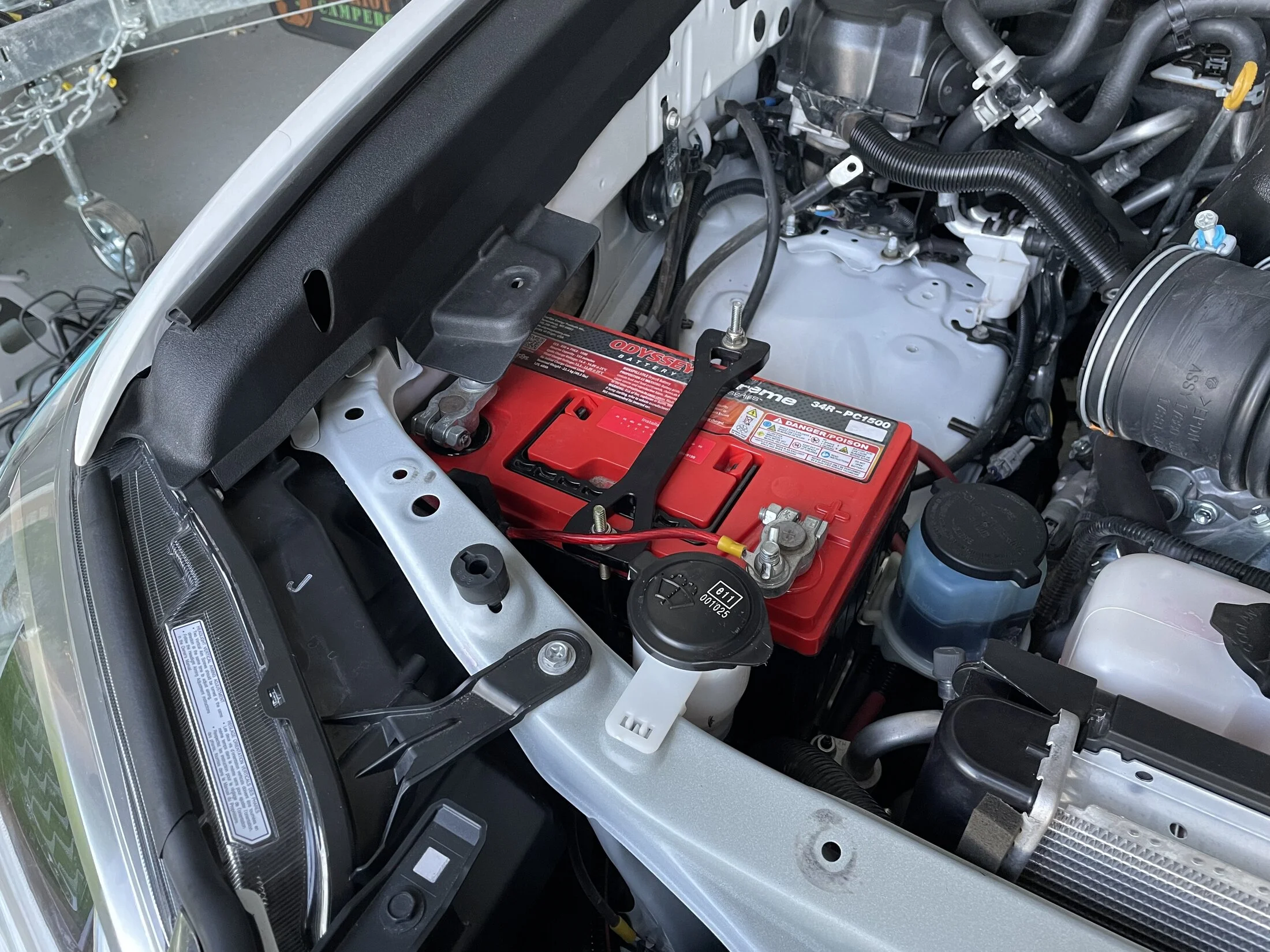

Here’s my set up:
Passenger side is the fj cruiser bracket from shrockworks and drivers side is from off grid engineering. Batteries are connected with a blue sea systems isolator switch.

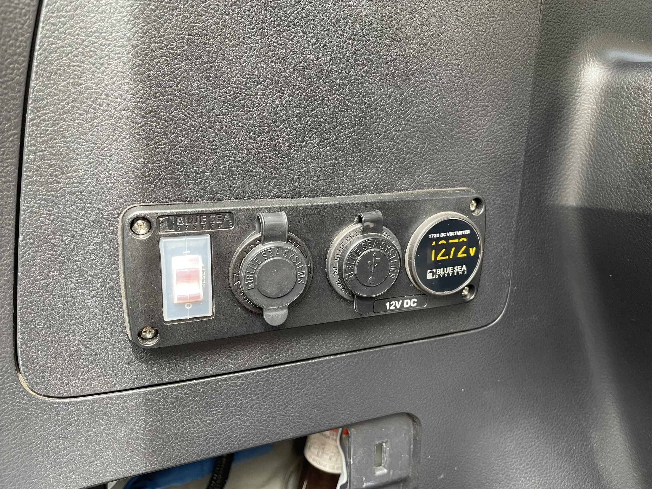

House battery is wired to an accessory panel in the back.

Here’s my set up:

Similar to my setup even down to having your power panel on the little access panel in the drivers side rear, But I have two Odyssey P1200 batteries in the factory location.

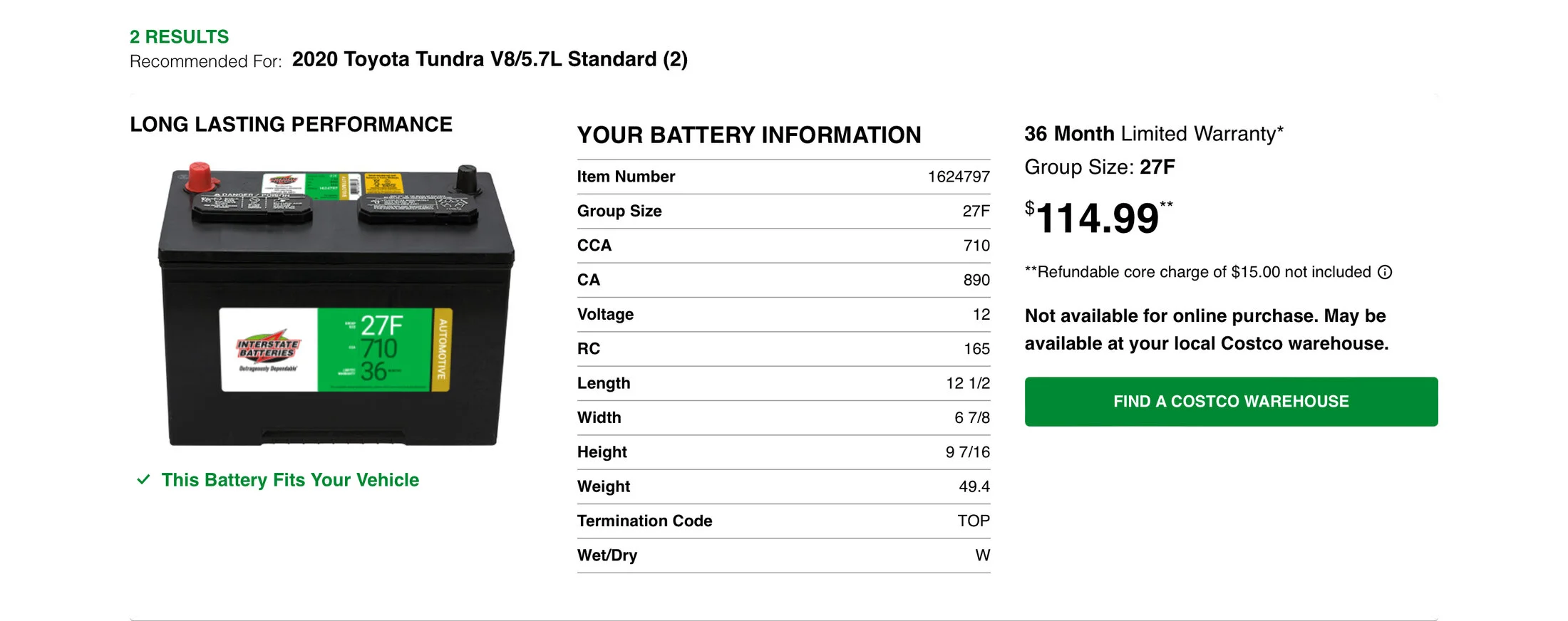

They're also outrageously expensive from the dealer. In the desert, batteries are a consumable, and anything over 2 years I'd on borrowed time. Costco ftw.
24f $69 walmart value if you are in the eastern seaboard only (guranteed east penn with no leaks). One year warranty, plenty of warranty centers.
Everywhere else I would jump into costco or any supplier of interstate batteries, possibly find a decent 27F.
