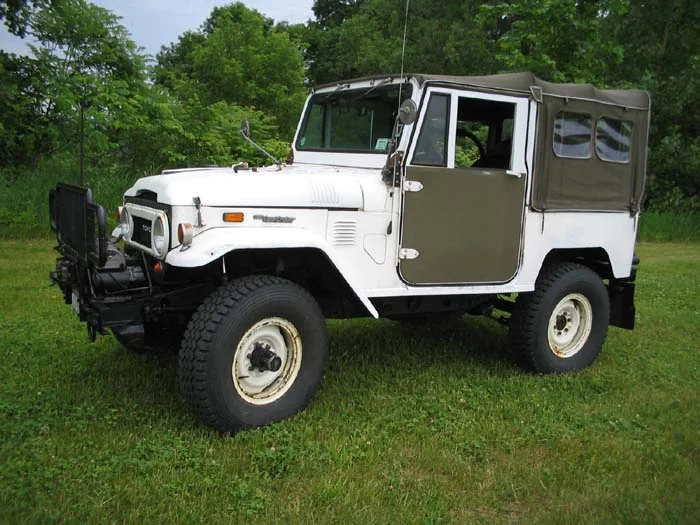

BigDaddy...BigRedFJ40's rig
love the look Chris ;)
get it back on the road Chris
Boy Johnny.... my rig sure looked good then. Dosen't look like that anymore since I rolled it:crybaby:
All in time she will be back together again......:frown::beer::D

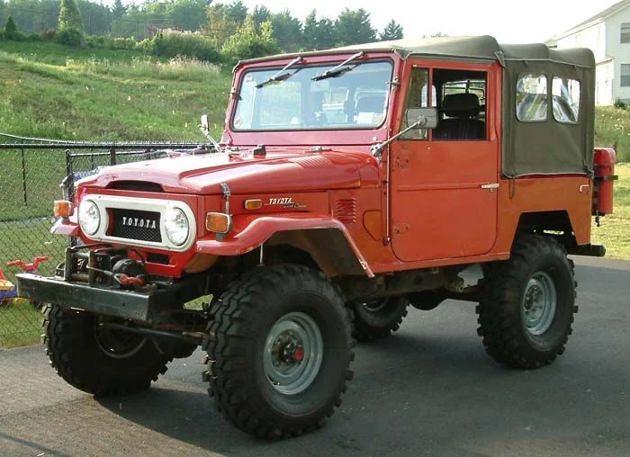

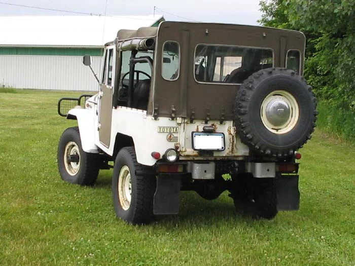

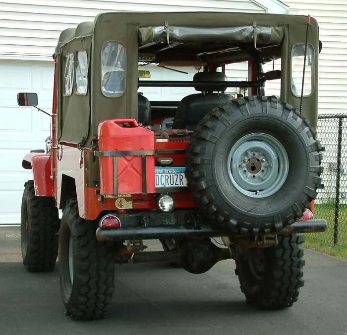

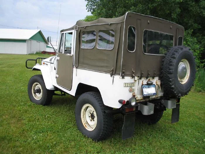

OEM canvas configurations i have seen come in:
1 window...no side windows ( van style )
3 window...1 in back, 1 on either side
5 window...1 in back, 2 on either side
7 window...3 windows in back (2 smaller 1/4 windows and 1 center window), 2 on either side (called the 'seven window' soft top some people call it the safari top...but have yet to see one on a safari rig :) )
and then the Ambi door soft tops
then you have zipper windows and/or twist lock windows
