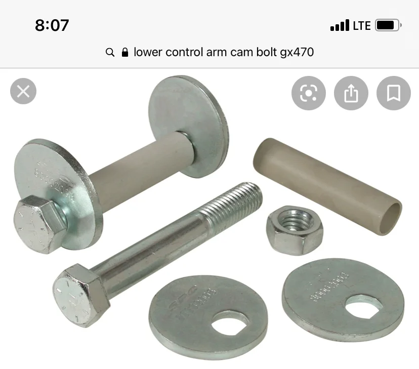

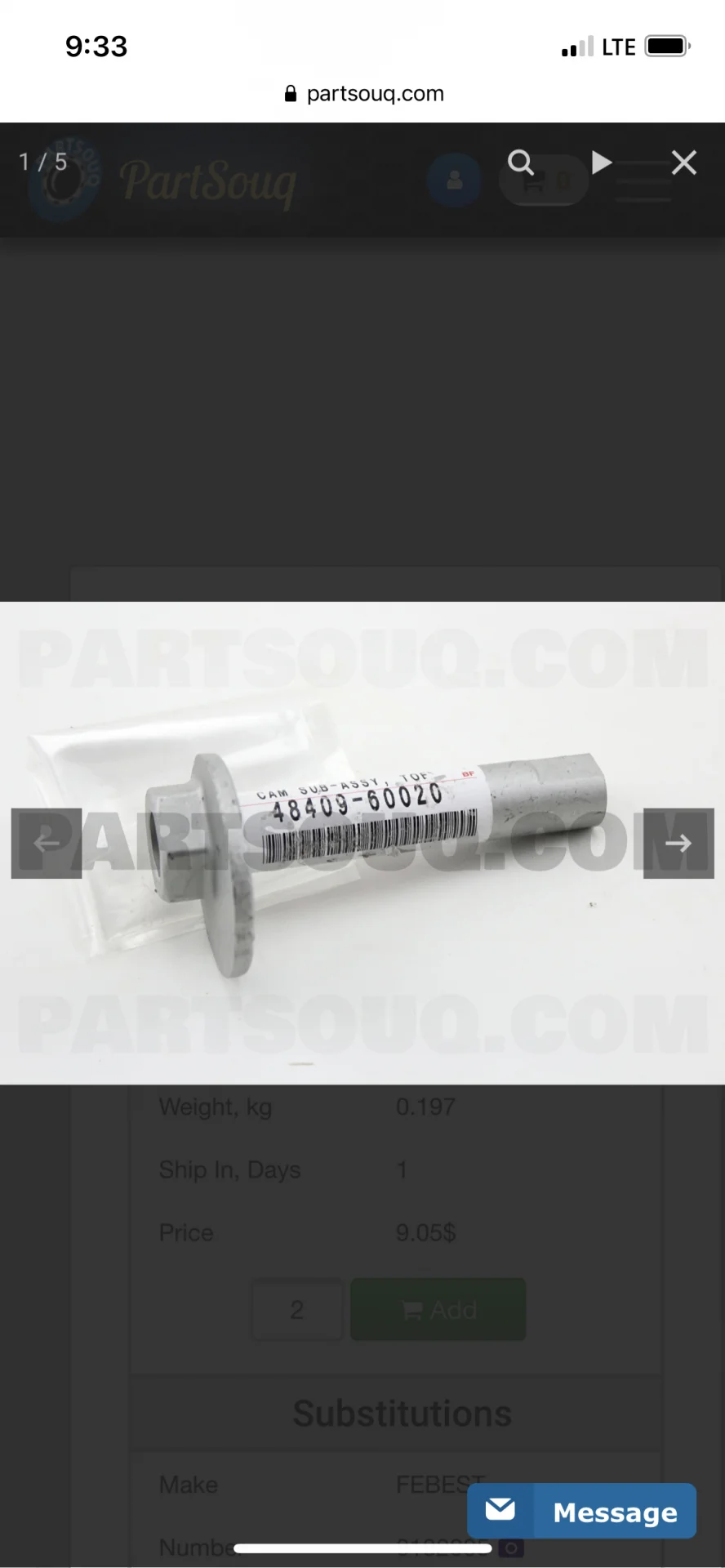

Looking at the generic replacements like your photo or at rockauto they look pretty insufficient compared to the OEM design. The OEM sleeve is one piece with the cam plate.
just FYI the front and rear bolt/ nut setups are different in the OEM setup
