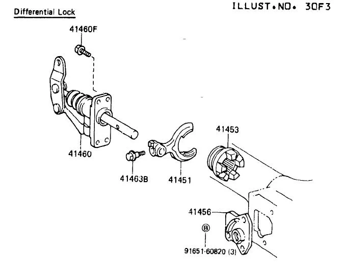

Does anyone have a Toyota publication number for a factory repair manual covering the OEM cable lockers and full floating axles from an HJ-61?
Or, how about an exploded parts diagram?

Roger that, however it doesn't have any info on the locking differential mechanism nor an exploded view. I'm trying to get a visual on how the actuating rod functions inside of the housing and gain a better understanding of how the internal mechanicals work.

Here's some exploded views from the parts microfiche
2mbb, you ROCK!! That's exactly what I was looking for - thanks! :D
