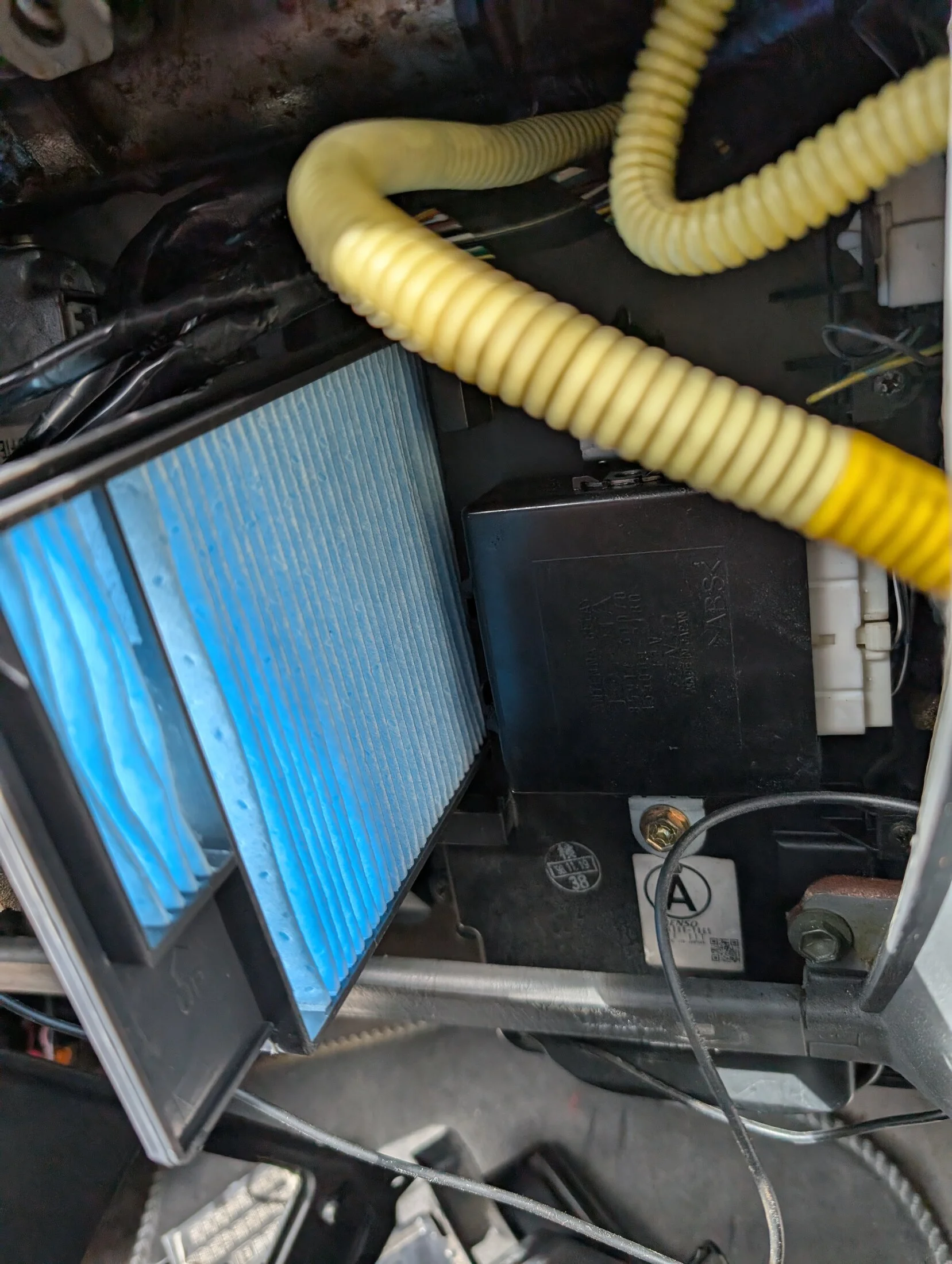

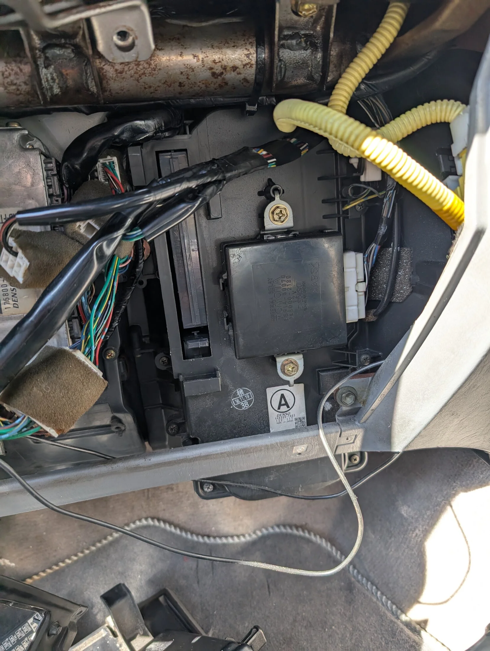

I checked my 99 when I had the gloves box off, and I've got the door for the cabin air filters nothing in there and I know I need a pair.
I've ordered some up, and assuming I've been sent the wrong ones as they are too long? I checked and thought I was correct, and the ones I have look the same as the ones in the video I watched on them getting changed, but still they are at least 50% too long
You can measure that filter and post here and I can compare but it looks like you bought a filter that is too tall.
It's a tight fit in there but one filter slides in and drops down and the other slides in on top of it.
Here is what I used in my 2002 LC and it works just fine.
Thanks so much! I was thinking I would just cut and carve to get it fitted and that makes a lot of sense now.
Awesome
Buying a filter of the correct size makes more sense lol but might as well get what you have working for now.
If you look at the previous replies, they don't make a filter that fits a right hand drive. Cutting is the only option.
