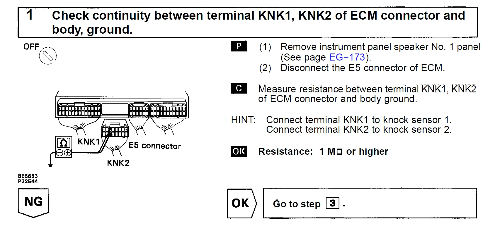

I've attached the list of diagnostic trouble codes and the knock sensors section, for your use, however, according to my 1995 FSM, there is no code 52. I've seen this posted elsewhere, so maybe I'm wrong about this, but I can't find a code 52 in my FSM anywhere.
I did find (post #24) that someone years back claimed to have bypassed the ECM, but his post is thin on useful details. The knock sensor section I attached will help you identify the ECM terminals that need to be shorted, if you want to try that "fix".

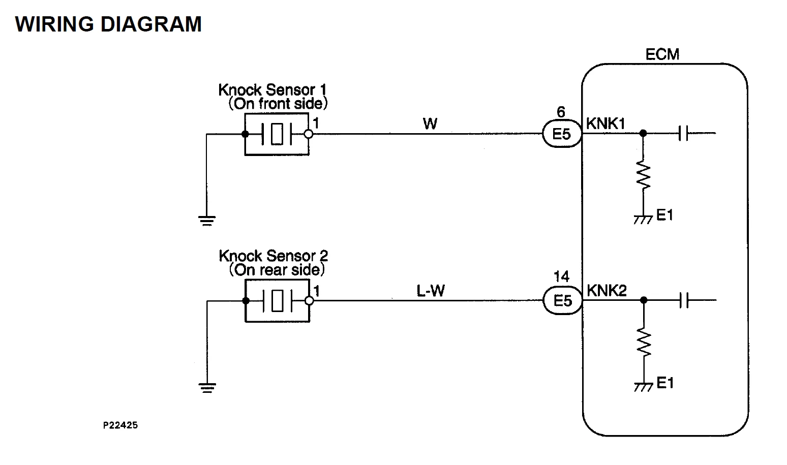

After giving this further consideration in the reading room this morning, I think you may be able to cheat the ECM by tying the knock sensors together, since they "report" to different ports (I assume this is what @jblaze was referring to in his post #24 above):
This assumes that you actually have one good knock sensor. As I said above, the sensor has to vibrate in order to send a signal, and the signal it sends has to be the right one.
You could install a jumper at the ECM, between terminals 6 and 14 (under the glovebox),
or at the engine side, between the two connector housings. The ECM jumper would be shorter, and, at least on my engine, easier to get to, but it wouldn't matter where the jumper was physically, as long as it was in the circuit.

tie them together it’s the same as obd2 get your fsm (93-94) from the link in my signature.
It has the electrical wiring diagrams all bookmarked.
Tie them together and see if that works
