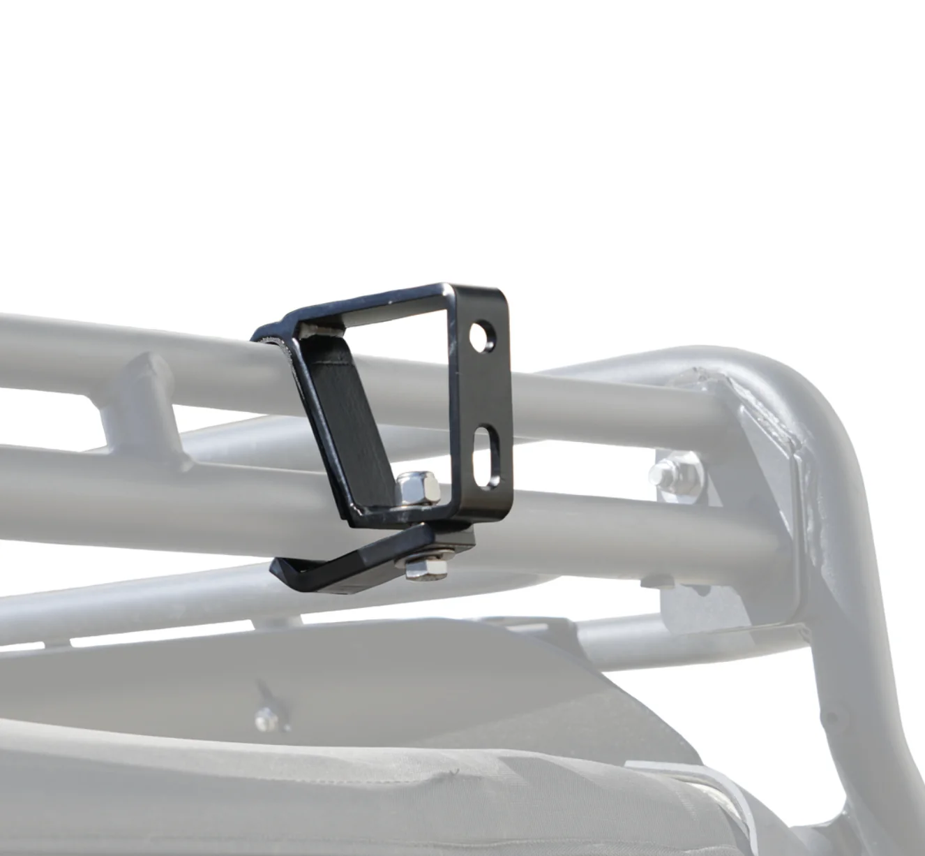

Kinda wonder if the Gobi brackets that attach to the outter tube steel will work (pict below) - guess it depends on how the holes line up. Gobi does say their brackets will work with the eezi-awnings, which per the website weighs about the same as the Bush.
The BushCo instructions specifically said “load bar” and not to just attach the awning to the side of the rack. The large BushCo “L” brackets extend onto the rack load bars about 12”. This provides a lot of moment resistance to uplift from wind and a lot of support for weight of the free standing arms. Maybe the Gobi tubular sides are stiff enough for the service but that bracket (IMO) doesn’t look like it would be adequate. I think you would at least need some custom brackets.

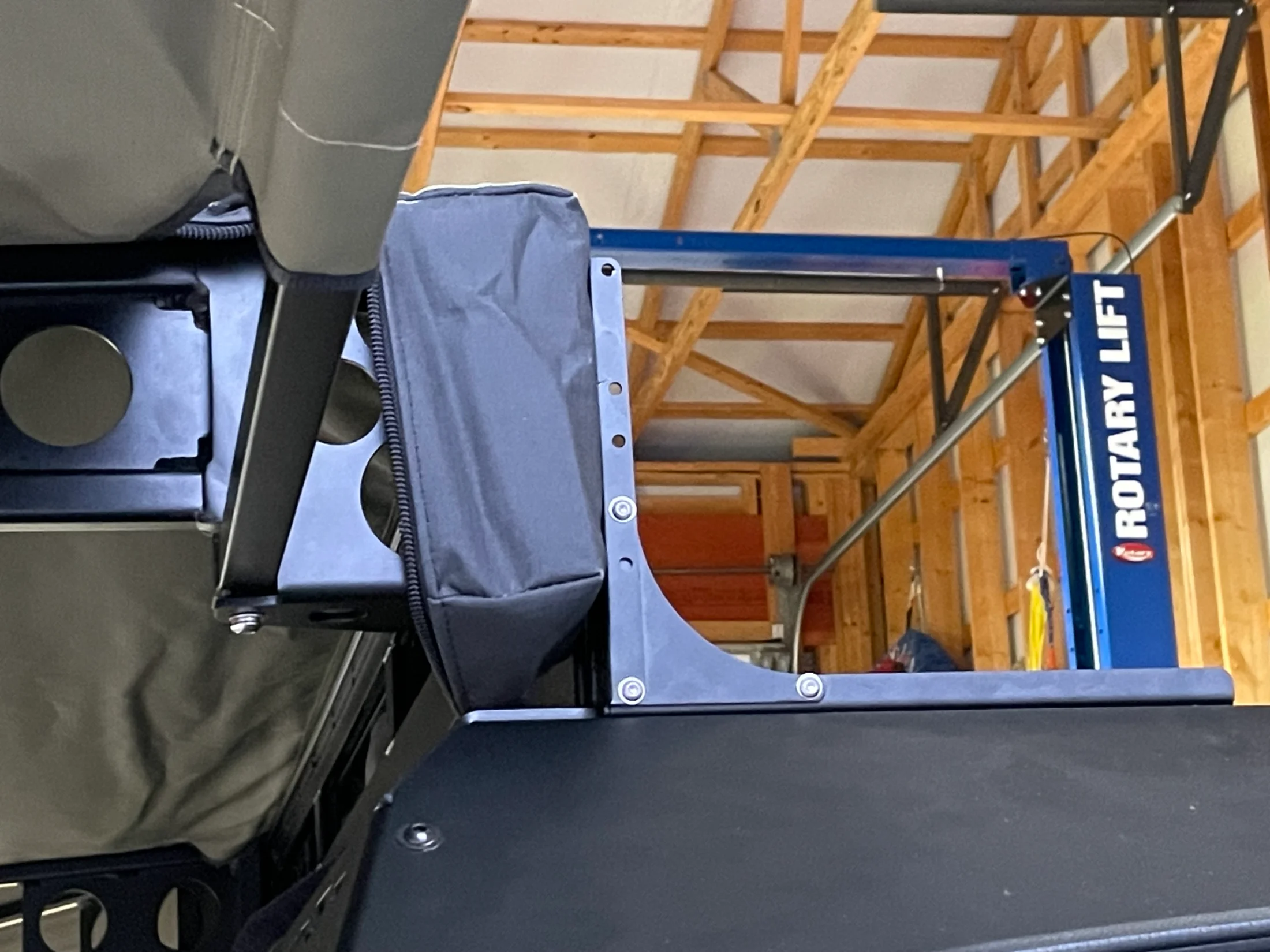

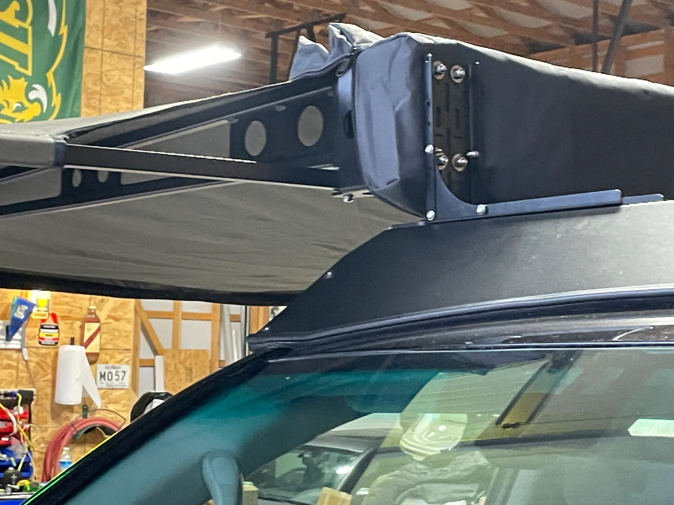

Here is mine on a Dissent rack. I want to adjust mine to lower is a bit and have it partially supported by the side of the rack. I’ve currently got 3 brackets and I will go to 4 when I fab new brackets.
