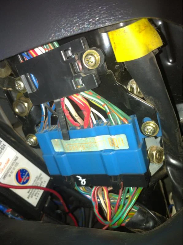

Ok had to take the truck out tonight, up the highway north, first night drive, I noticed a electrical/ plastic smell from under the steering column. The
large blue connector seems to get far too hot when on high beam! I'm thinking maybe a bad connection, ie high resistance. I will check my manual tomorrow but thought I would throw it out there to see if any one has a similar issue, my truck is a 88 gx hj61 so it has dual head lights. Does the High beam run via a relay? surely! I removed one of those dodgy insulation displacement in line connectors that feeds the spot light switch, it was very hot, not sure if it was hot from a HR or just because it was near the large blue connector, smell is less now but still concerned about how hot that connector is getting on high beam!
Any ideas

X2 on Erik's headlight harnesses!!! Our headlights ground through the headlight switch , old wiring, corroded connectors and high subsequent resistance.... Bang, melted plastic at the best, a dead shot and fire and smoke at worst... A cheap, cheap preventative fix, AND you get nice bright headlights out of the deal!!!
What's not to like?
