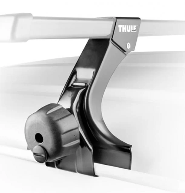

i picked up some used Thule raingutter style mounts on craigslist for cheap. They work great and have locking cores in them. Thule uses rectangular roof bars that slide into the mounts. Everybody else uses round bar which is stronger. depends on how much weight you will put up there.

.... Thule uses rectangular roof bars that slide into the mounts. Everybody else uses round bar which is stronger. .....
No, just the reverse as long as the square tube's sides can be orthogonal to the direction of the force(s). It is only when the direction is unknown or from many angles that round tube is preferred over square tube.
