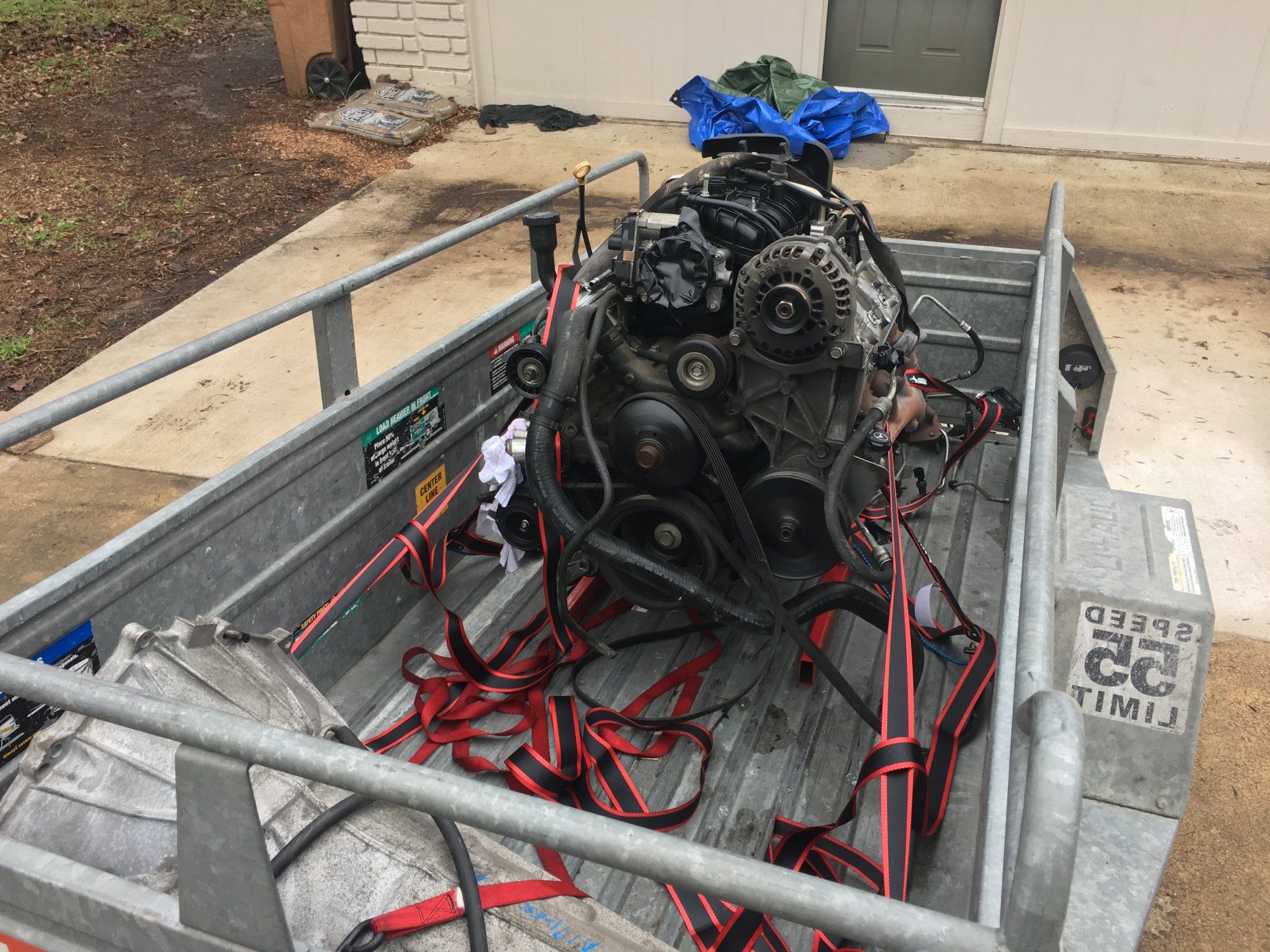

I found a wrecked 2008 escalade at a junkyard in Houston, and had them pull the engine/transmission/accessories/harness/pedal/BCM/ECM/etc, and I went down there and grabbed it. 120k miles, probably not the best maintained, but these L92s aren't easy to find and I will deal with any reliability issues with a likely rebuild eventually.
