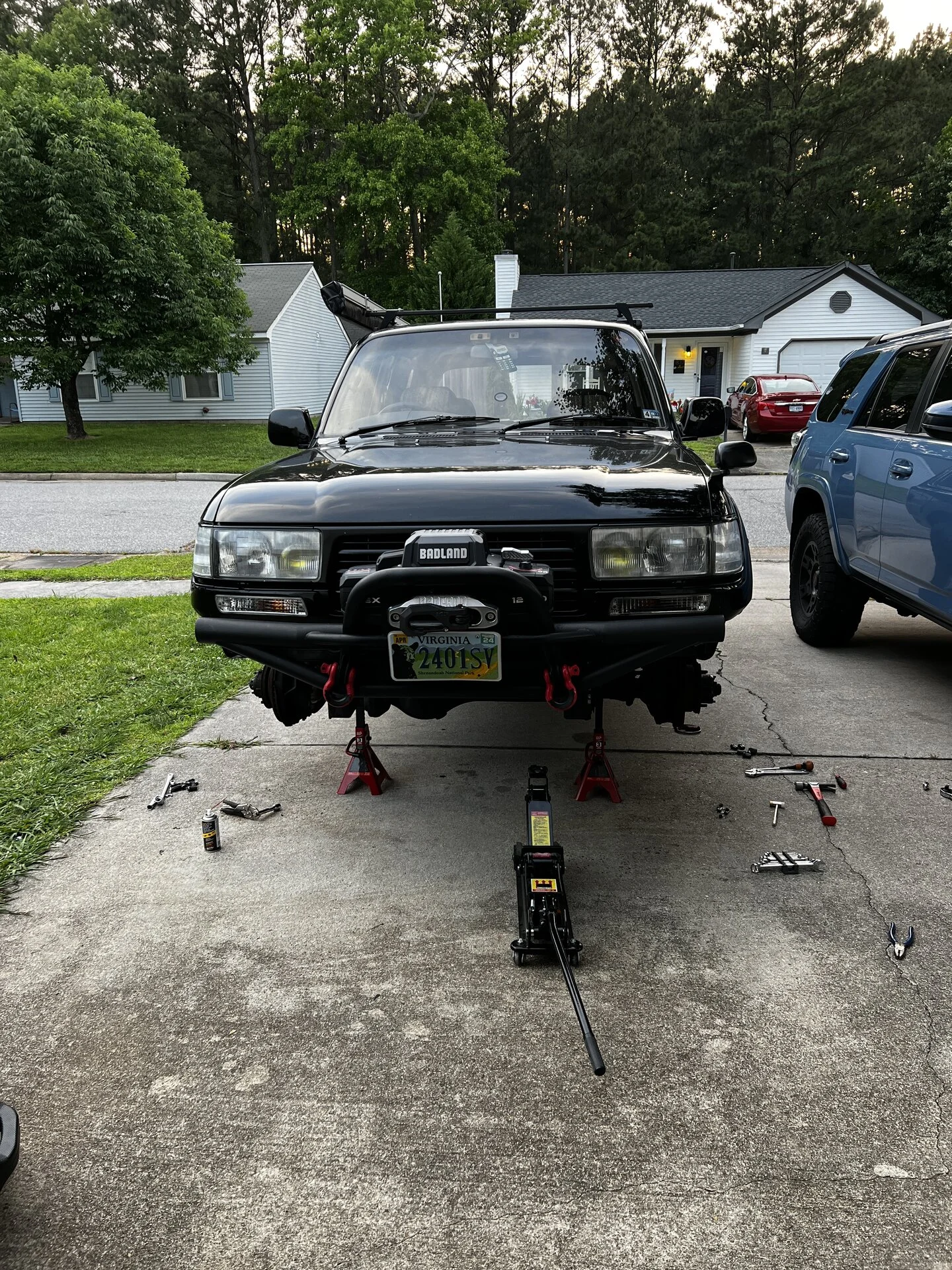

Also ran into issues with the front end, which came up due to state annual inspection. They failed it for “bearing play”. Upon my own inspection, the lug nuts were severely loose, but there was also a bit of bearing play. So we ended up here…
Upon disassembly, the 54mm nuts were loose as could be, thankfully the lock washer did it’s job.
The hubs were also dry as a bone. Whole situation ticked me off, since Toyota in Japan did a full BIRF rebuild on it two years ago before export.
Ordered all new hardware, dumped a tube of grease in both hubs, torqued the nuts to spec. Shout out to Family Adventures Overlanding for the great video on tightening the bearings (tighten, spin, tighten x3-4, half turn out, tighten to friction).
Spins smooth as butter now, not a hint of play.

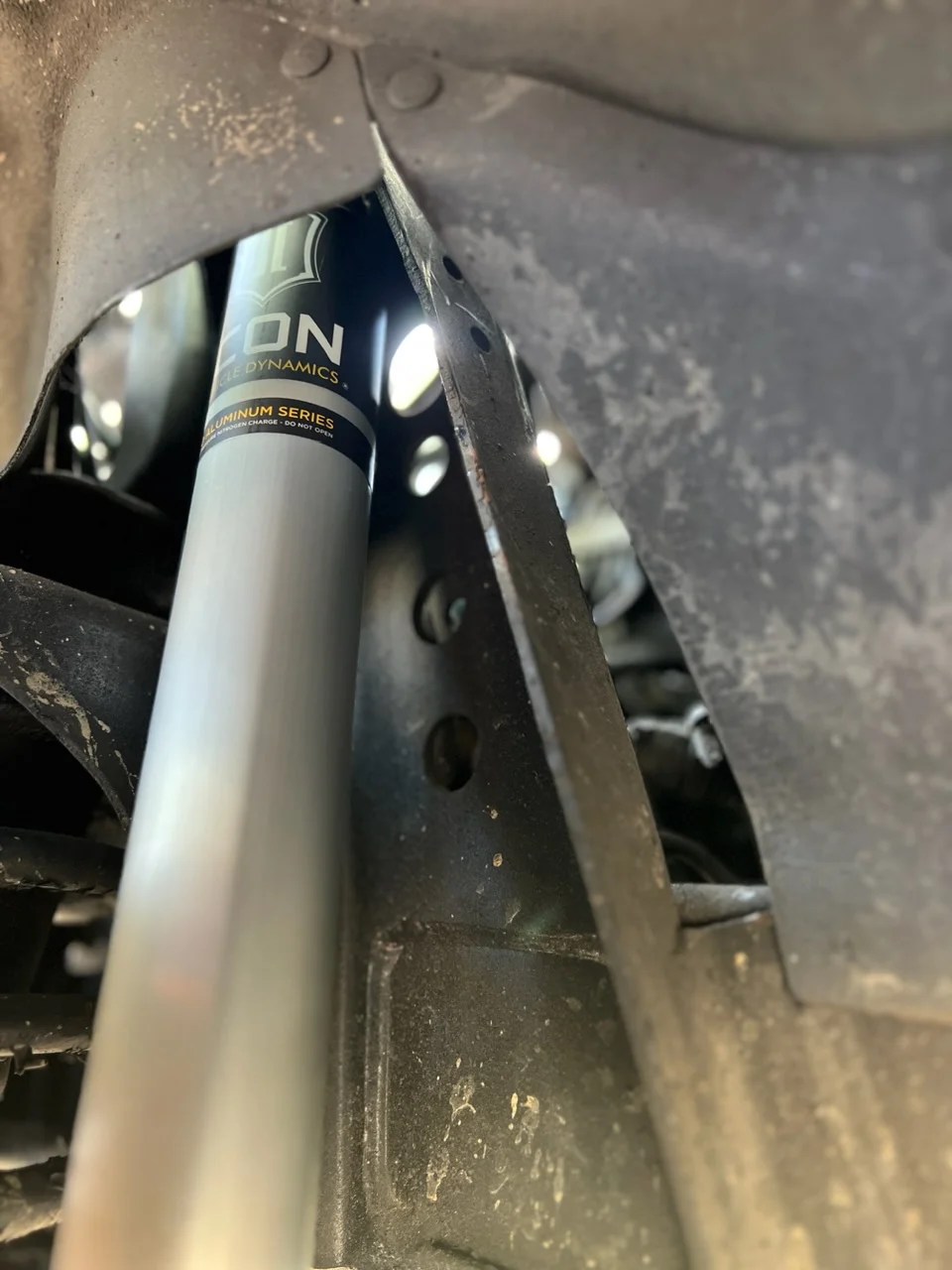

Out with the old, sad, dampless Pro-comps…
In with the new…
A lot of consideration went into shock choice. Budget being one of the top constraints, BP-51’s and Dobinson MRR’s were out. In the sub-$200 per shovk range, not a lot of them were rebuildable, and this was a big ahock consideration in the choice.

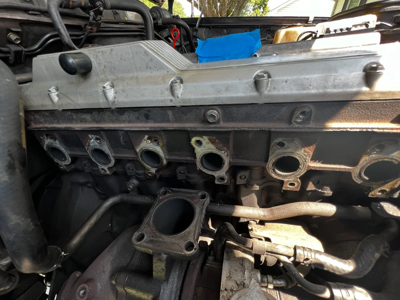

Presoaked the header nuts/studs for about a week before attempting to remove them.
Seems to have paid off, a few bleeding knuckles but no broken studs or rounded nuts. Even with the soaking, many required a propane torch as well, especially the less accessible ones.
No signs of a leak, but either way, all new studs and gaskets will go on.

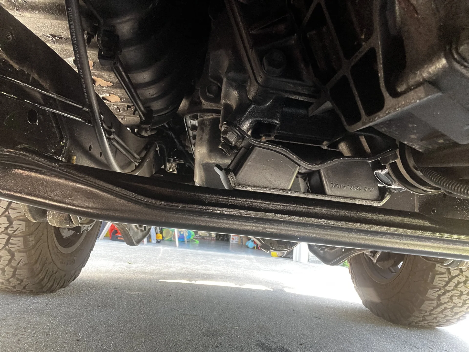

Was mandatory to remove the front sway bar, helpful to remove the steering damper, skid plates.
Highly recommend changing the transmission mount if you have not already. Made an instant improvement in the vibrations and overall quality of drive, for what can be a 30 minute job.
If your cross beam bolts are rusted, spray some penetrant on a few days before you do the job. Mine were hideous, but came right off after sitting with PB Blaster.
I did not go genuine, if it fails its an easy swap. Motor mounts will certainly be OEM though.

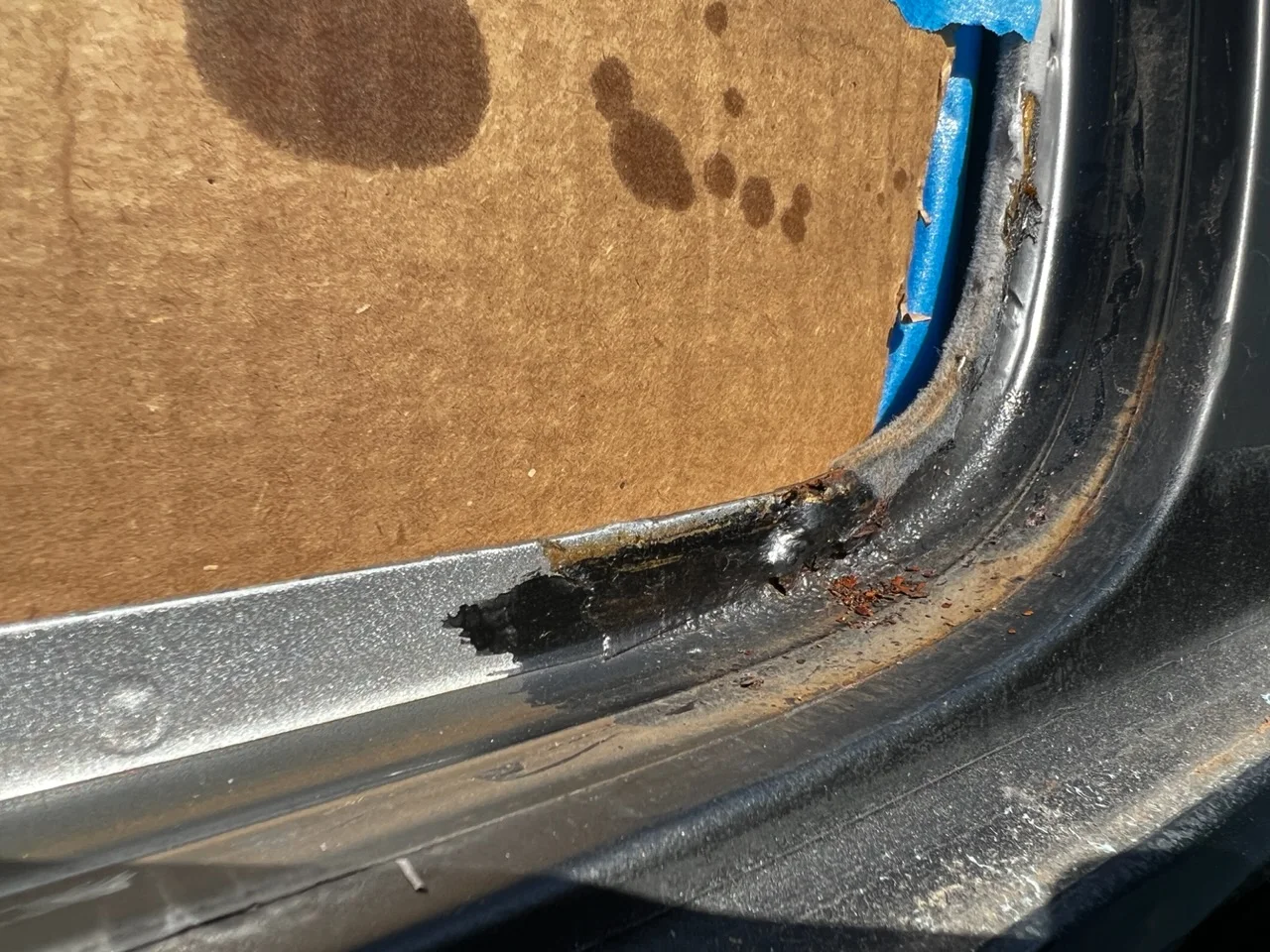

Sorry to see your truck being sold. Japan is a great place. I used to frequent western Tokyo quite often when I was married, even took the kids there as babies. Good luck.
I'm curious why that is such a common spot.
What's it take to pull the window? I need to work on that this summer
