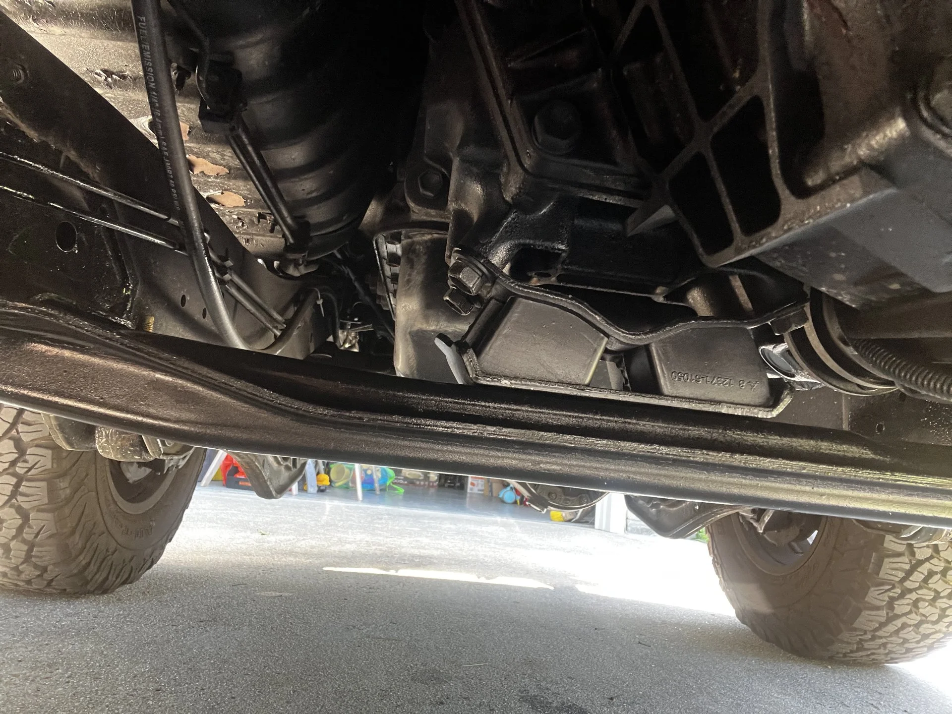

Highly recommend changing the transmission mount if you have not already. Made an instant improvement in the vibrations and overall quality of drive, for what can be a 30 minute job.
If your cross beam bolts are rusted, spray some penetrant on a few days before you do the job. Mine were hideous, but came right off after sitting with PB Blaster.
I did not go genuine, if it fails its an easy swap. Motor mounts will certainly be OEM though.

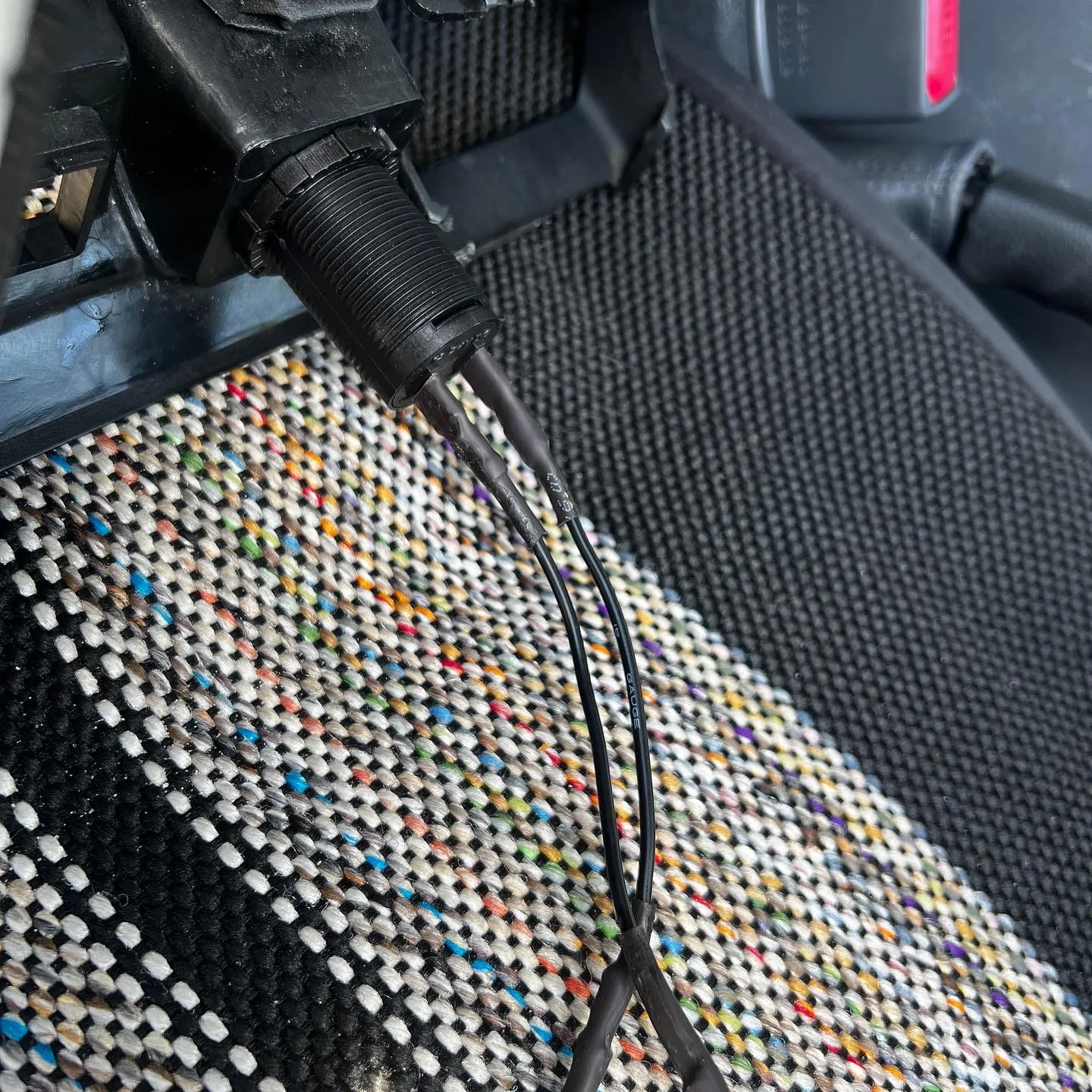

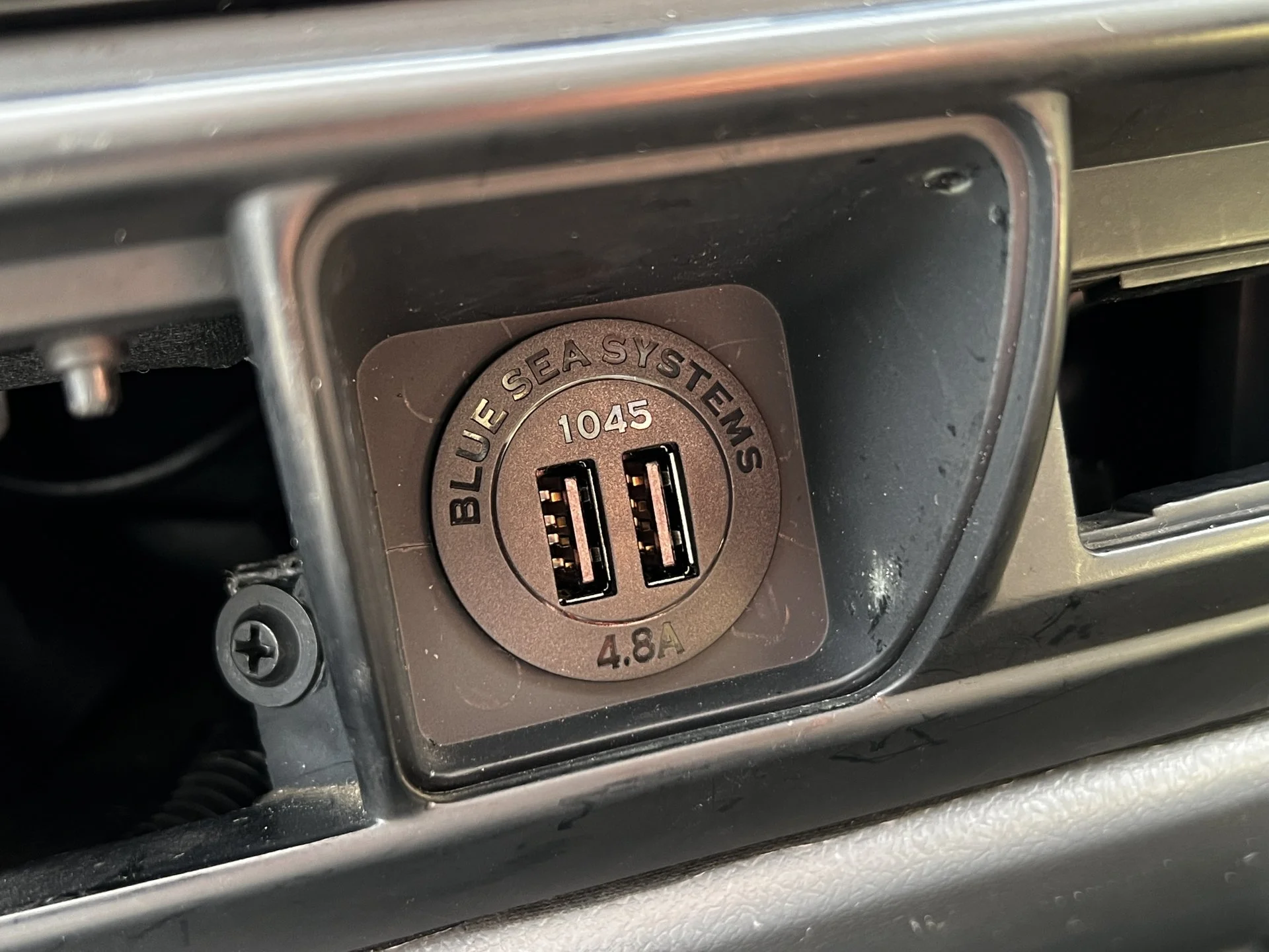

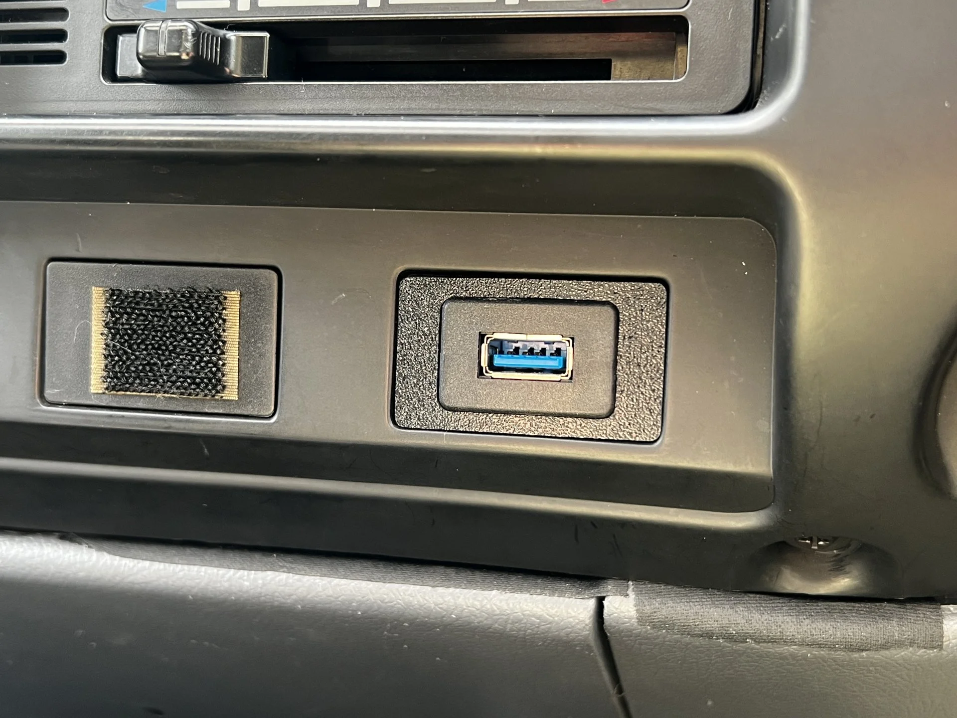

Update on the electrical setup, got some goodies in from Blue Sea and Solvefunction.
Fuse block, wired directly to the USPS battery.
Used this to provide power to the new head unit, and hopefully relieve some load from the dome circuit.
Blue Sea double USB, replaced the cig lighter, used blade connectors to keep stock plug.
Solvefunction USB port to provide wired Carplay function to the head unit. Great fit and build on that little piece of gear.

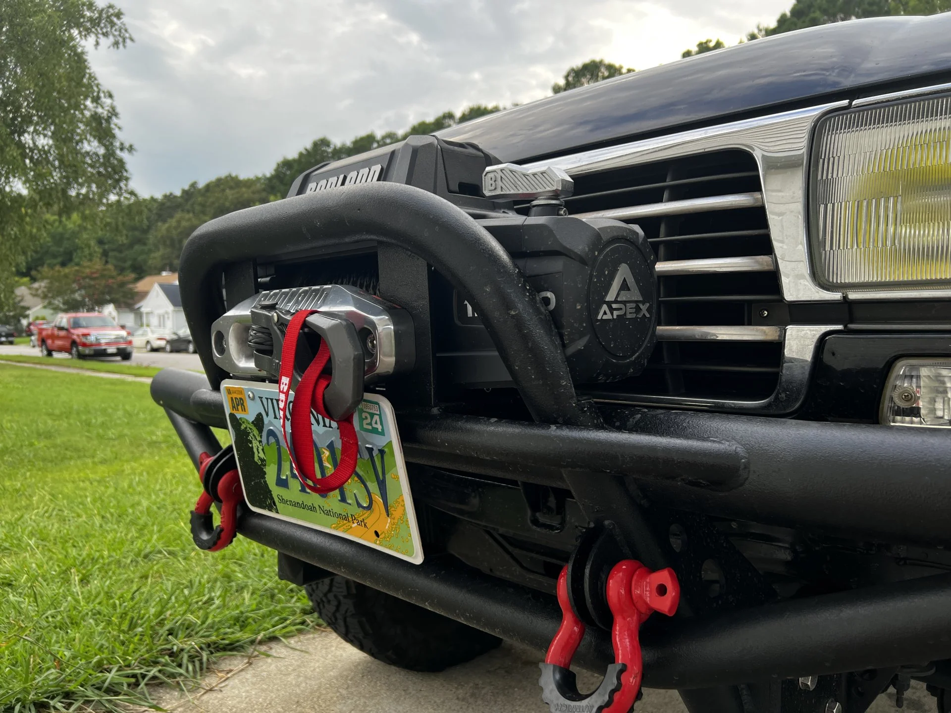

Finally completed the winch mount not too long ago, its been obscenely hot here day and night, mixed with thunderstorms, so progress is slow.

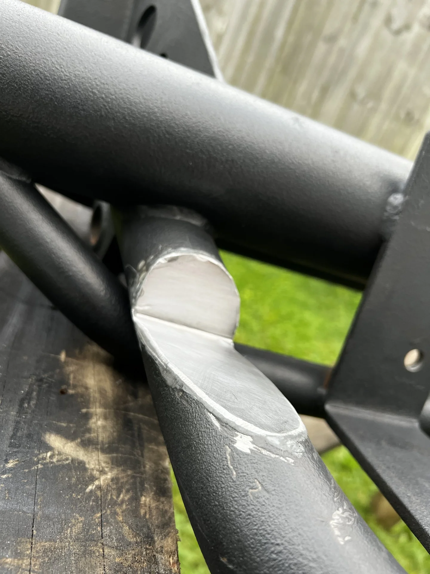

The Badlands 12k winch was a bit bigger than the bumper was designed for. I took it by a weld shop with the intent of having them weld a new mount plate about an inch further back, but we decided it would cause more issues than it solved. In the end I decided to notch the bumpers stinger to accommodate the winch.
Mocking up for fit.

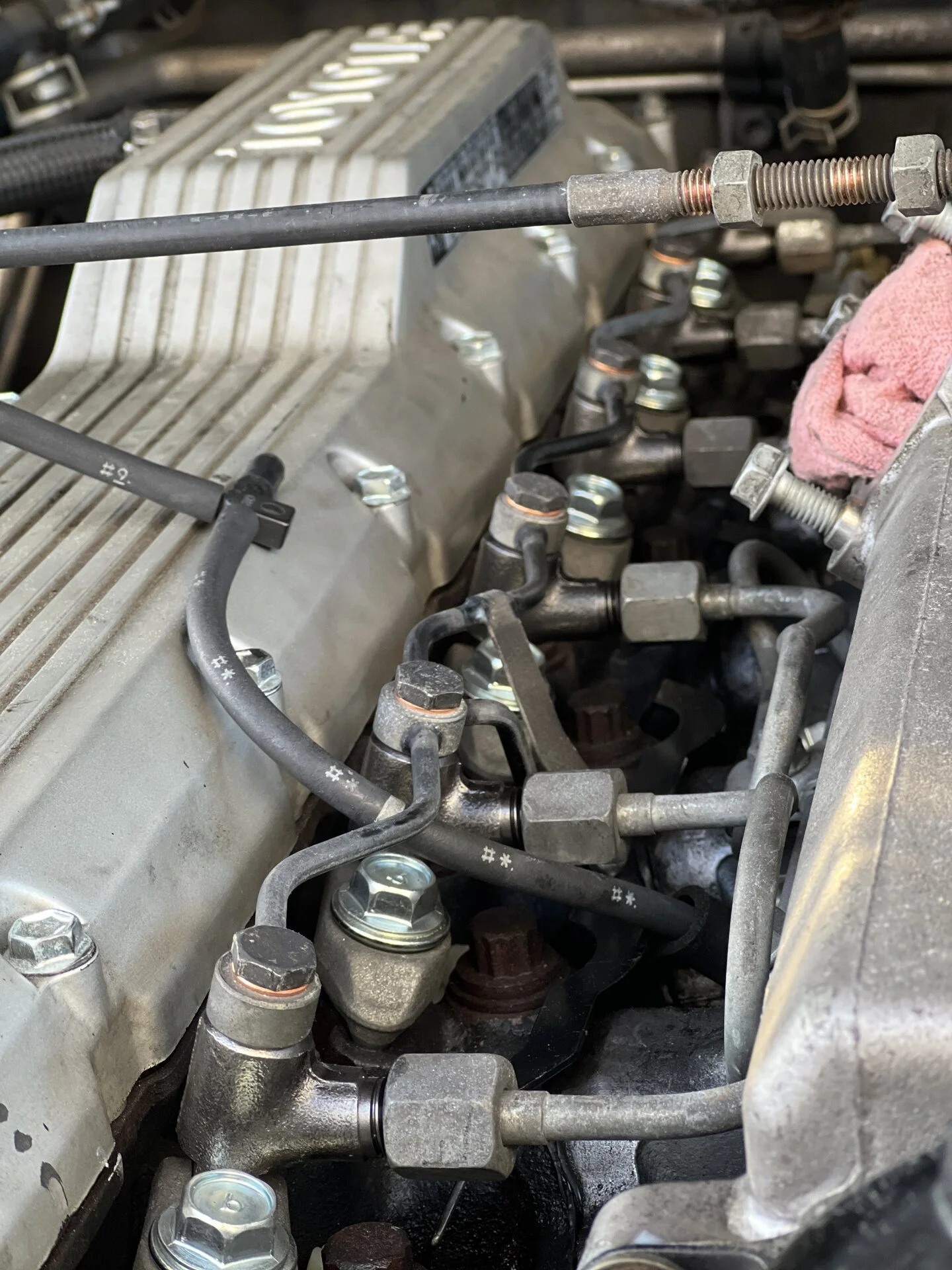

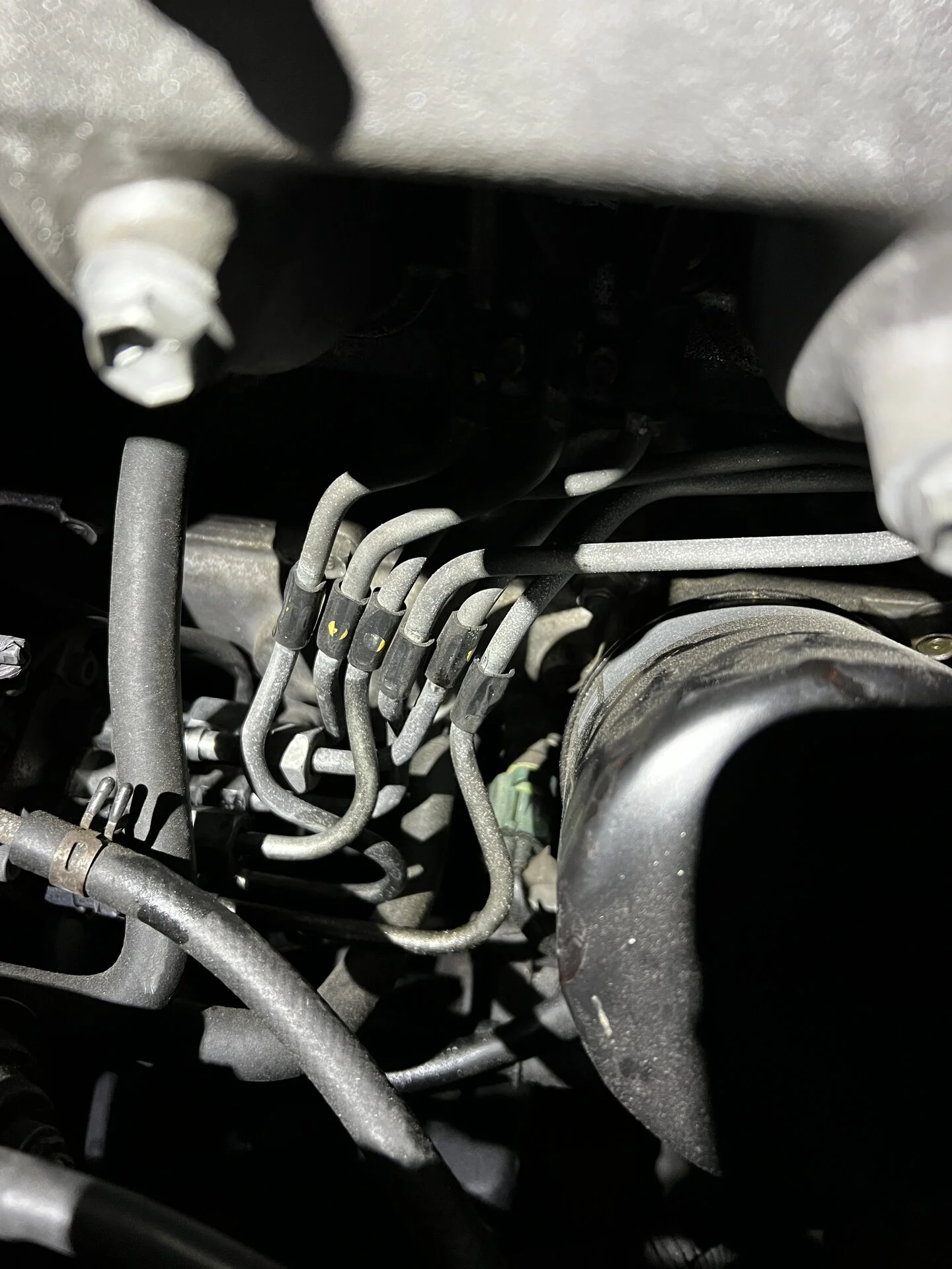

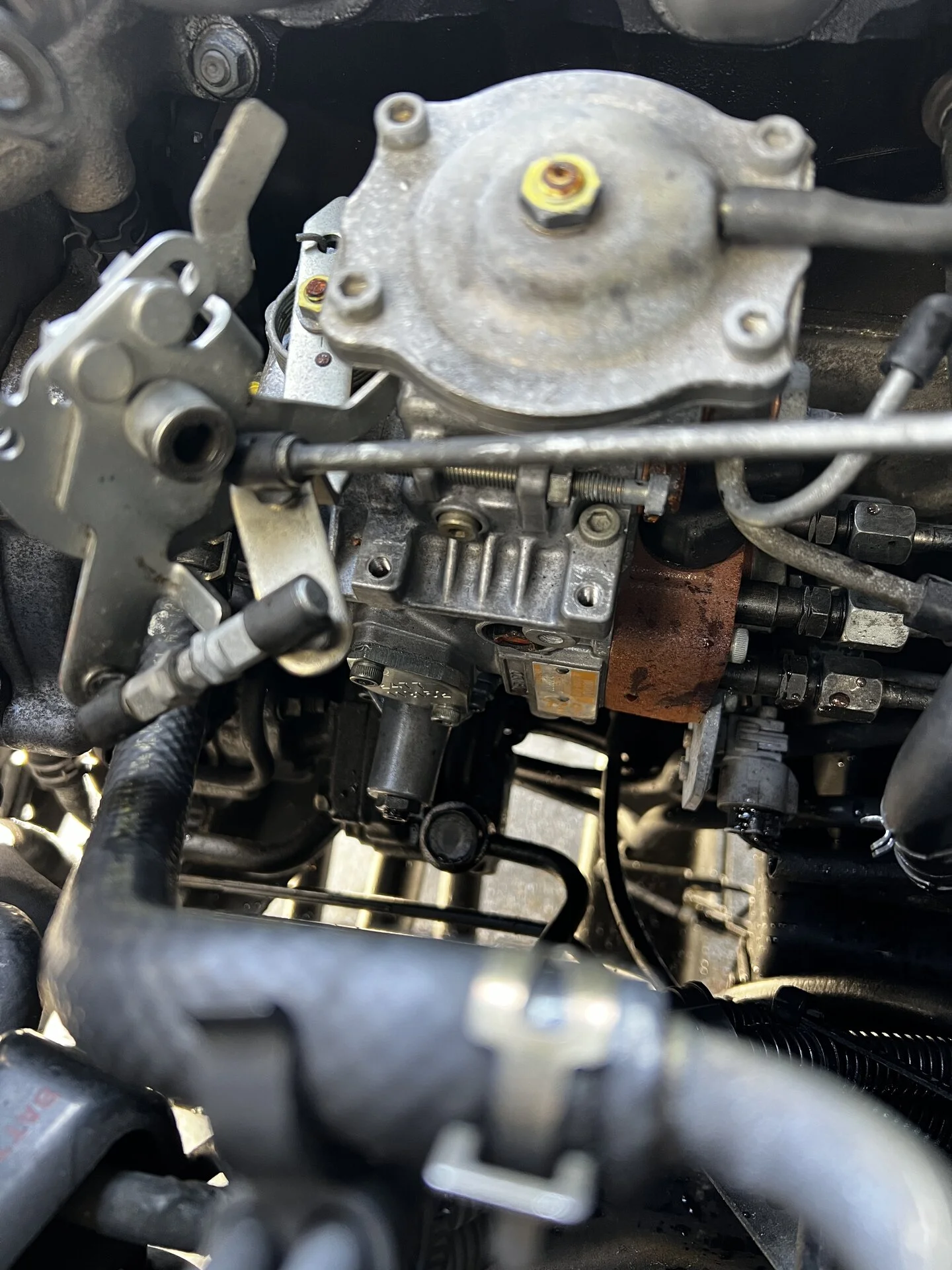

Working through a pretty extensive top end refresh, injectors, a lot of hardware, manifold gaskets, and now that I broke one… glow plugs. More pictures to follow.
Getting ready for tear down.
I got enough flexibility in the fuel lines to replace the manifold gasket and hardware by removing this bracket and loosening the top two fuel lines at the IP.
Got the injectors back on Saturday from DFIS in PDX. $656 for the testing, replacement of all 6 tips, rebuild, and retesting/shimming. Two tips were hopelessly buggered, sticking open. The other four could probably have been saved, but for the cost I just replaced.
They included new o-rings, and the brass hardware on both ends, which was a nice touch. Now I have extra hardware though…
Also re-removed my ACSD that Toyota in Japan hard reinstalled when rebuilding my pump. What a pain that is.

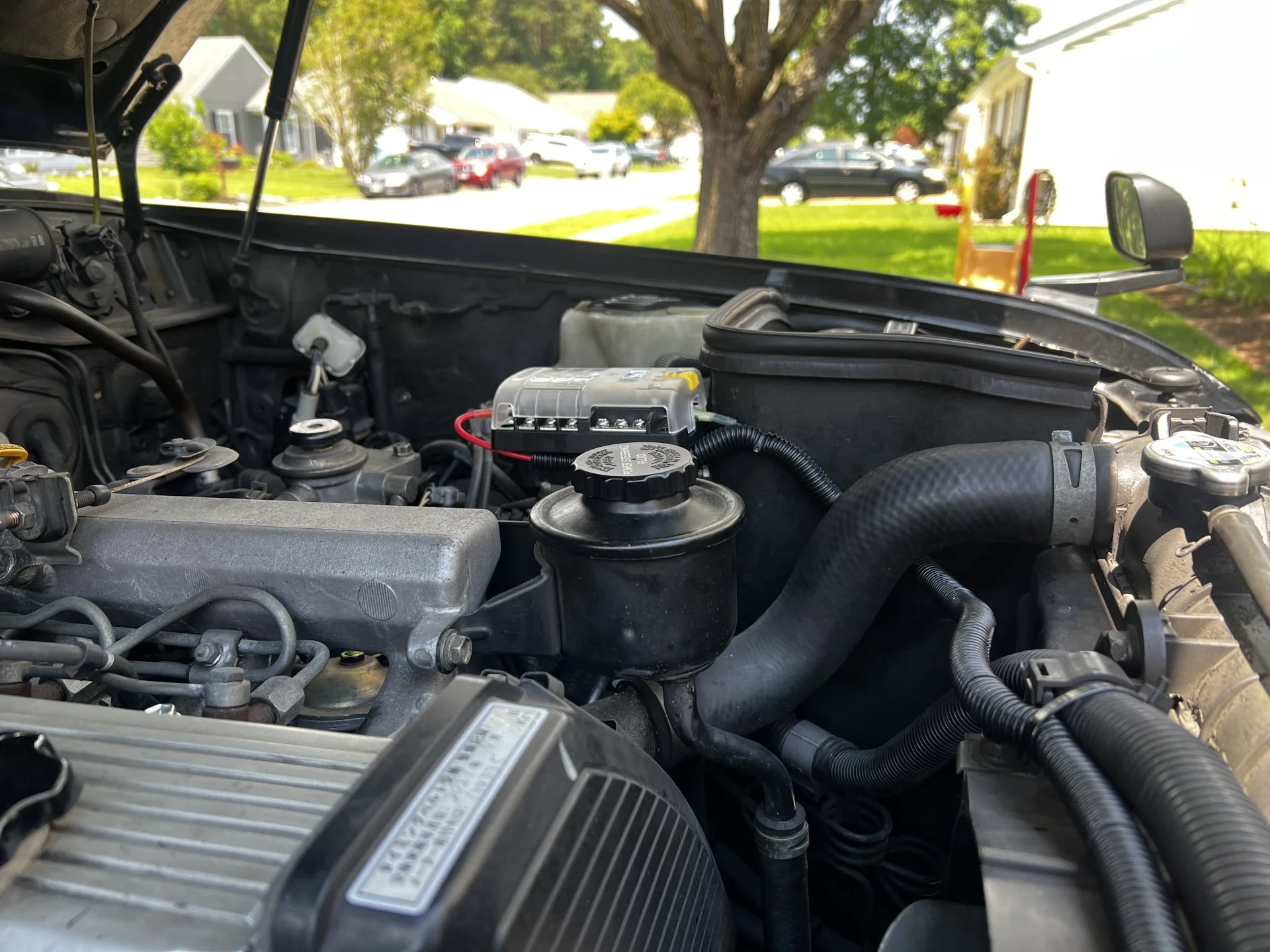

All back together, and up and running. Little bit of a rough start, but to be expected after 6 weeks of sitting. But we took it out for a ~150 mile drive, got it all smoothed out.
We’ll see over a few tanks how the fuel mileage has changed (if at all), but DFIS said several injectors were essentially stuck open dripping, and none had a good spray pattern. The butt dyno tells me power is significantly restored.
For those of you with a 1HD-T, this whole procedure is very simple, and I can’t recommend DFIS PDX enough. Highly suggest doing it if you have not.
