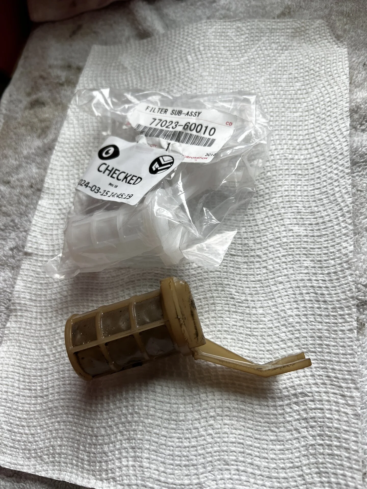

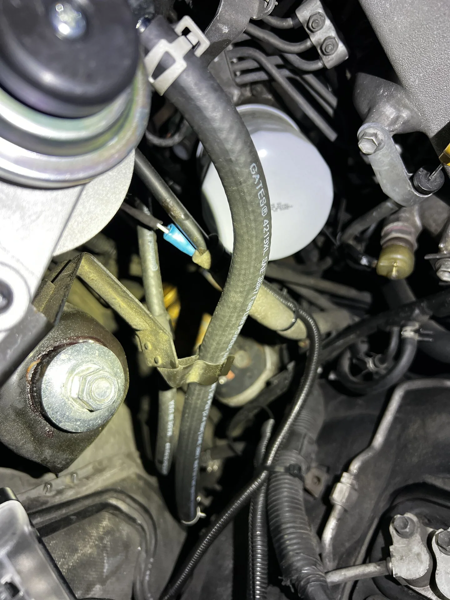

Have also been chasing poor fuel exonomy issues. Last long trip averaged 16.5 hwy, wich is worse than its typical 17-18 in town. Starting with easy first, replaced fuel filter & housing, replaced fuel lines all the way to the tank, . Will know more after some more driving.

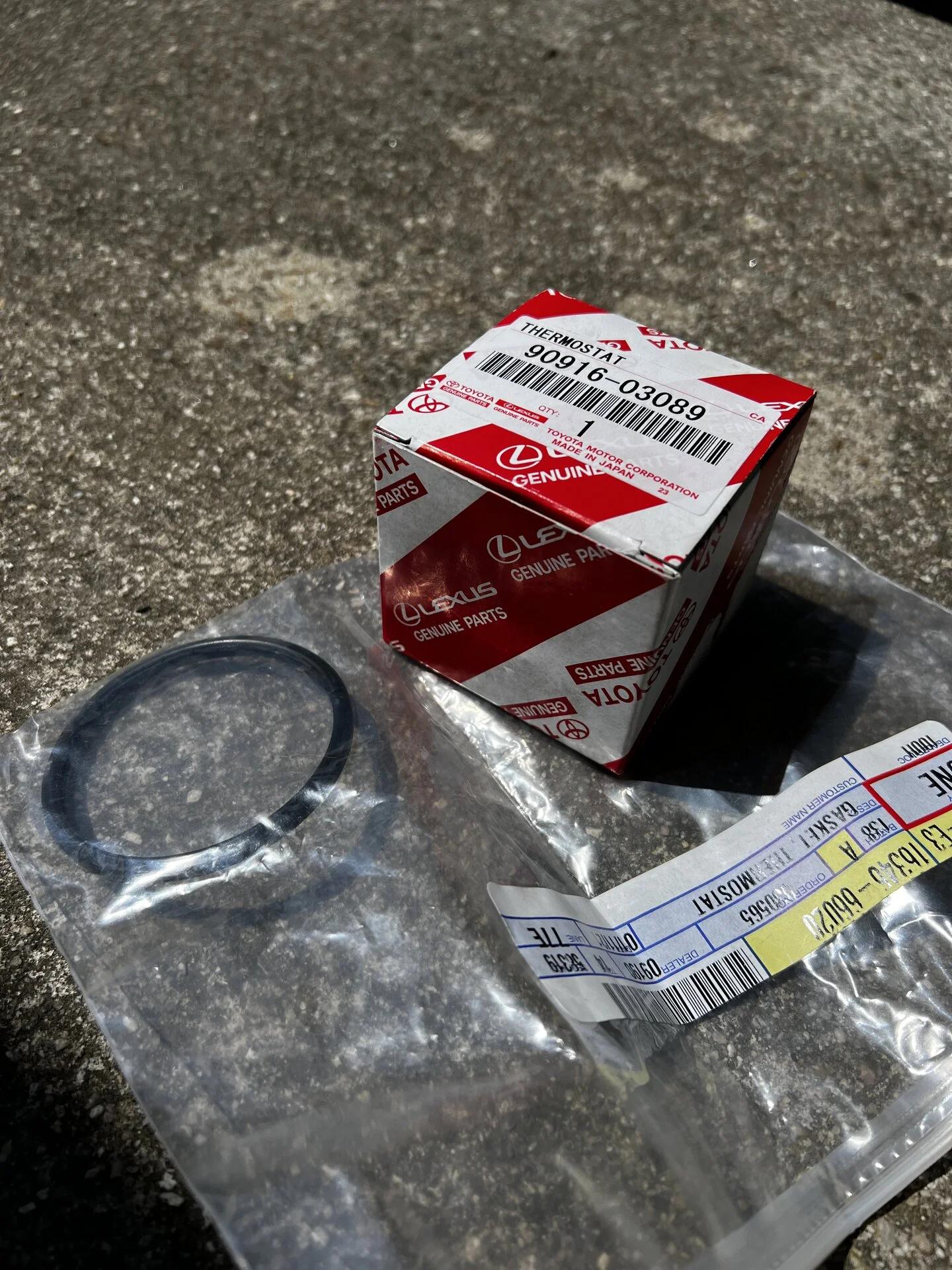

Turns out you CAN, very carefully, change the thermostat without pulling down the alternator.
It is not fun, and requires patience and soaking of the bolt to avoid stripping it. But it can be done, just need a 12 point offset wrench, which is why you have to be careful to not round it off. It’s only a 14 lb torque, so shouldn’t be toooooo bad.
Engine was only reaching 150 ish F no matter the conditions, so I’m thinking the thermostat was opening early or not closing. We’ll see.
Confirmed this WAS an issue. Temps climbed to 165 within 7 minutes on my morning commute, then stayed steady there the rest of the way. Previously it would reach the 140's at best on that short drive.
