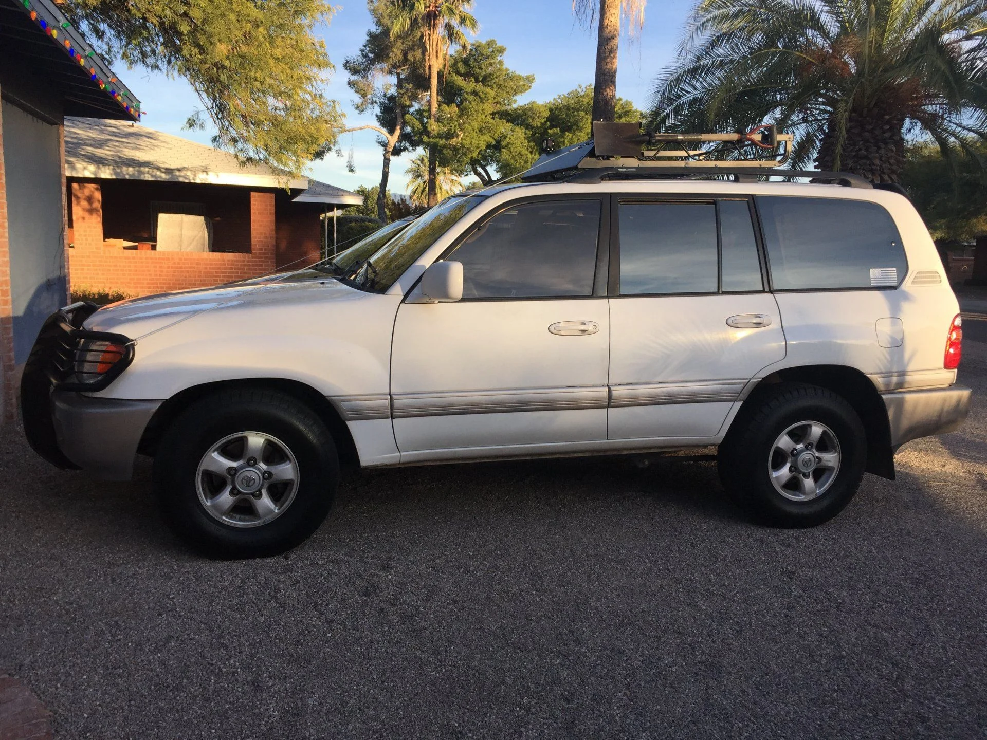

hey guys! im new here have always lerked the fourms and been in awe of your guys rigs!!! I drive a 1999 4.7l cruiser with 432,000 miles on it. below is a picture of my current rig. Im 16 and an aspiring overlander im an avid mountain biker and love a rig that can take me to remote places. What do you guys recommend I do to my rig? As you may know at my age money can be tight! Any suggestions help. Im just skeptical putting tons of money into my rig due to its mileage. I road frequently, everything on my rig is still factory minus the head unit tires and other obvious accesories.

Thanks guys! today I adjusted my T-bars to level the front with the bigger A/t tires. I currently own the original owners manuel. The capability of this bad boy is insane. Havent ran into any issues so far with what I need it to do.. This was my familys car we bought it with around 220k on it. Iirc we have put 3 alternators and a timing belt. Other than that she is sound. There is a slight leak in A/C hose but i will take care of that this winter. Im looking to put a 40 inch light bar on my rack this christmas! Fluids are all replaced when needed as most issues are taken care of when they arise. Im pretty handy as im a moutain bike mechanic building and servicing bikes

Thanks for the kind words!! Ive been driving this rig for about a year now. She has been on multiple wheelings trips when I was younger. Since ive been the owner ive taken it down to reddington pass and down the back side of mt lemmon multiple times to oracle. Im familiar with the lockers, what they do and when to and not to use them. My steering is a little wonky just replaced the fluid and seems to be back to normal. Alternator was replaced at about 350k. Yes, I have acess to hydrolic jacks and just about every tool i need. I am pretty mechanically smart as i said I buy sell build and referbish bikes. loosing the rack limb risers and brush guard were my next move that was in my " aesthetic" phase. I really want a new bumper with more clearance. My spare is aired up and ready to rock and roll. A good buddy lives in his garage building sand rails and fabing anything under the sun so hes happy to help me out. Only thing ive had a issue with was my radio going out while on a bumpy trail i just solved that with a newer single din radio with blue tooth. We are the second owners. Previous owner is a close family friend that worked at the yota dealership. I hope this helps!!!
See how it drives after cranking the t-bars. "Technically" you have changed the front-end alignment, and "should" get it aligned, depending on how far you cranked them. Then also know that the font is supposed to be close to an inch lower than the rear. Strange handling results from having the front and rear perfectly level, even though it looks better that way. The standard way to measure is from the center of the hub to the fender. This takes out variation in tires size/inflation etc. If you romp on the gas, and the truck pulls to the right, the front is too high and you'll have to lower it. Find the sweet spot, drive it around for a week, then go get an alignment. You'll save your tires that way.
