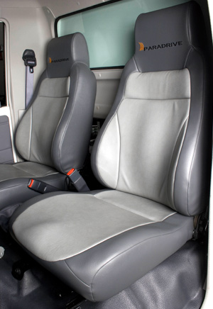

However if you want something really special that will bolt straight in ,you cant go past Paradrive Seats.These are specifically made for offroad use and sold through ARB outlets.
They fit these to landcruisers for emergency use such as ambulance and rescue.

I THINK this is a pic of them installed into a 79 series
I dont believe they are direct bolt in. Recaro makes, or at least used to make brackets for the 75/78 series, depends on where you are whether vendors will/can get them. I don't know if the 75/78 bracketry will work with the 79 though. As Roscoe said, their online support blows, you need to contact Recaro directly to get what you need.
