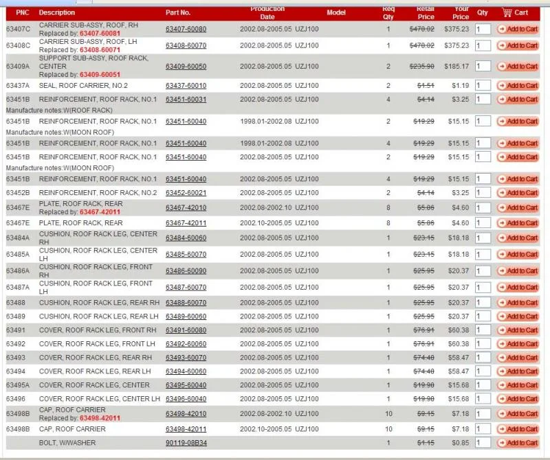

OTOH, I just checked at toyotapartszone.com (which I didn't know about back then), and they list the rack parts for a 2003 Land Cruiser. Not sure about availability - you'd have to call. BTW, they've changed their procedures for accessing the diagrams, I guess Toyota must've gotten to them. You have to click the little "Get Info" button and follow a few more links, and may have to be a registered member to access them?- but they're still there. I got sticker shock, though... :eek:

Just going through the same thing. I had a branch come down on mine (PS front). The best I could find was $58.00.
Link is for part references only, not the price.
Part #: 63491-60080
It's called Roof Rack Leg or Leg Cover on many Toyota Parts sites but I'll be damned if I'm going to pay $60.00 for a piece of plastic, OEM or not.

Found this thread. I need the rear passenger side one. I think it's part 63493-60070 any ventures have better prices on this stuff? $70 for a little plastic piece is rough.
