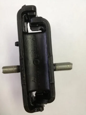

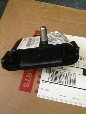

Finally received the motor mount!
I only ordered the DS cause after sleeping on it, I forgot to call and order the PS. This sucker is 4" from end of thread studs. I'm not sure I have 4" clearance without removing exhaust, fan shroud, the PS motor mount, etc.
Here is what I would like feedback on. What about removing the alternator for easy access, remove bottom motor mount nut, then removing 3 bolts to arm attached to engine that is also attached to motor mount. All while supporting engine with board and floor jack. Lift motor mount straight up and then reassembly. Easy peasy. What is the flaw in my thinking here?

What i do is about what you say. Loosen the top and bottom nuts on the mount, then pull up on the engine slightly to get the weight off of it . Then from there unbolt the mount off of the engine itself and that will give you all sorts of room. On top of it just get the stuff out of the way to make it easier or go from the bottom to slide it all out / in.
