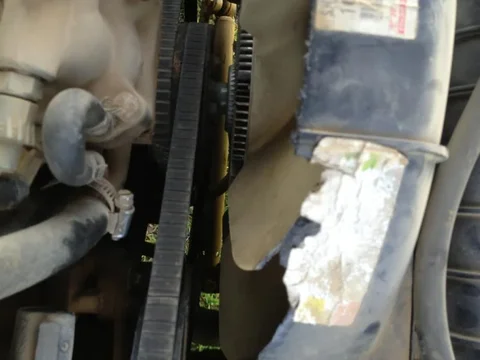

My fan is hitting the top passenger side of the fan shroud, so before I attempt to fix I would like some advice.

The only time I have problems with it hitting the shroud is on the trails and the truck is flexing; usually on Daniel. I would like to fix before Logan's Run so any advice/help would be appreciated. You guys know I'm a jack leg mechanic but I do have all the tools needed to fix this problem. I searched mud and read a 2x4 and a bottle jack would pick the engine up to make the replacement possible. I have that! :doh:

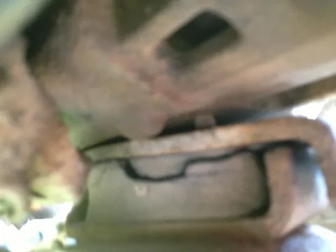

Pic of PS motor mount

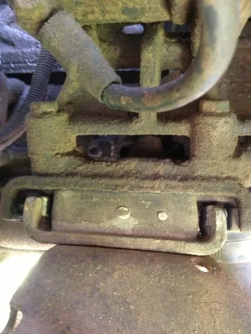

Pic of DS. Harder to get a good pic
It appears the breather tube is wedged in the mount
Sent from my iPhone using IH8MUD
Your DS is shot ... it is the one that normally goes first and that's a pretty darn big crack running through the rubber.

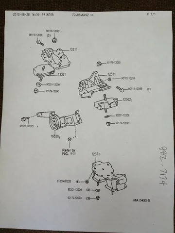

I'm talking with Jeff @ SCT and he faxed me this pic cause his book just says for right hand. ? Almost like both sides are the same mount.
Thoughts?
I'm thinking I need part # 12362. Tell me I'm right!

that looks to be right.
Your drivers side is Left Hand side of the truck though since you have a Left Hand Drive Vehicle.
That shows both DS and PS mounts the one you are looking at appears to be your drivers side mount.
